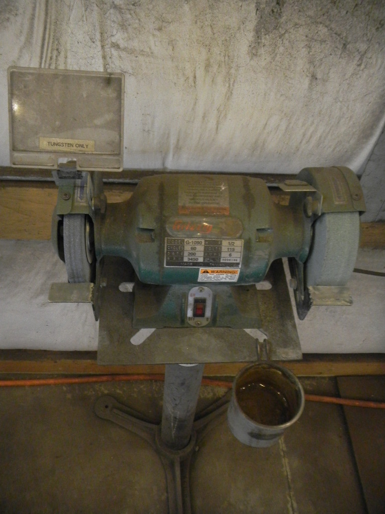

The drill doctor i have ( i can't recall the model number ) can be used to make split point bits out of regular bits. And i would have to agree that split point bits cut better. When i get a chance im gonna watch that video on hand sharpening, mine only does up to 3/4 inch. I'll have to invest in a new bench grinder, mine is not very good.
/ Which Drill Bit for Steel #37
I bought a wider wheel for my bench grinder to do bigger bits.
