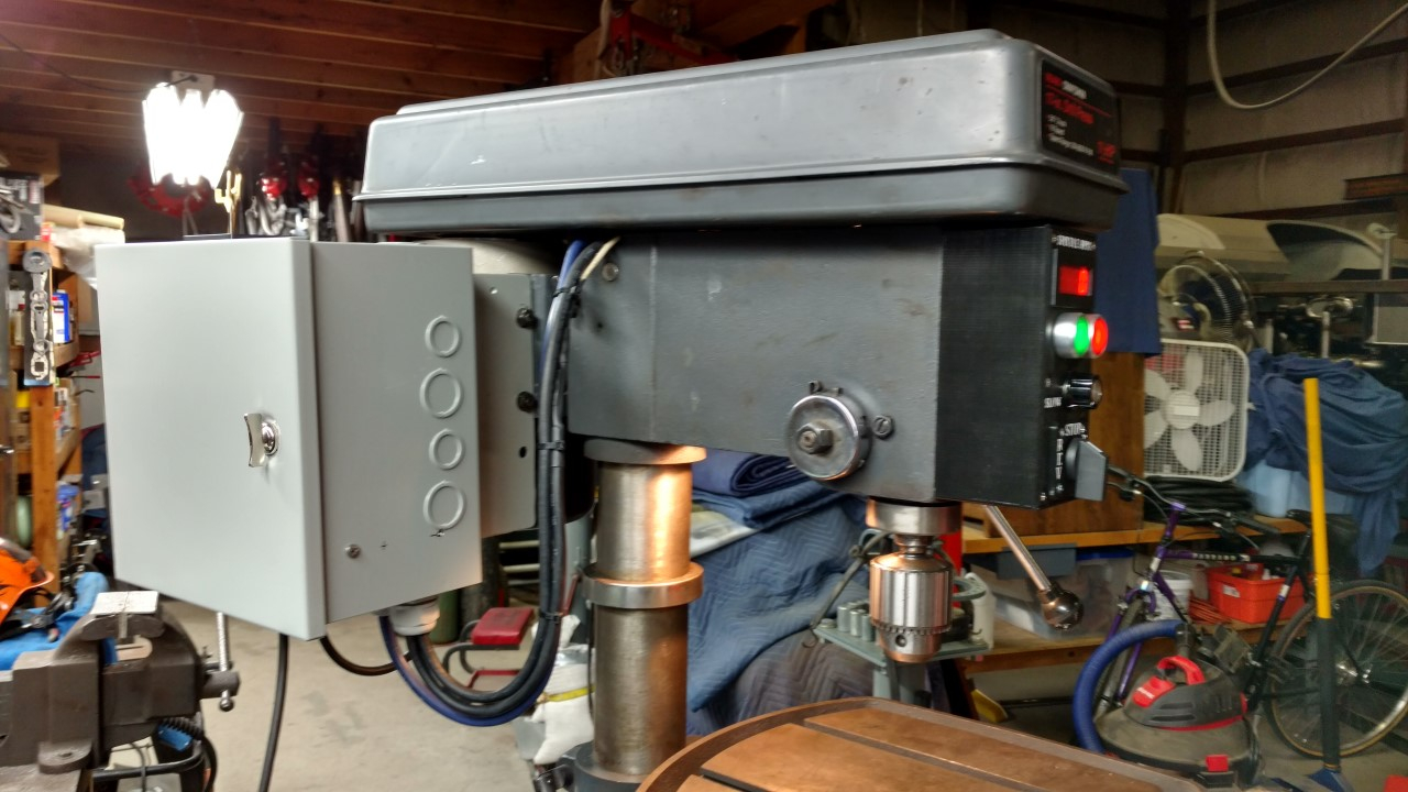

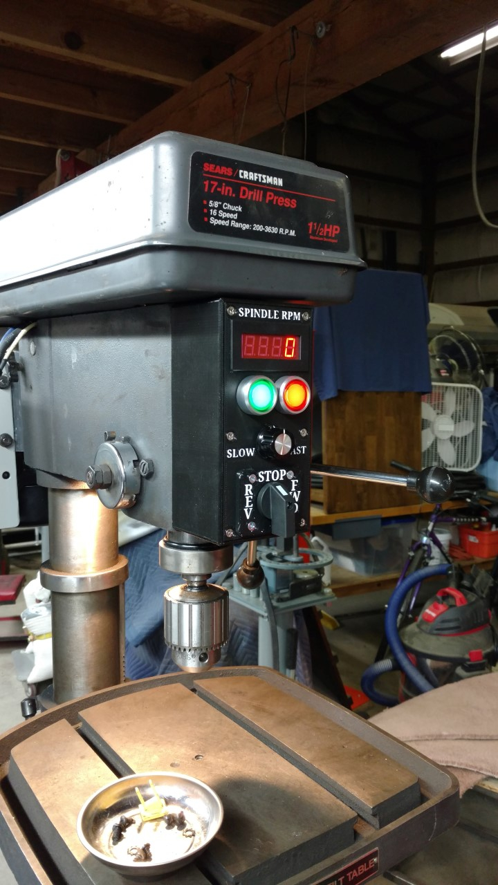

One thing for me that has made drilling easier on drill bits was when I converted my old Craftsman drill to a variable speed setup with a 3 phase motor and VFD. I mounted a magnet on the spindle pulley and have a digital tach display, and can vary the speed from ~50 rpm to ~3500 rpm. Now I can set the speed to whatever the job requires.
