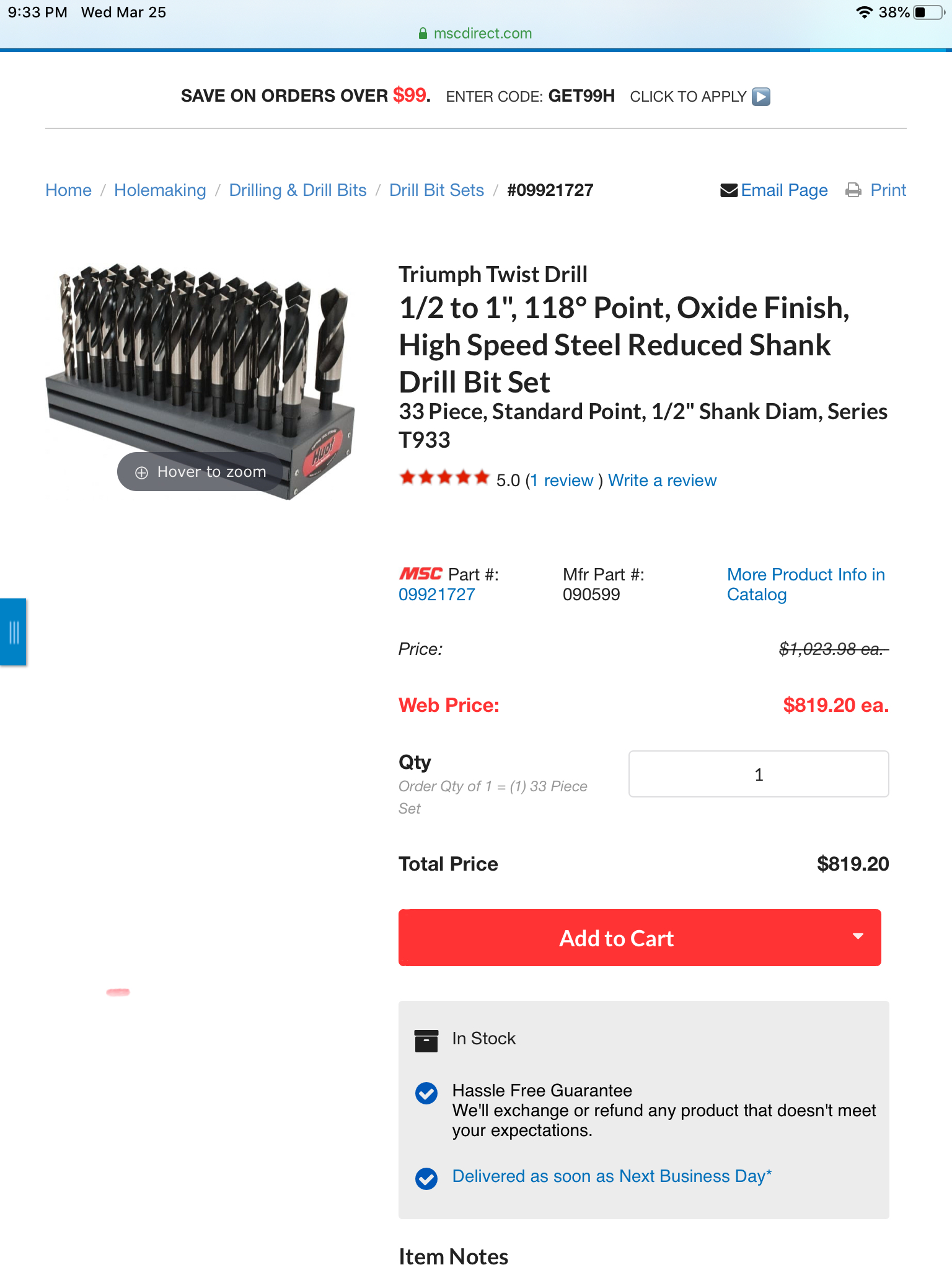

Just for interest this is what came up for me on Google.
Definitely not HF price range.

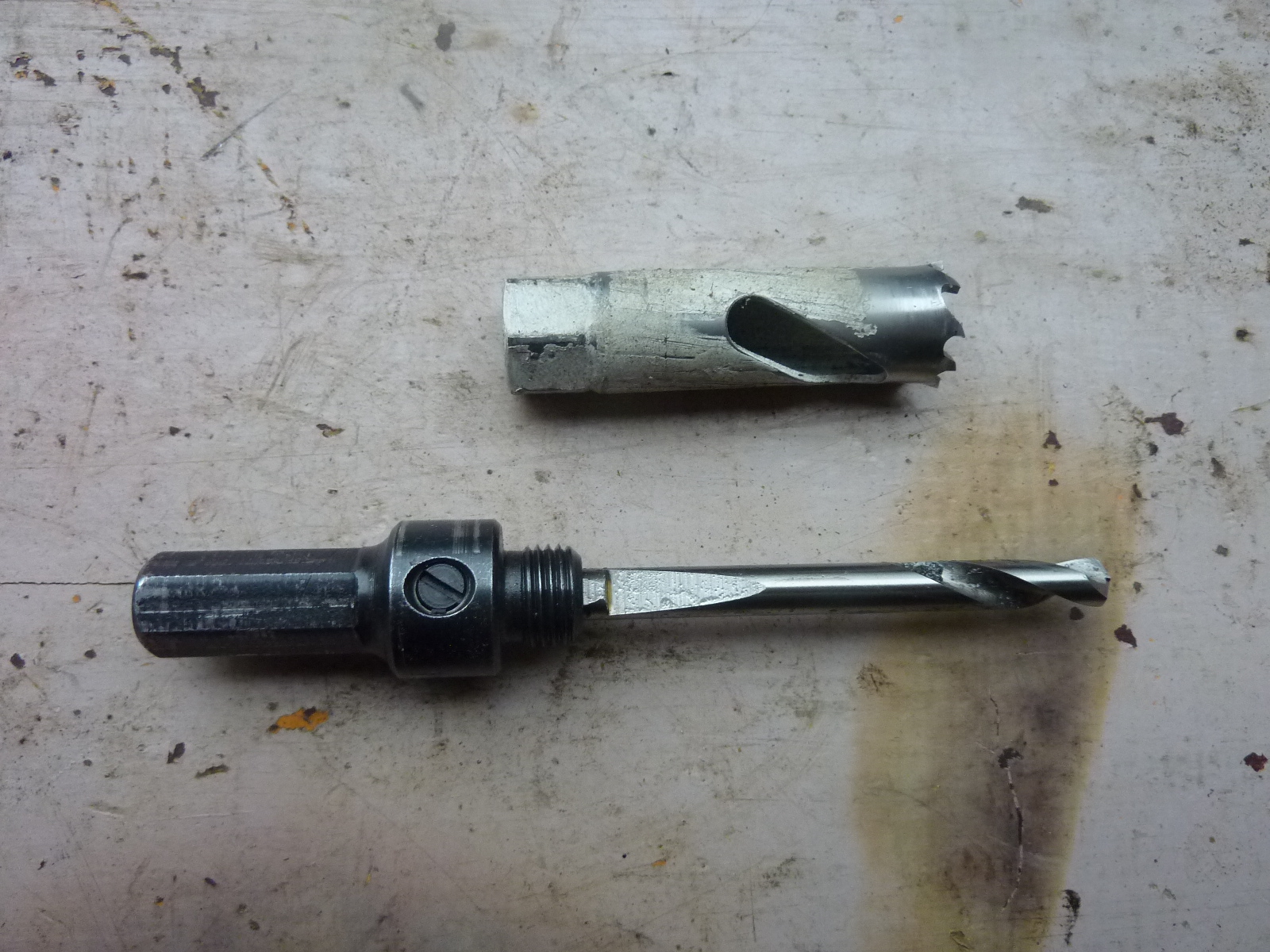

Somebody above mentioned Champion hole cutters. You should give that a careful look. They are not just "hole saws". I use them too. They are excellent for what you seem to want to do. Accurately sized round holes with your drill press or hand held if need be.
CT7 5 Piece General Maintenance Hole Cutter Set
I’ve never tried one but I see they are available individually also on eBay and reasonably priced.
I also use hole saws in the drill press. Often much easier than drill bits. Mine have a 1/4 pilot bit in the center so I predrill a 1/4 hole location hole. The hole cutters will cut good until the kerf gets loaded with chips then it will feel like it has suddenly gone dull. Just stop and blow out the chips with the air hose or use a pick to clean them out then go again. A lot of complaints about hole saws are because people don't realize that you have to do this.
Milwaukee and Champion both make these.
