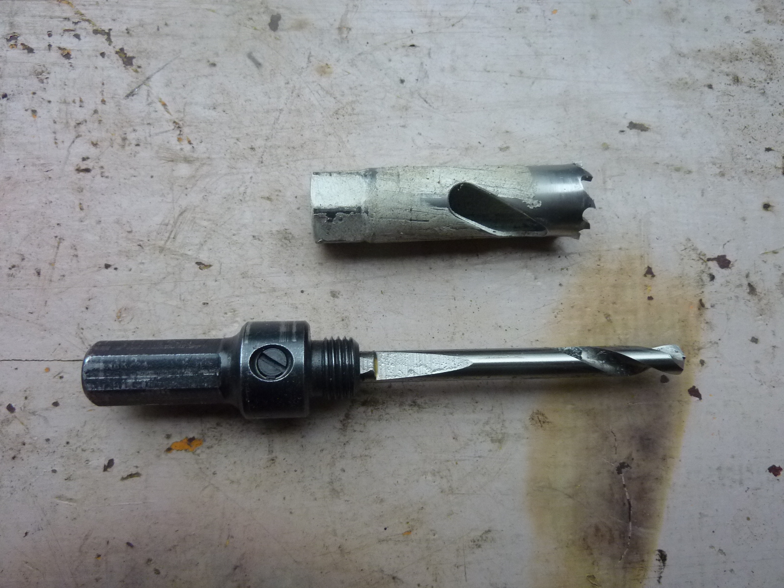

Somebody above mentioned Champion hole cutters. You should give that a careful look. They are not just "hole saws". I use them too. They are excellent for what you seem to want to do. Accurately sized round holes with your drill press or hand held if need be.
CT7 5 Piece General Maintenance Hole Cutter Set
Thanks. That link didn't work for me but I found them on Amazon and eBay. They look good but expensive. Will keep them in mind.

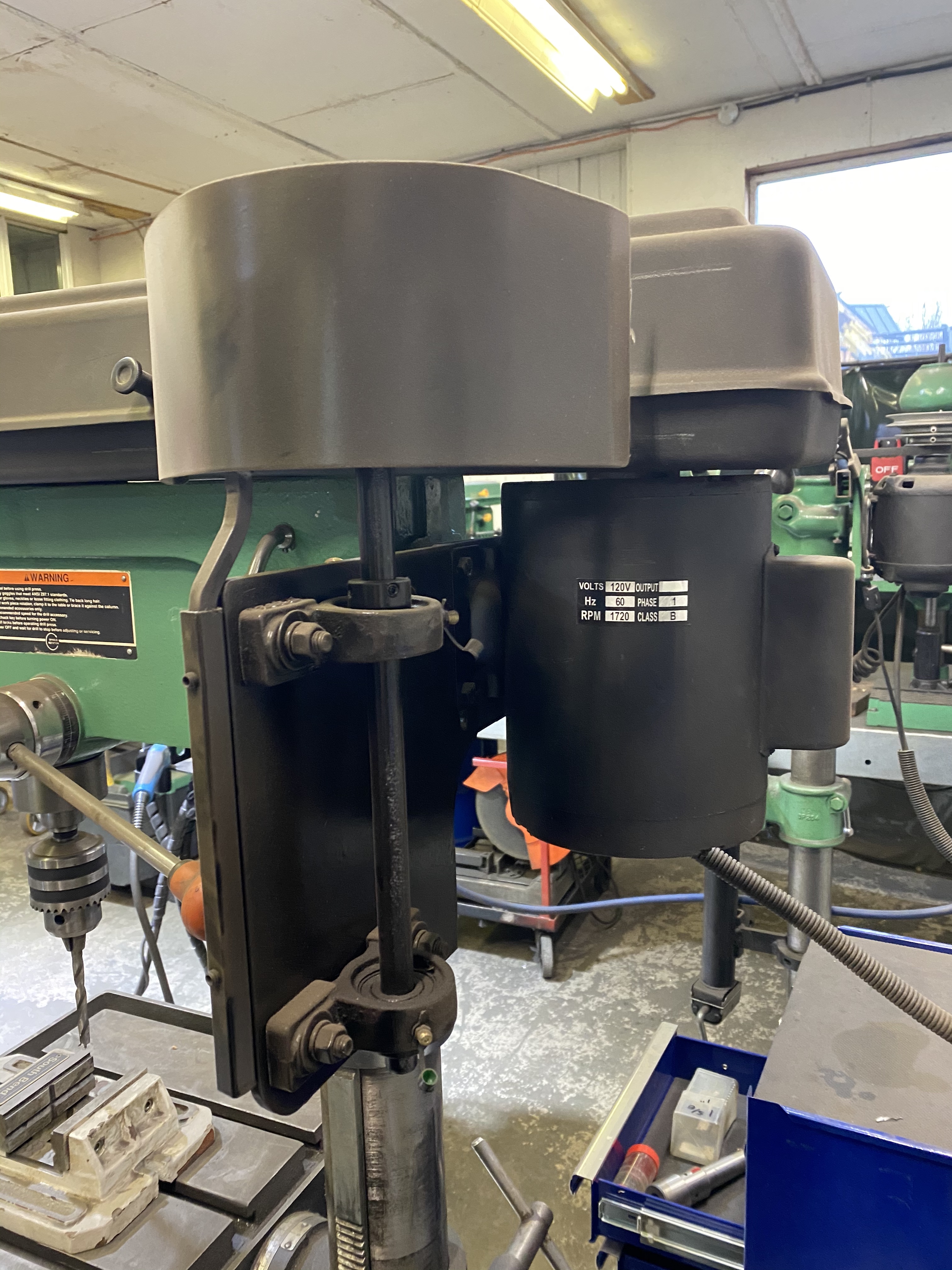

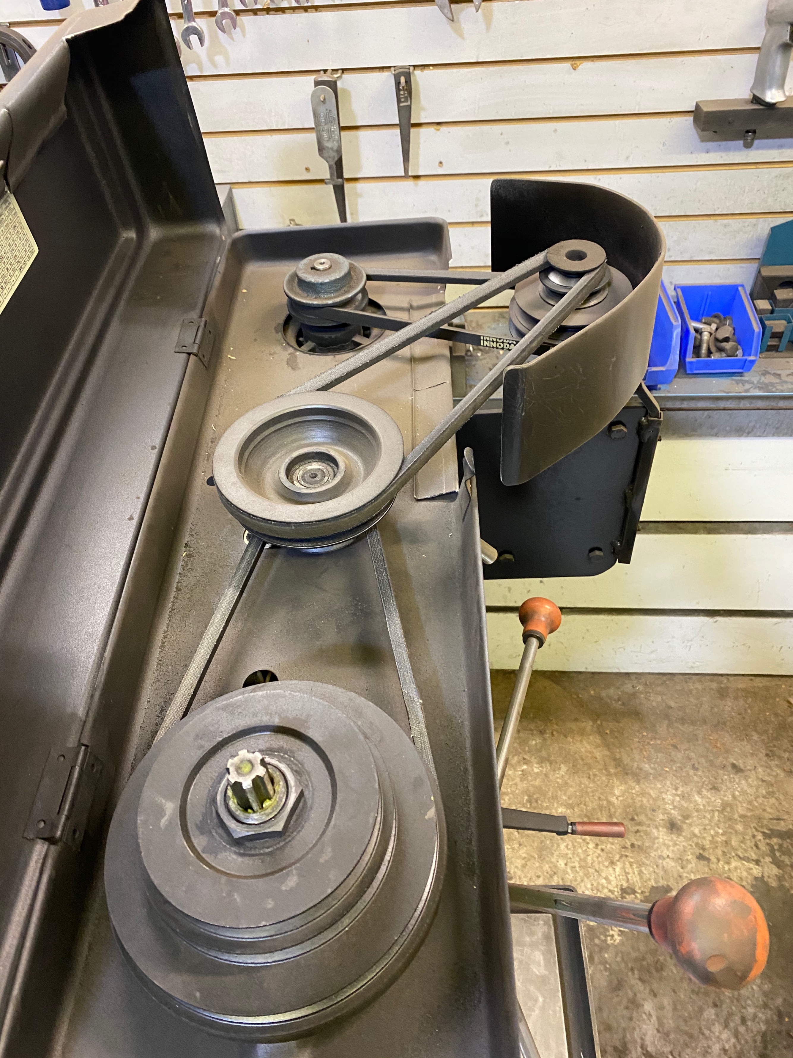

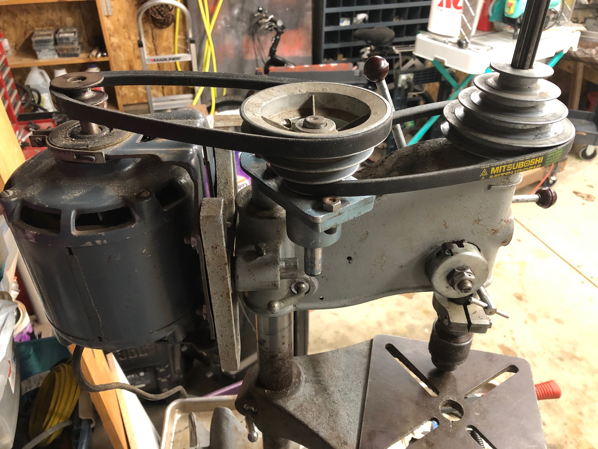

Someone added a jackshaft to this 70 year old 1/2" Duro press. Makes the chuck speed 300 rpm. I've used it to drill 1" holes with a Champion hole cutter. Slower would be better.

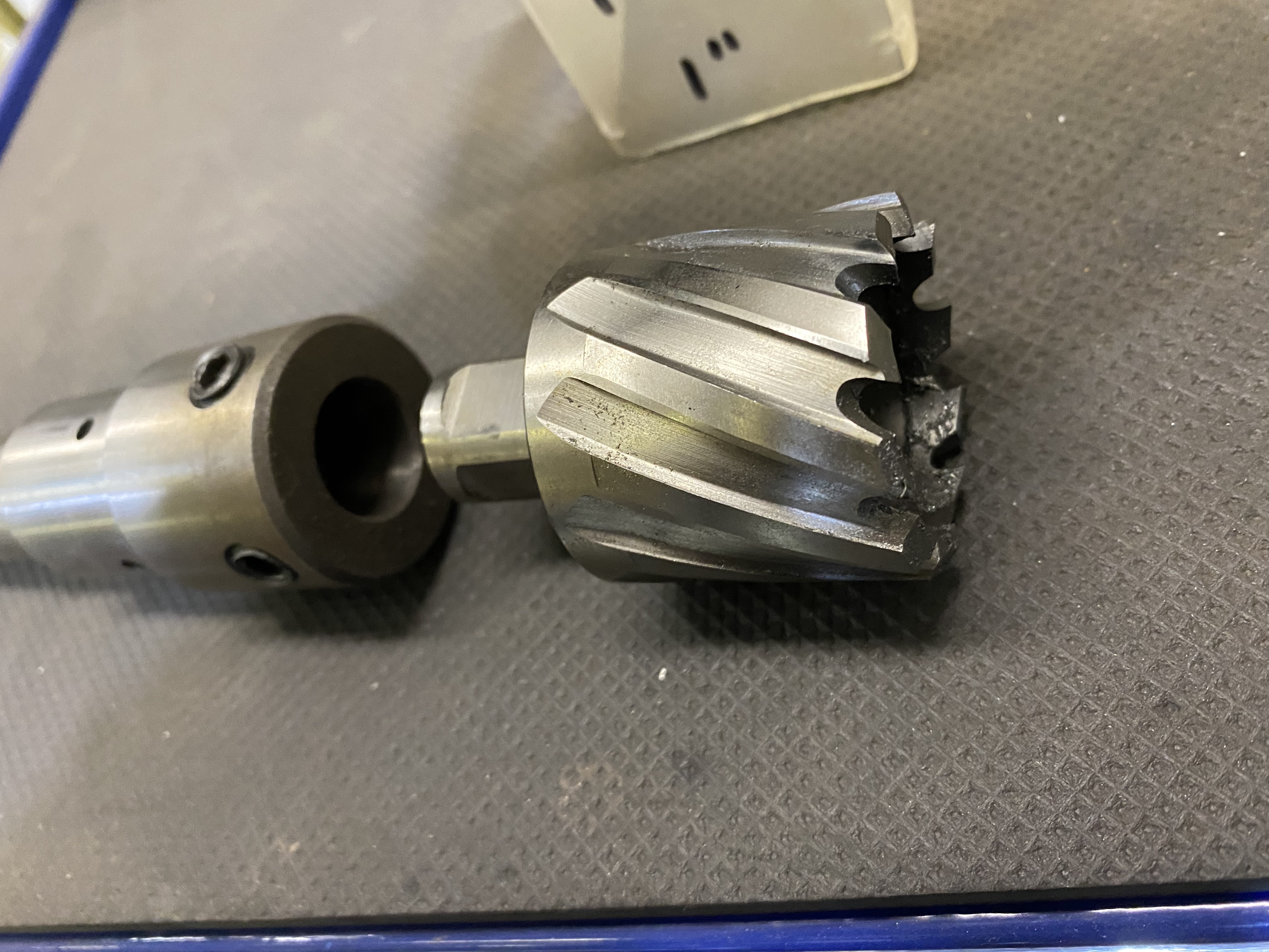

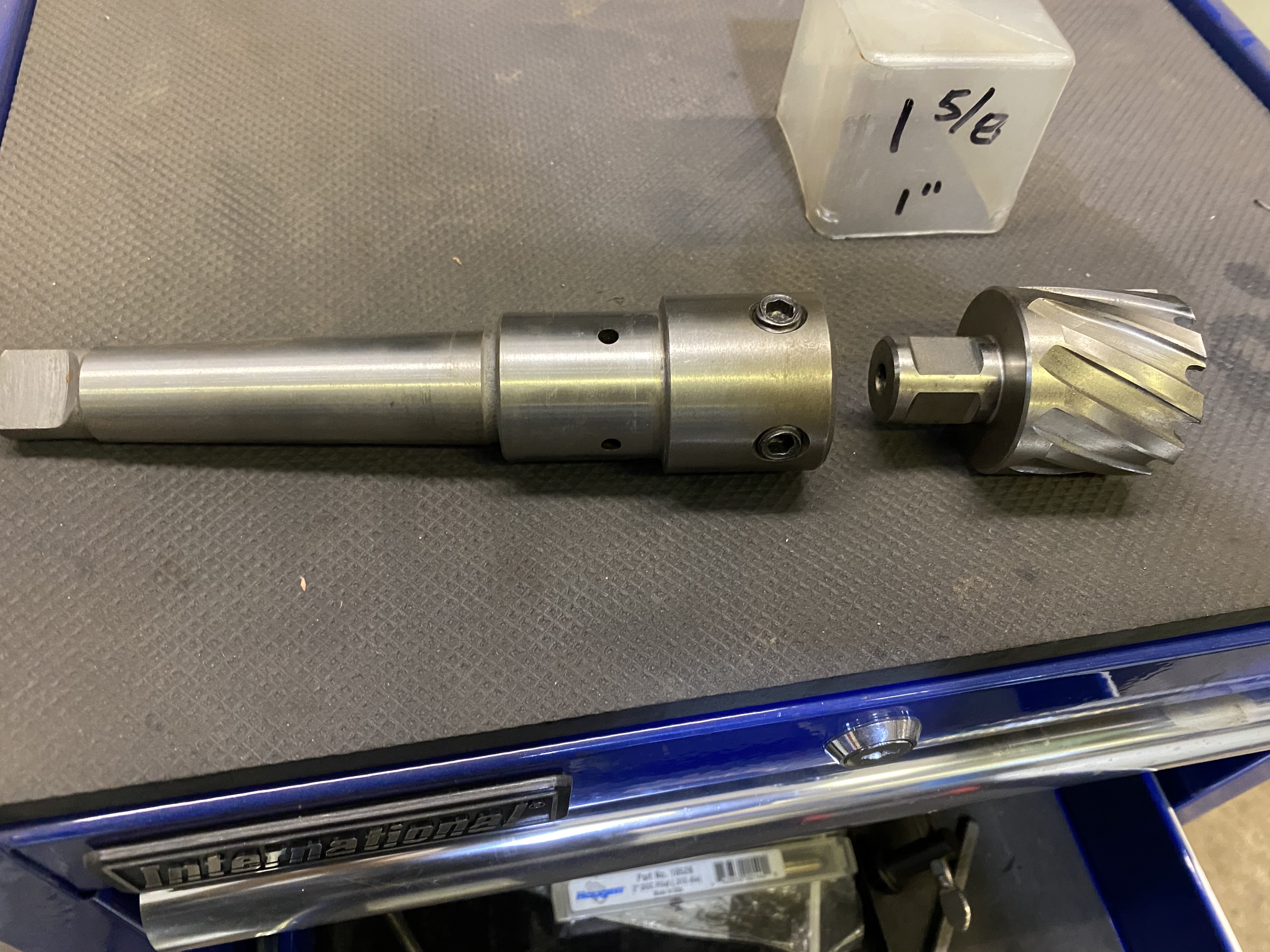

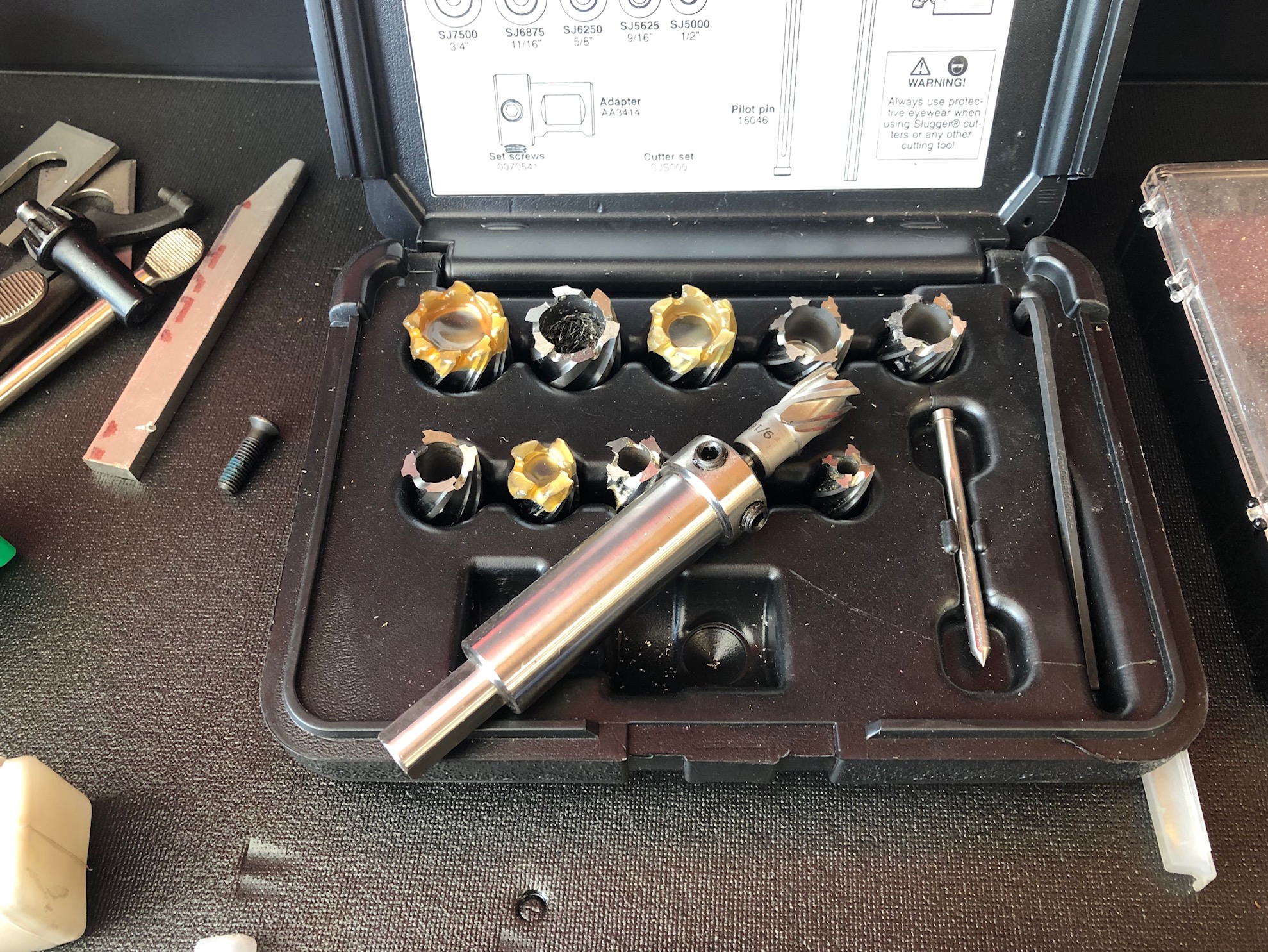

I also use this Jancy annular cutter set with a Jancy drill press adapter. 1/2" to 1-1/16". Works good but your drill press quill needs to be tight.

How does that adapter work? At first I thought it was something you put in your drill press chuck that would allow you to insert a weldon shank but after looking closer that doesn't seem to be the case. The shaft is tapered and has a square end. Do you have to remove the standard chuck from the press and swap to this? How hard is that?
Rob
Rob. You will first need to know the spindle taper on your DP. And then find an adapter to match.
And yes the standard chuck is replaced.
The DP in my previous photo with my homemade reduction has a low speed of 300 RPM iirc. I have a cheap digital tachometer to check machine rpms. eBay. Numerous. Cheap. Free shipping.
This is an option, but personally I don’t think it is the best one for you based on info gleaned from your posts.

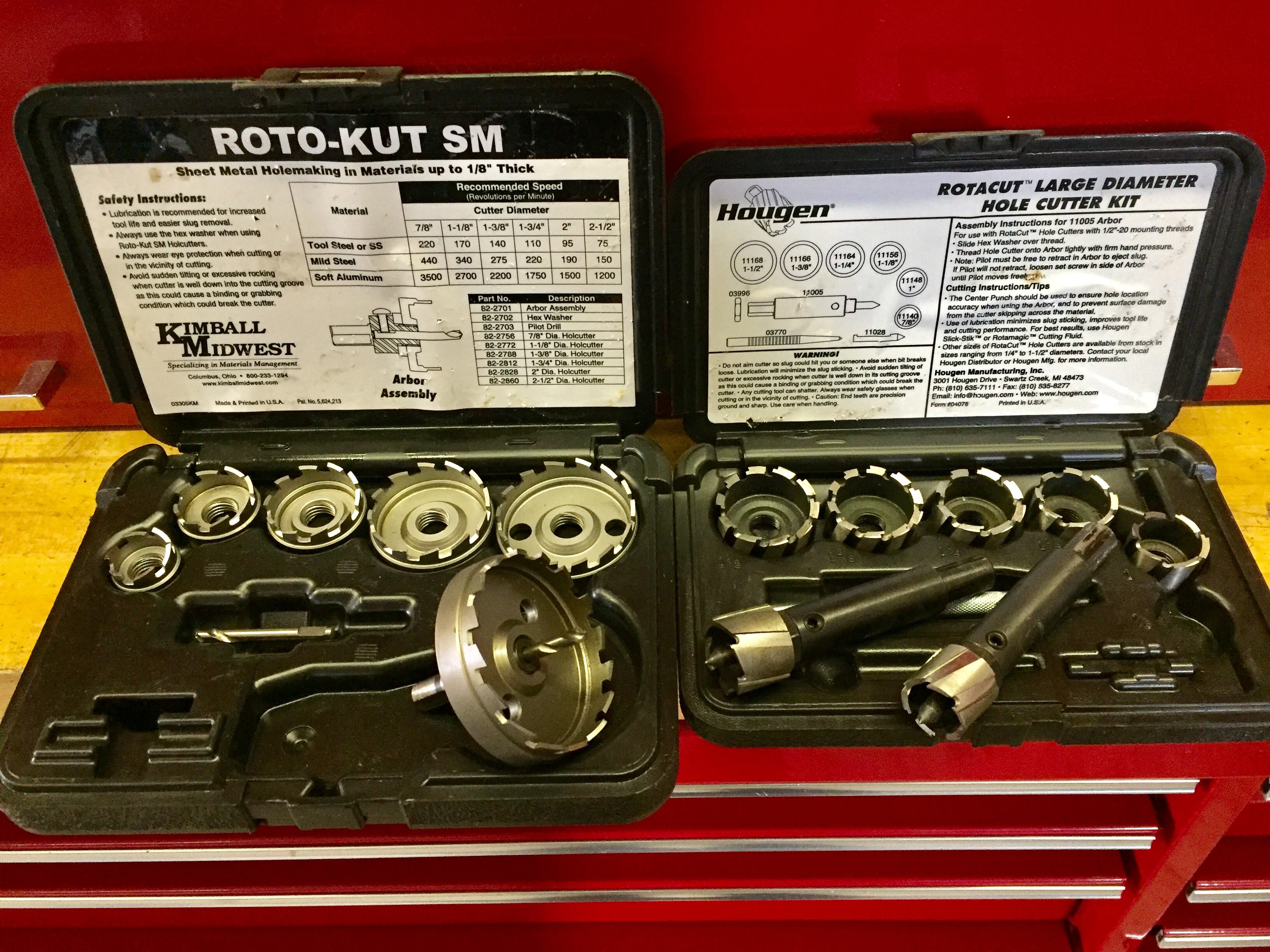

I think your best bet is to get the Champion hole cutter in the size you want. Because it has a pilot bit, it will not wander in a drill press. And like DE says it removes less metal that a equivalent twist drill so can be done with a garden variety drill press rather than a big industrial setup. Buying one at a time does not hurt too much.
