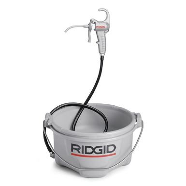

I use one of these rigid oilers on mine. Makes bits last long time. But i also use a drill doctor to clean up my bits after use.only thing i dont like with these oilers…kind of messy.
also, what angle are the bits. 118° work better on wood, can cut steel but dull quicker. 135° better on steel.
