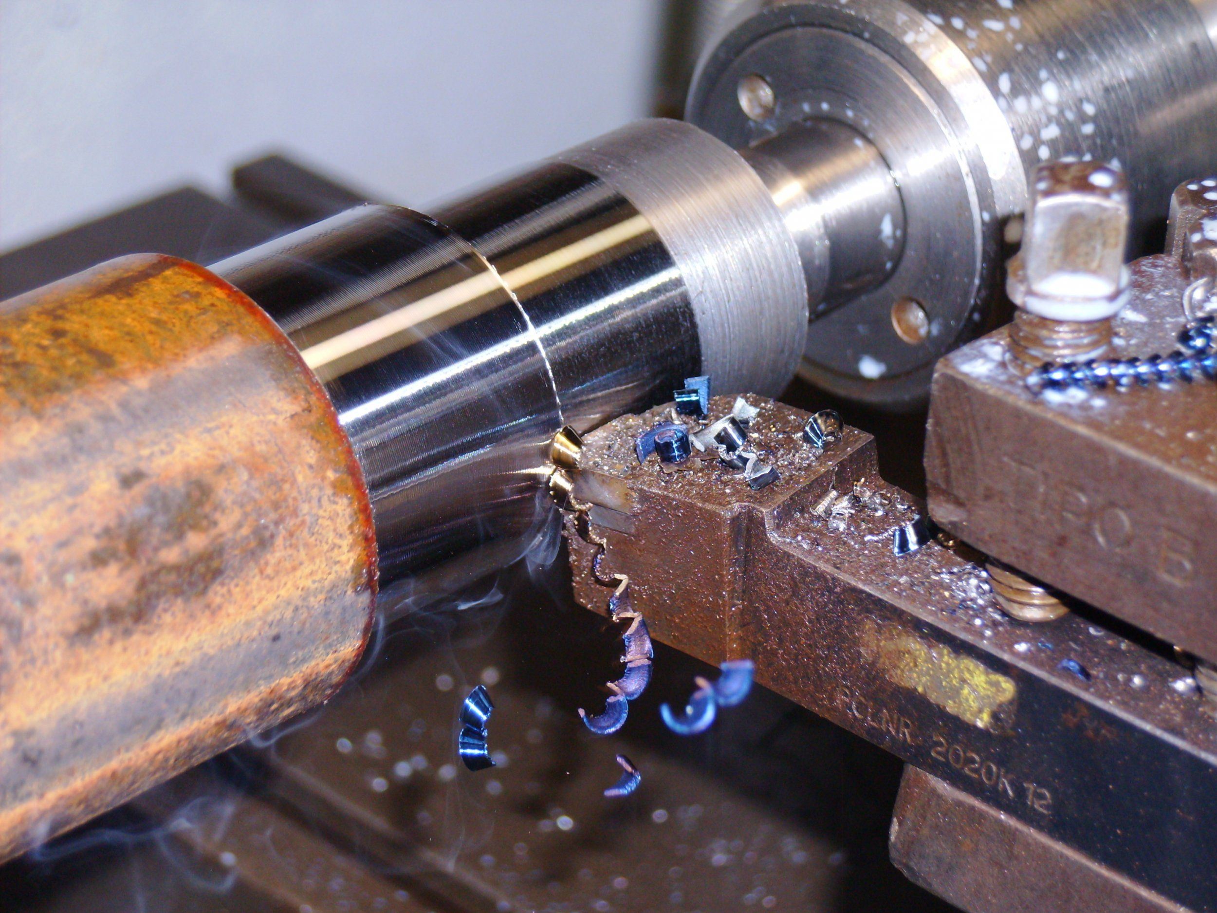

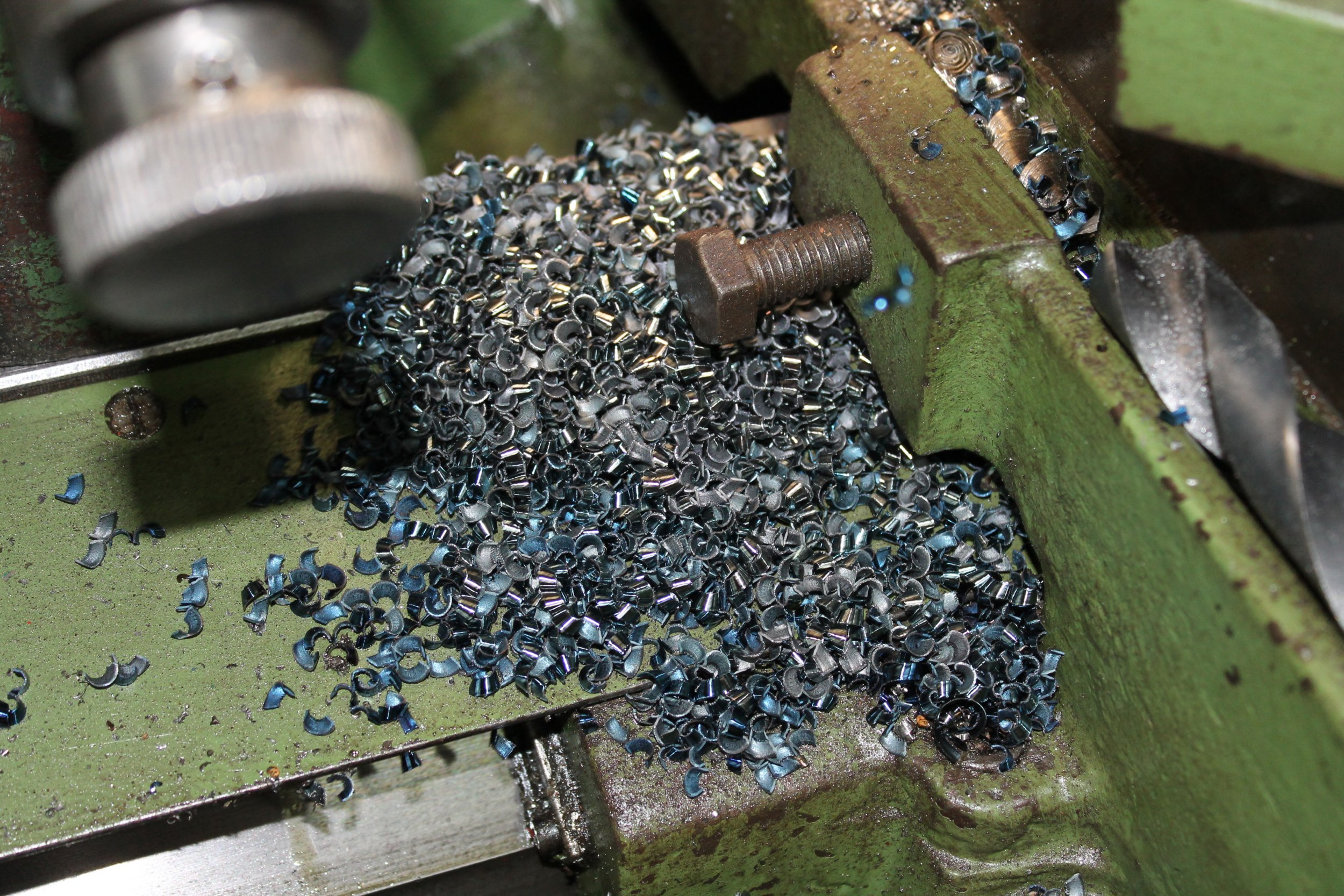

read the chips, feed it too light for the speed = chips turn blue, too hot
don't let the chips turn colors more than a light straw on HSS

Blue chips are bad unless using carbide cutting tools

don't want to ever see long, stringy chips
disagree about never wanting a long stringy chip, indicates good and consistent feed pressure
