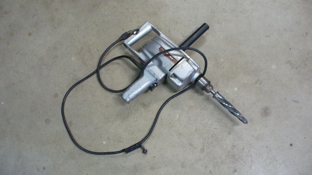

I have a drill similar to the one pictured in the previous post with the 'buddy' handles, it's a Makita corded one and I almost got my arms broken when the drill grabbed in the bottom of a hole, not pleasant and I had sore arms for a couple days. I can eliminate that with the mag drill entirely and drilling with large diameter silver and demming twist drills (holes over 1/2" is a very tiresome deal anyway because with a twist drill even a sharp one, you must remove ALL the metal in the hole which takes a long time and a lot of manual effort), whereas, using an annular cutter, you only remove the outer 1/8" or so of material and the pin inside the cutter pushes the 'slug' out, why they are called 'slugger' cutters. Much easier to deal with when drilling large diameter holes by a long shot. d
