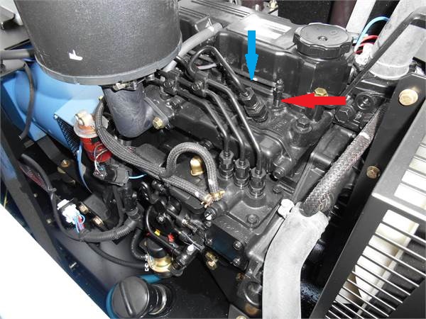

Nov 12, 2015 / Where is/are the glow plug(s)? #1 M mrmr85 New member Joined Jul 19, 2013 Messages 2 Location Watertown, CT Tractor TYM T293 HST I've had three different men look for the glow plug. We are all certain it is not working. It's somewhere on a Mitsubishi S3L2 engine. Please give exact location (pictures too if possible).

Nov 12, 2015 / Where is/are the glow plug(s)? #2 joeyd Veteran Member Joined Jul 22, 2010 Messages 1,019 Location North Idaho Tractor TYM 353HST I found a diagram at this link, www.sdps.com.au/images/products/drawings/S3L2-65SAG-EP.pdf, http://www.sdps.com.au/images/products/drawings/S3L2-65SAG-EP.pdf It looks as if they are on top of the block on the right side, good luck.

Nov 12, 2015 / Where is/are the glow plug(s)? #3 T tcartwri Elite Member Joined Mar 28, 2010 Messages 2,610 Location Ontario Tractor CT235 Glow plug >> Red Bus Bar >> Blue
