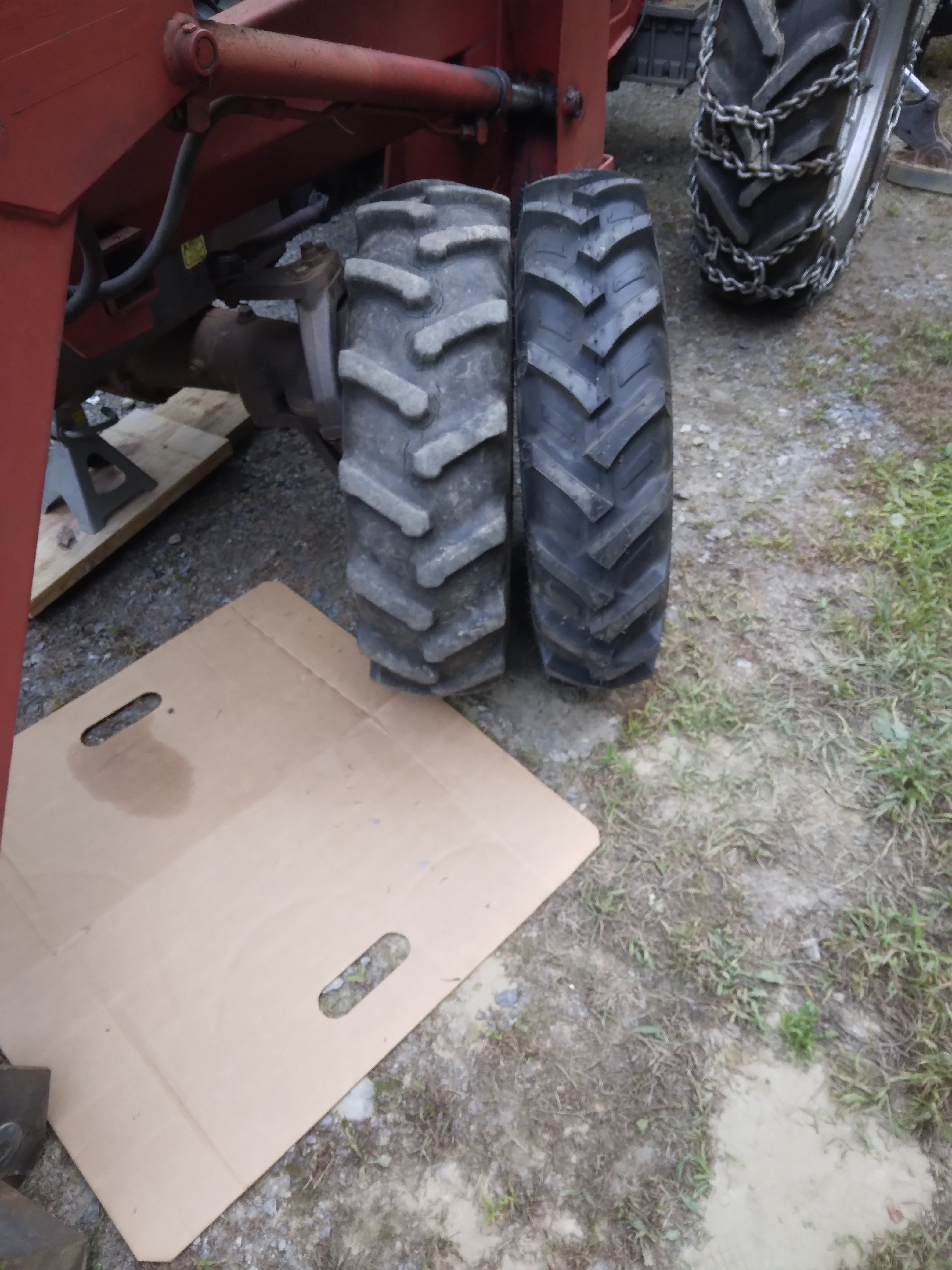

Not crazy about my last carlisle purchase. They changed their tires but call them the same thing. And many sellers are using the old product image so you don't get what you see. Here are my old vs new tires.
Both Carlisle farm specialist r1s. Both 8-16s. Both fully inflated. What gives?
Are you sure they are Carlisle and not Carlstar?
Carlisle Branded Tires Are Now Carlstar
And does it widen out when mounted and weight put on it?

Yep they changed the bar angle, when it gets mounted on a rim it will not look as much narrower as it does just sitting next to the older tire.
I see the difference in the bar angle but the width sure does look different to me.
   / Where do you buy tires? What brands to avoid. #104
That pic is mounted and aired up. It says CARLISLE on the tire, although I bought them right before they changed to carlstar. Says Made in India. so i looked it up on the Carlisle website. Same model, Same listed Size, Different Sku #. The tire is more narrow, But is listed with a slightly higher load rating (160 lb more). And higher max inflation. (42 vs 28). I think i only put around 30 in them so ill put more in being a narrow tire.

I dont think you can even get the old style anymore. What ticks me off is there is no depiction of the new tire on the site. They still picture the old style! Not what you get.
   / Where do you buy tires? What brands to avoid. #106
They may well be closer to each other in size after some use. Tires do stretch and change shape slightly under pressure and torque. When I replace ine tire the size specs drive my purchase more than brand.

The older tires did dry rott well before the tread had significant wear. Hopefully these last longer. I do like that they have a higher load rating. They are listed as 8 ply vs 6 ply for the older ones. For whatever that's worth.

I don't know how they can get away with that, there is no way the section width or the tread width are the same between those two tires.
Section width is obviously way different between the two.
Also the aspect ratio cannot be the same either looking at the pic, (dividing a tire's height off of the rim by its width) Certainly looks like the new R1 has a much higher ratio and they likely did it by shorting on the section width of the carcass, or the section width of the old tire is more eight inches?
Measure section width on both tires 'bulge to bulge' of the side wall is either one 8 inches?
I need to replace both front R1's on my tractor soon and hoping they are not narrowed down either.
Already wish they were a bit wider than what was supplied new. Sure seems like these companies are fudging the numbers today, of course only in their favor as far as material costs.

Are they both mounted on the same size rim?

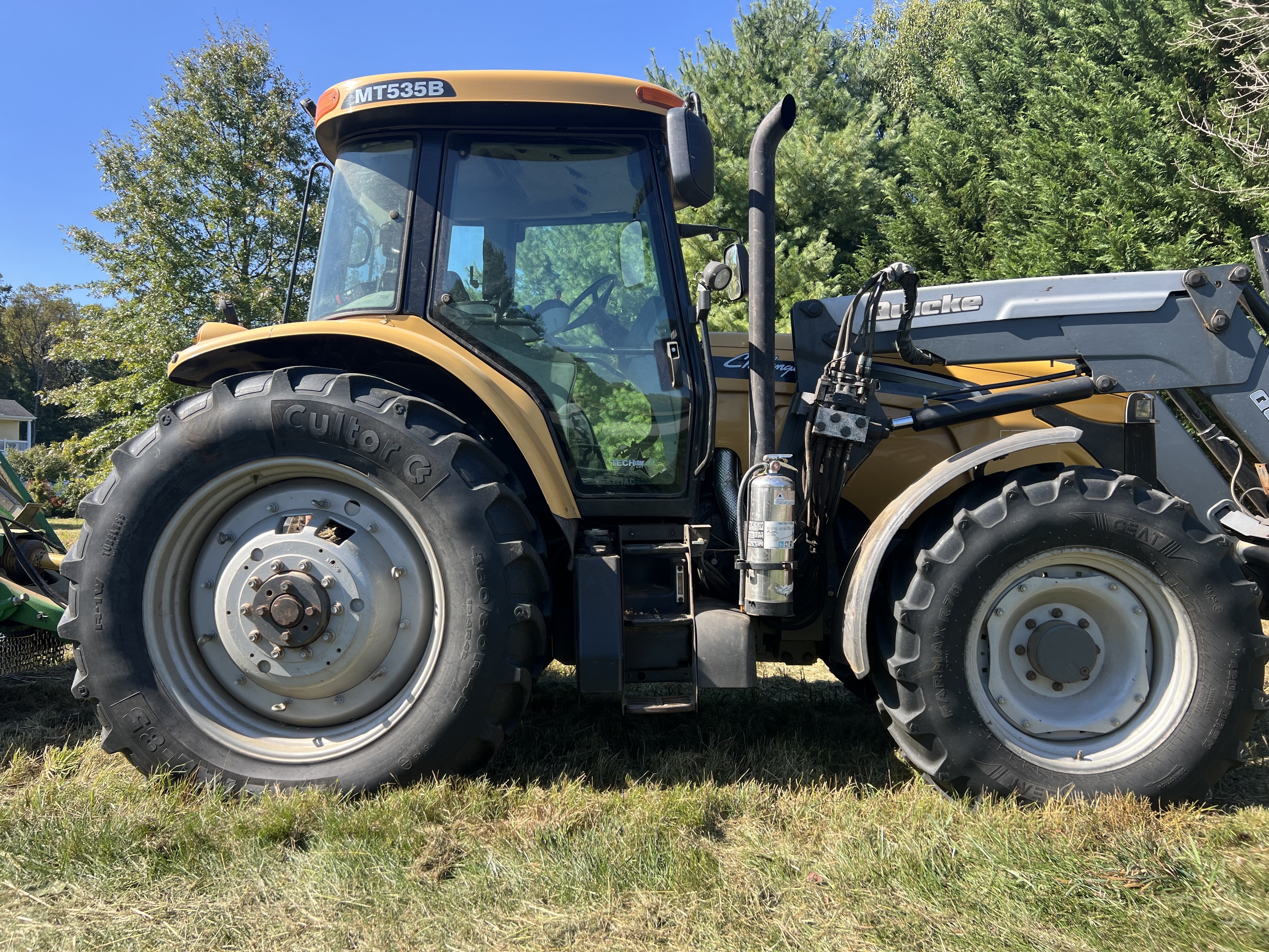

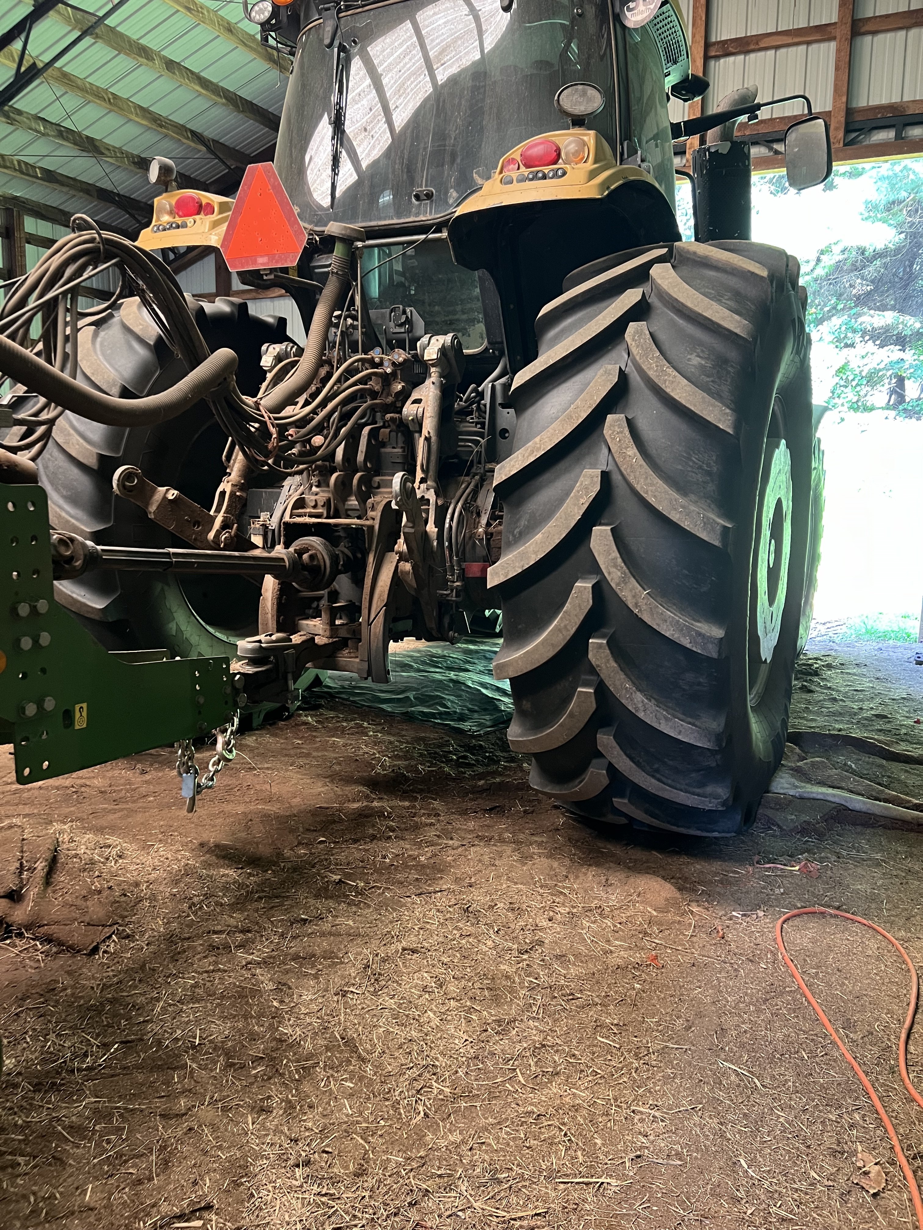

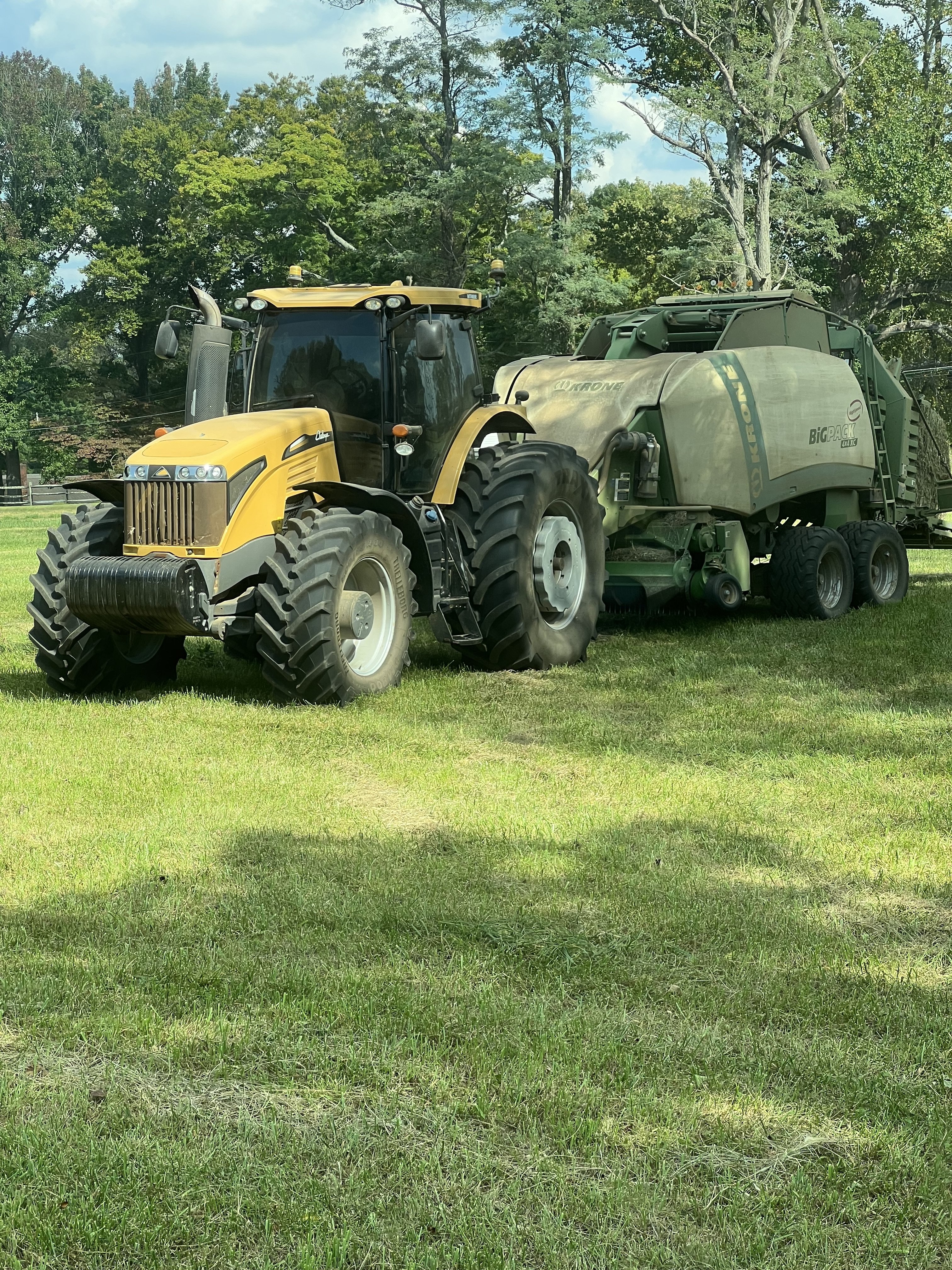

I have CEAT’s on the front on my small Challenger. Love the tires, but they are wearing down too fast.
The Cultors on the back wear like iron.
Both made in USA
   / Where do you buy tires? What brands to avoid. #116
I'm afraid to even ask the size. :ROFLMAO:
You oughta see the size & price of these puppies…..
The one rear tire was $4,000.
The fronts were $2,000 each
