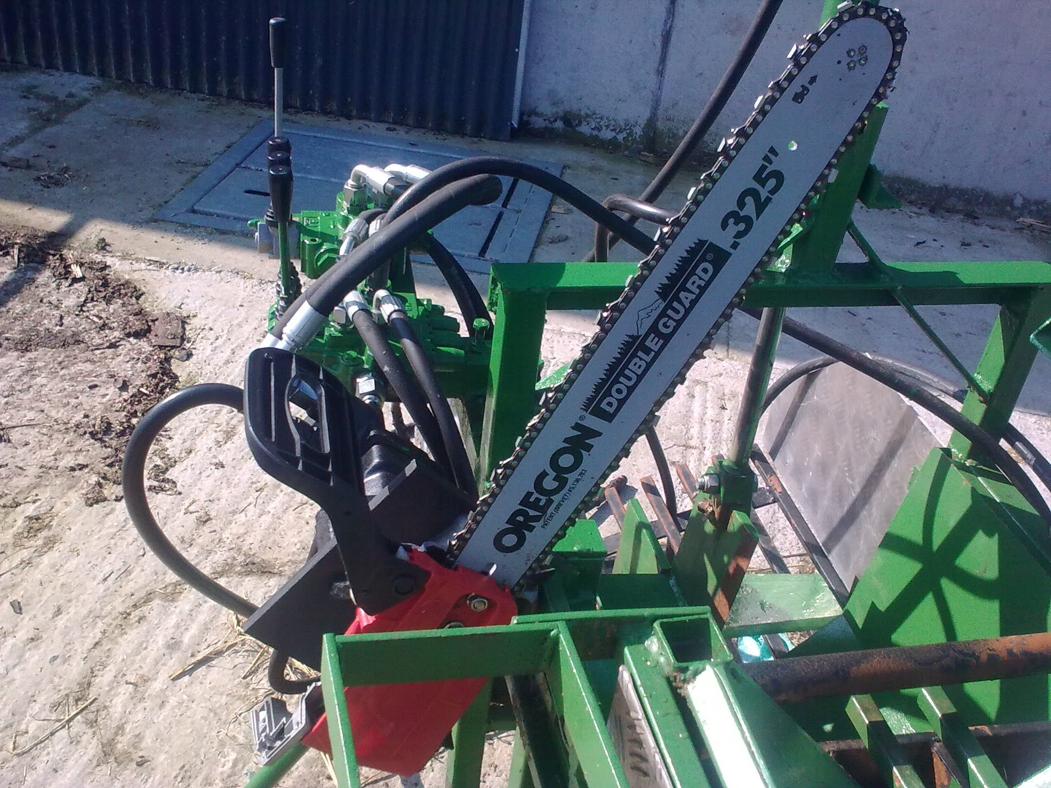

The limbinator?
That's it!
Basically take the limbinator, but mount the saw to the edge of the bucket (so it isn't sticking up in the air) and have it function like it would on a firewood processor, where when you open the flow to the hydrualic motor, it spins up the chain, and then pivots the bar down, cutting the log as it goes, then when you shut flow off, it returns back up.
SO, pretty much a combination of the Limbinator and a firewood processor bar. Sounds expensive. :D

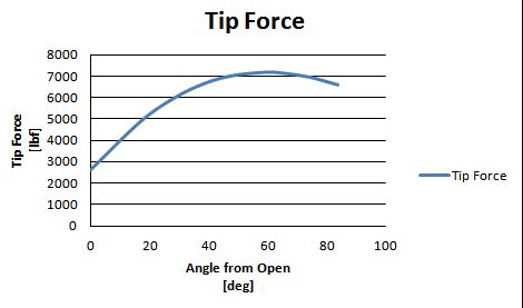

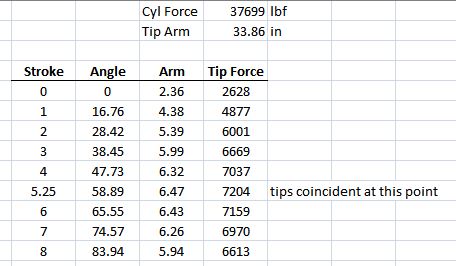

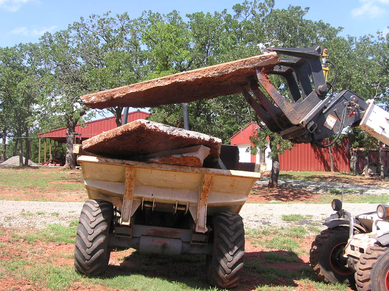

The marketers for the gorilla grapple pulled a fast one. They used the number for cylinder force for a 4" cylinder at 3000 pounds and indicated that this is the force at the ends of the tines. However, based on the dimensions you shared, the force at the end of the tines is on average about 1/5th of the cylinder force, or about 7500 pounds. The force would vary through the the arc as the cylinder angle changes.
I think that's a common marketing practice. To get the cylinder force at the ends of the tines the cylinder stroke would have to be the same length as their travel distance?? At least I think that's right??
Well I just heard back from Sidney Mfg., gladehound is right, it is 7204 pounds.

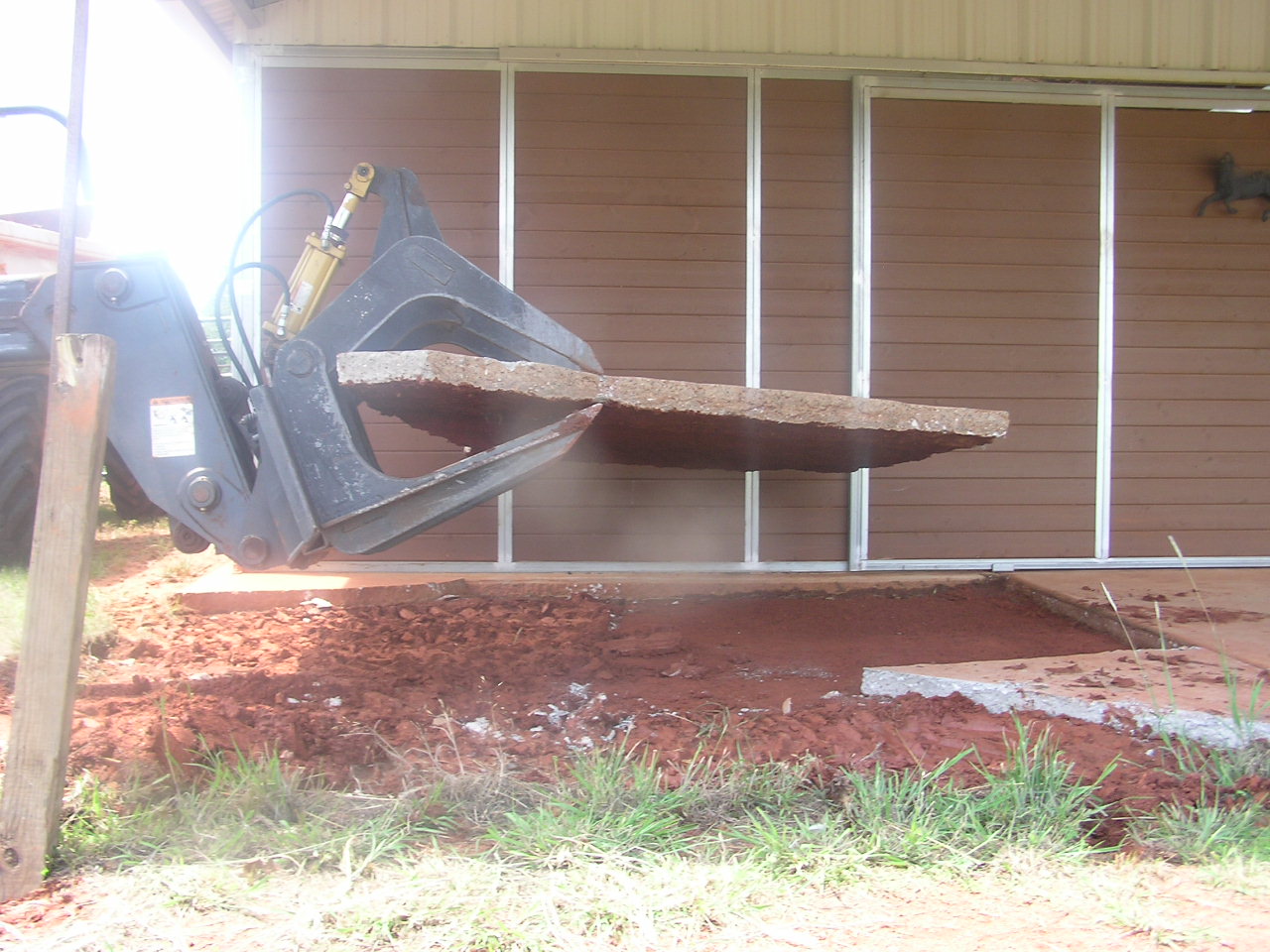

All I know is, it is strong enough to do whatever I have needed it to do. :thumbsup:
Had to be careful not to crush the concrete, when picking it up.
Had to be careful not to break this one, so I didn't close the tines down tight on it.

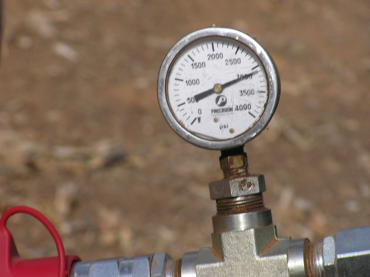

Used my test gauge to check the pressure at the aux connector on the boom.
Showed 3200 psi
Put the grapple on and clamped the center tines on a chunk of 4" thick concrete.
Squeezed and the relief opened, but no crush. :confused:
Tried a different piece, couldn't crush it, but with some curl down, it broke.
Fortunately I don't need to crush concrete with it. :thumbsup:
