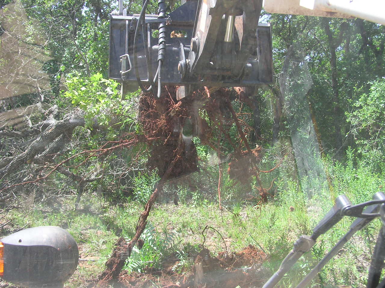

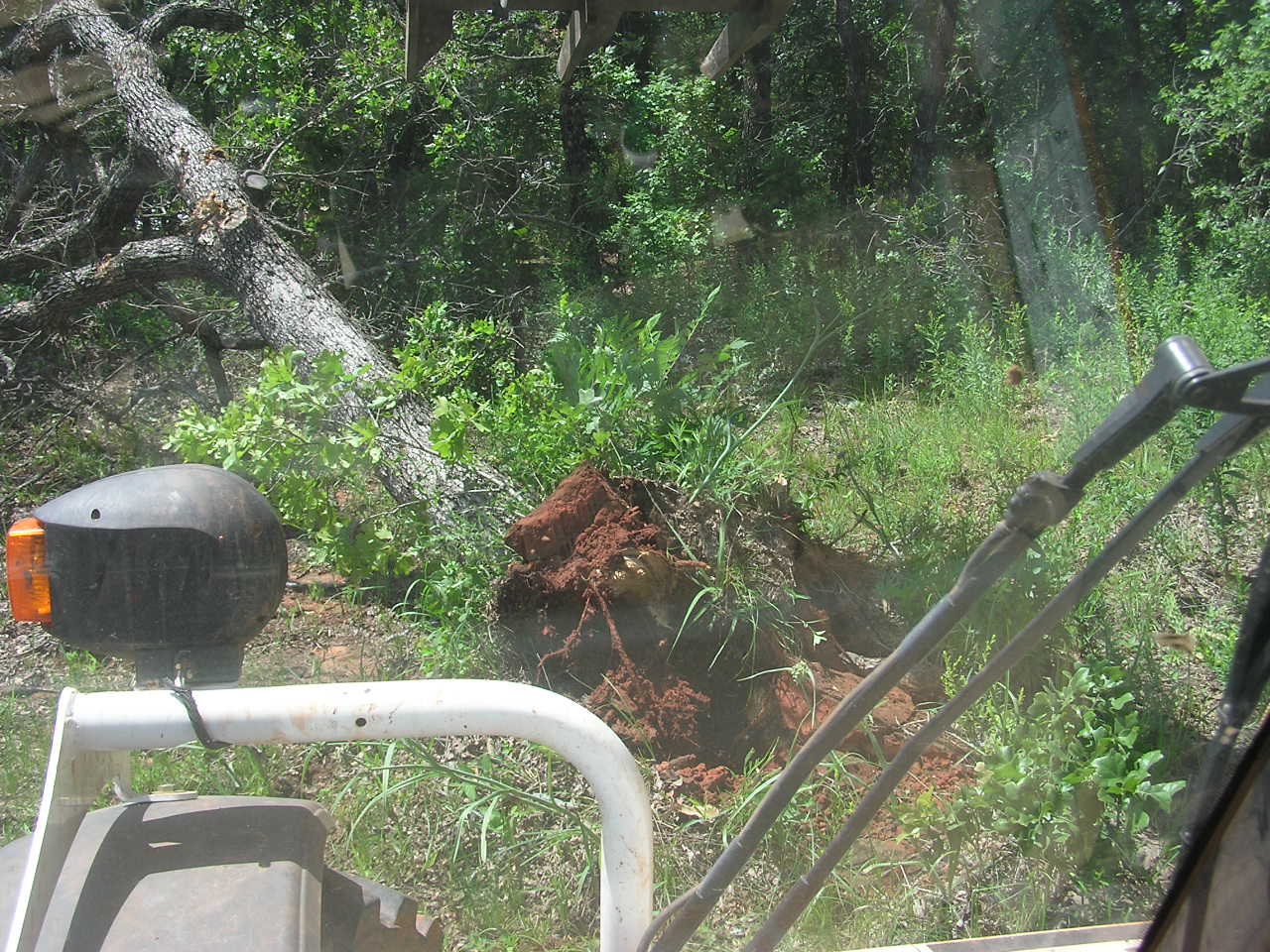

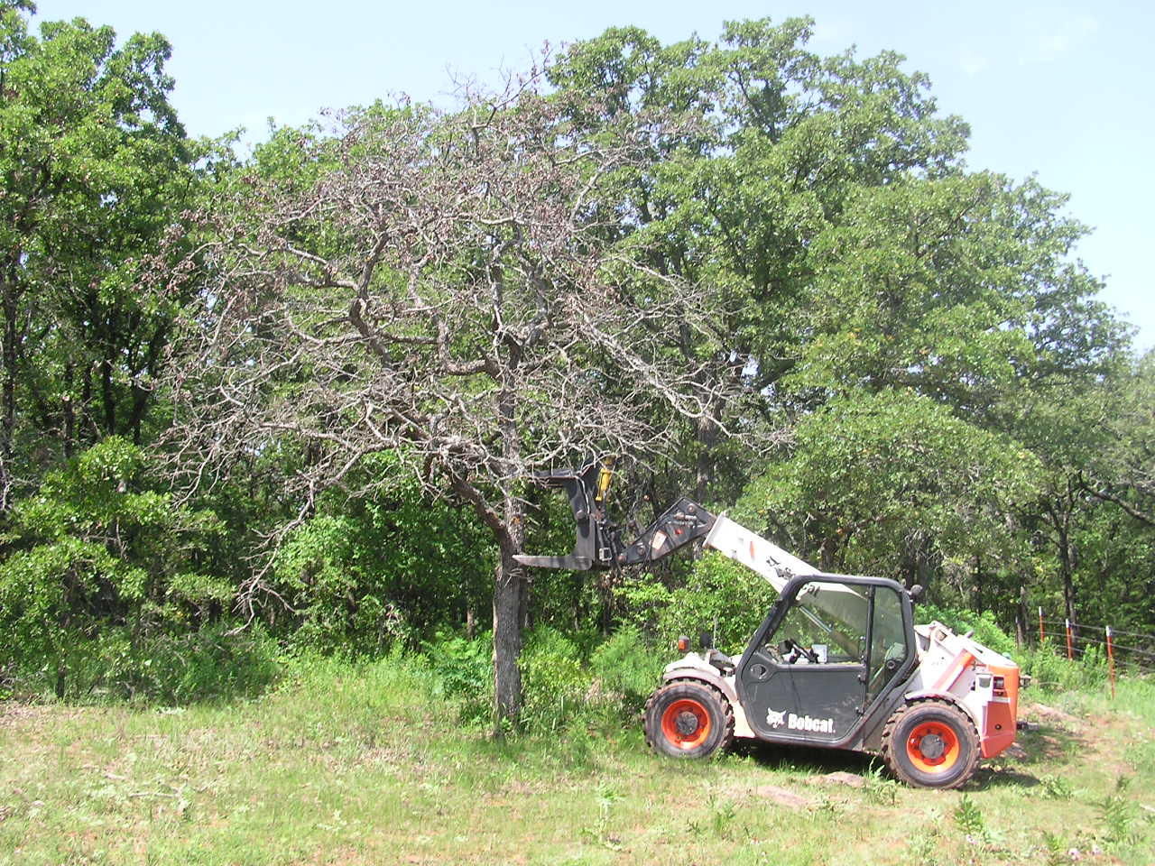

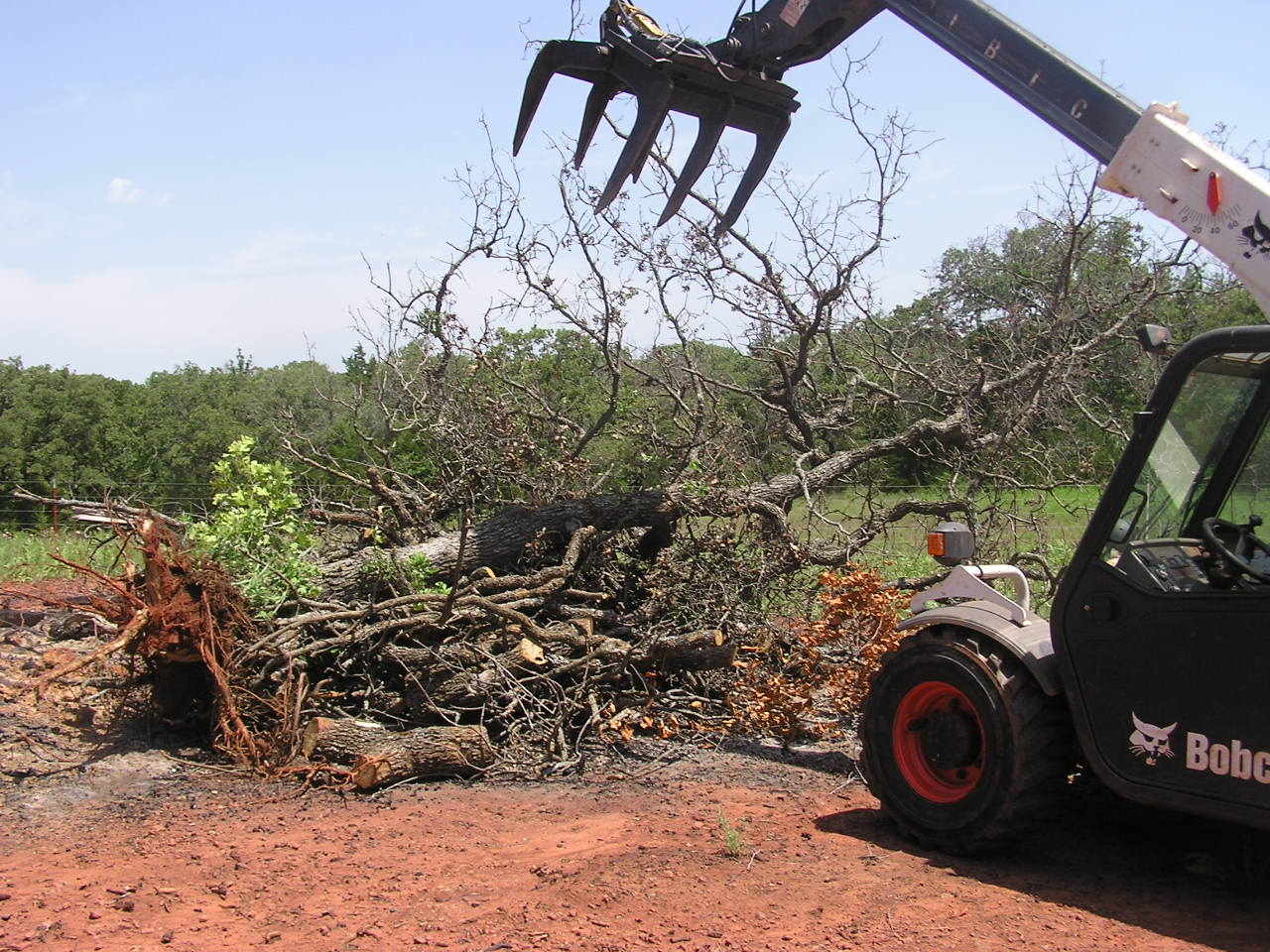

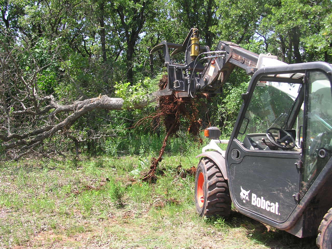

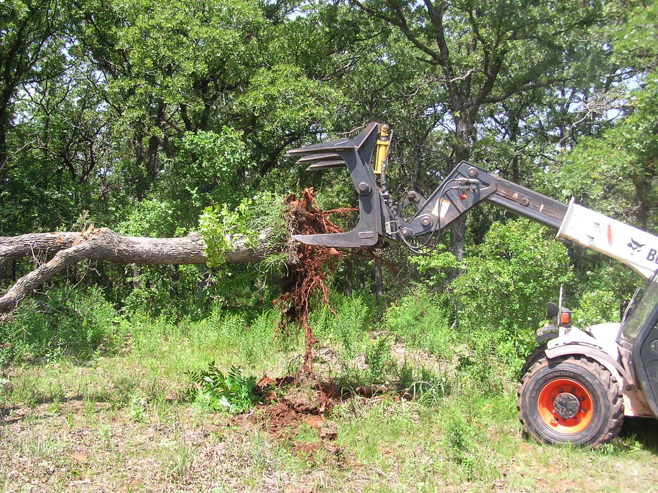

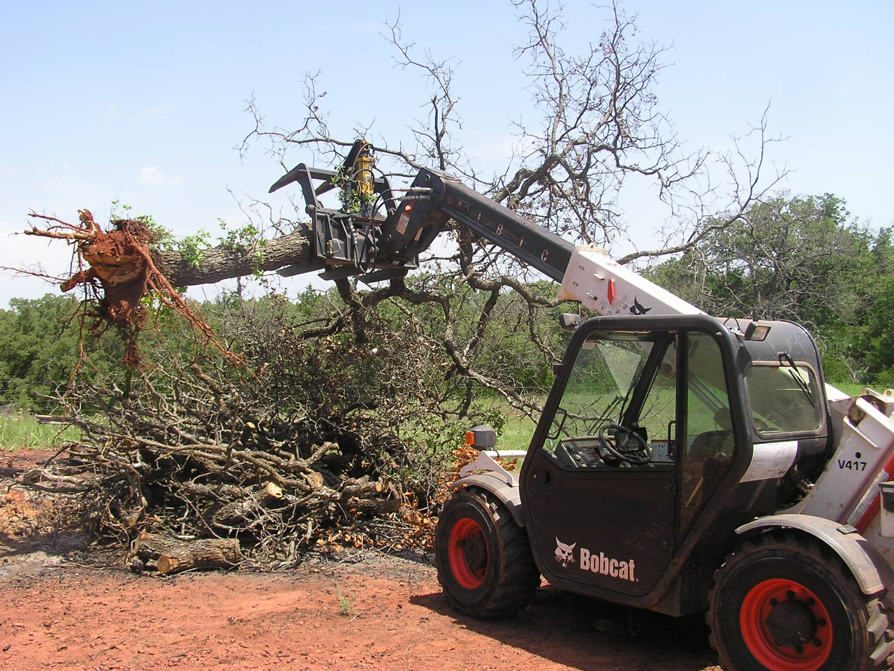

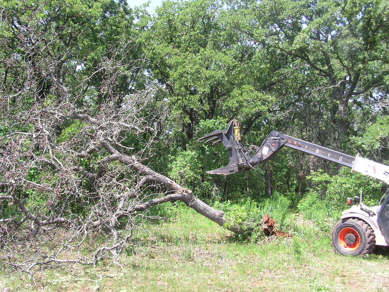

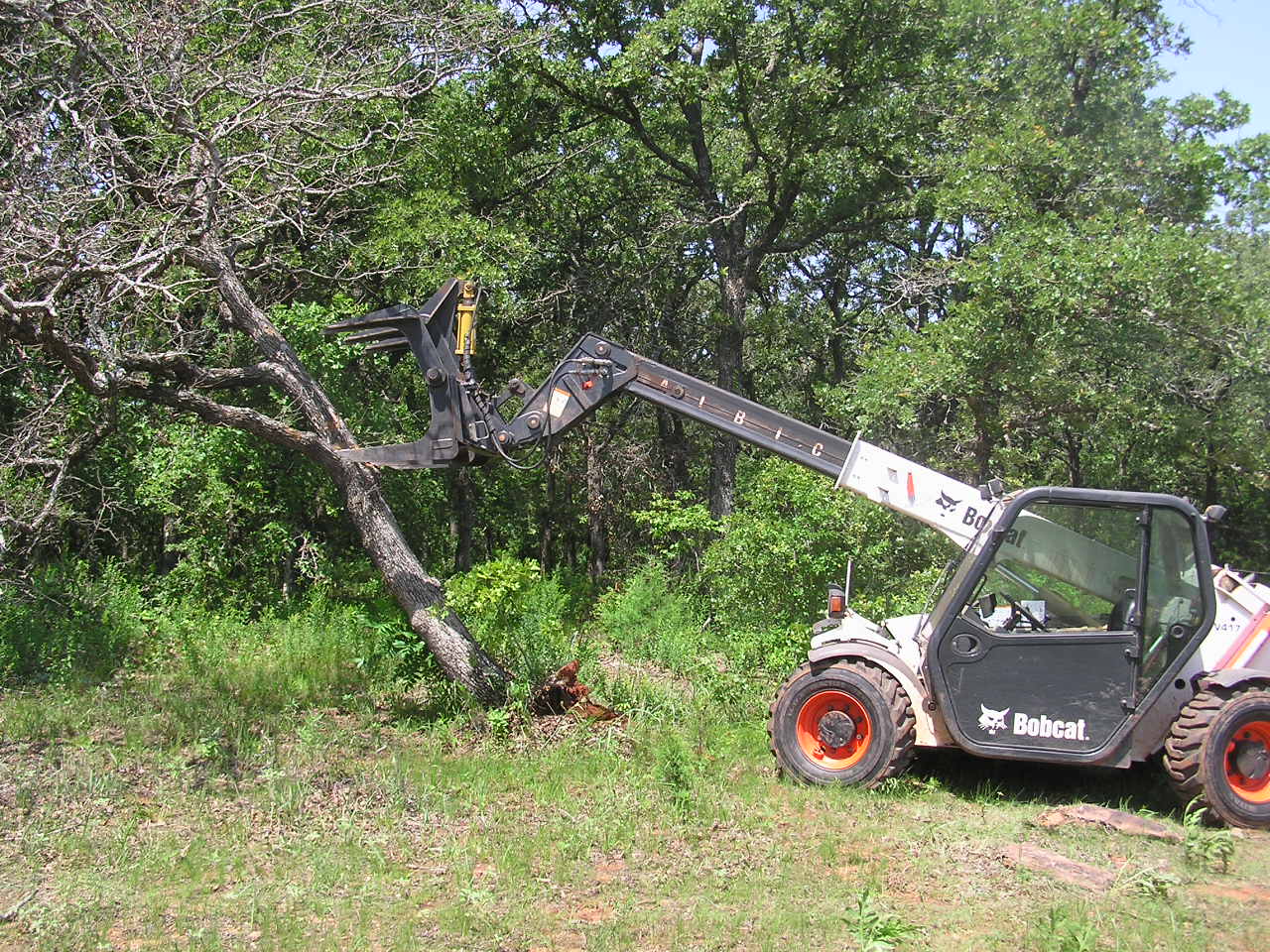

This is my technique with the V417 and Gorilla Grapple.
With the boom retracted put the lower center tine on the tree, up about 6' on this dead one.
Slowly extend the boom.
This one will be easy, the dead roots are breaking.
Extend the boom further, notice the extend markings on the boom.
Don't have to worry about the root ball on this dead one!
Extend some more, it is almost all the way out.
That is a sand rock up on the trunk
Boom is fully extended, the V417 never moved.
Retracted the boom, stabbed the root ball with the lower center tine, picked it up and dropped it a few times to get rid of the rocks and dirt.
The V417 still hasn't moved from where it started pushing!

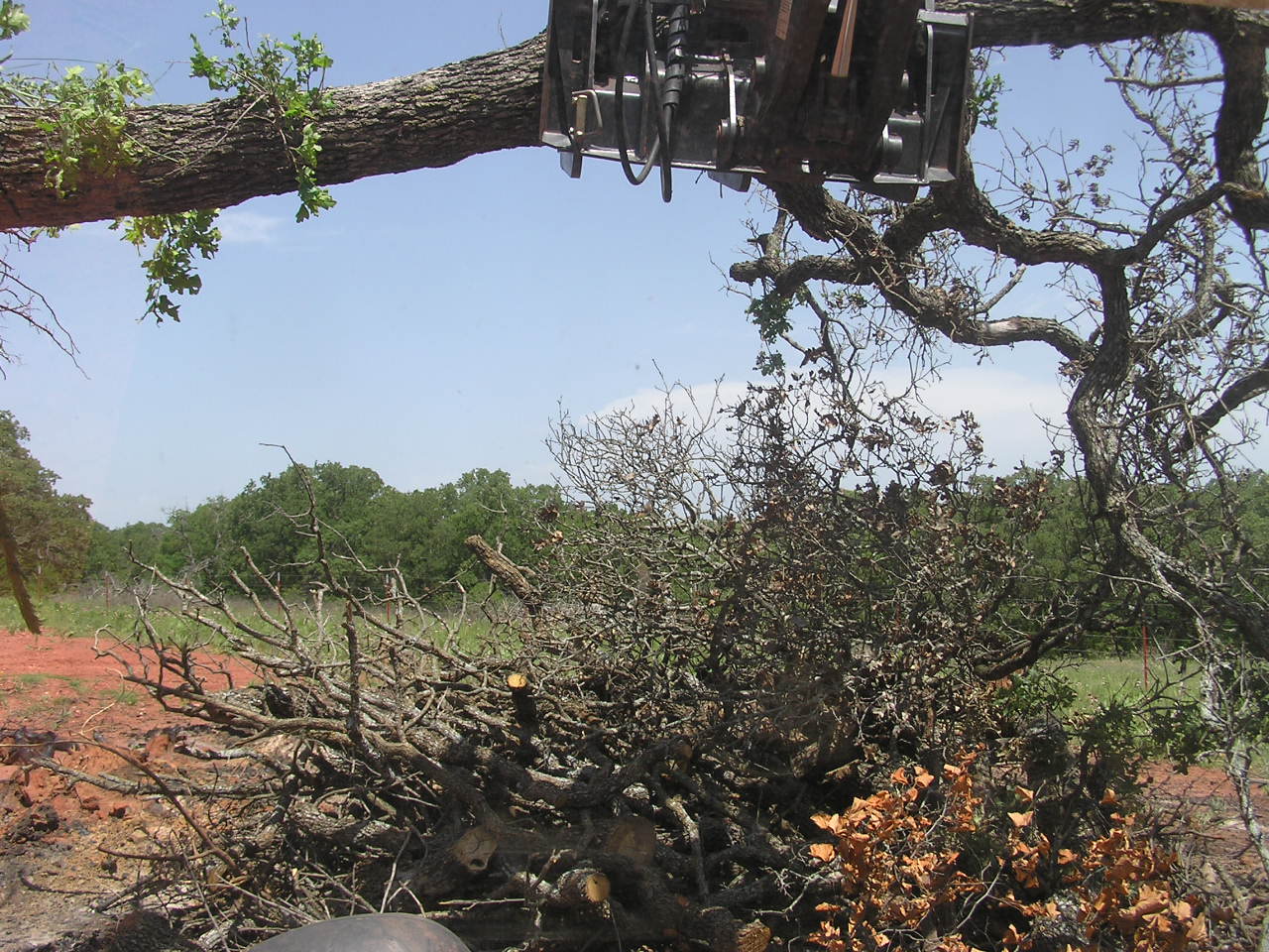

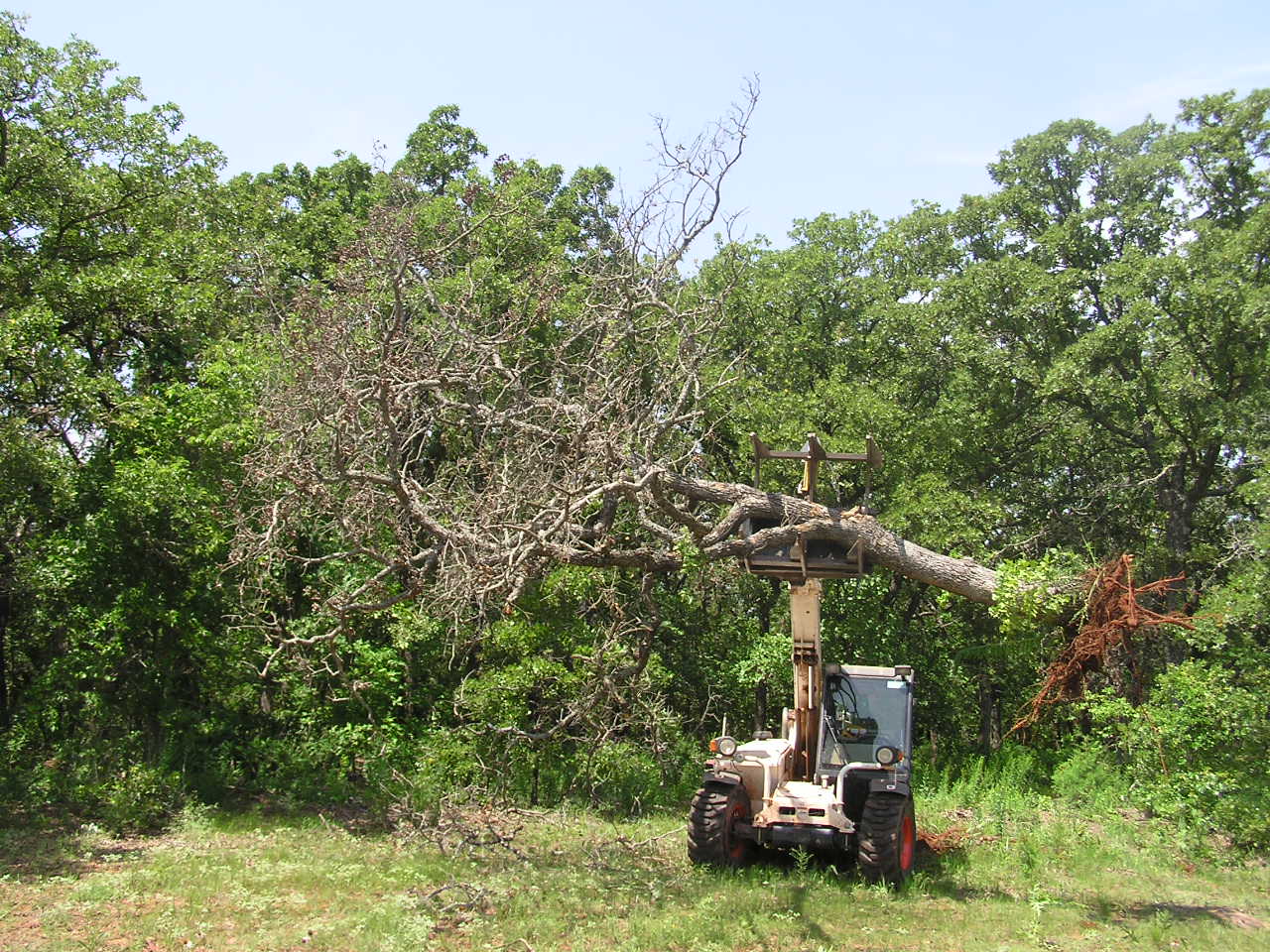

Found the balance point, notice the grapple top tines are open.
Took it to the burn pile.
It goes a lot faster when I don't stop to take pictures! :D

I noted the early reference to "widow makers"...limbs on your side of the tree ready to break off, or a tall tree that will snap in two high up ...while a forestry cage would be nice, a hard hat is a cheap investment ...and worthwhile (just ask me).
As for the poster who jonesed for 4wd, I've found it is largely irrelevant in this situation...as poster mentioned there is a tendency for the front to lift, anyway ...and down pressure on the bucket/grapple from a high position helps topple the tree forward ...a weightier tractor is the biggest help, here, IMHO.

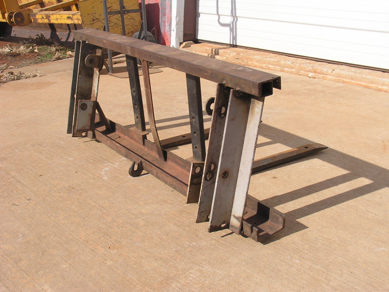

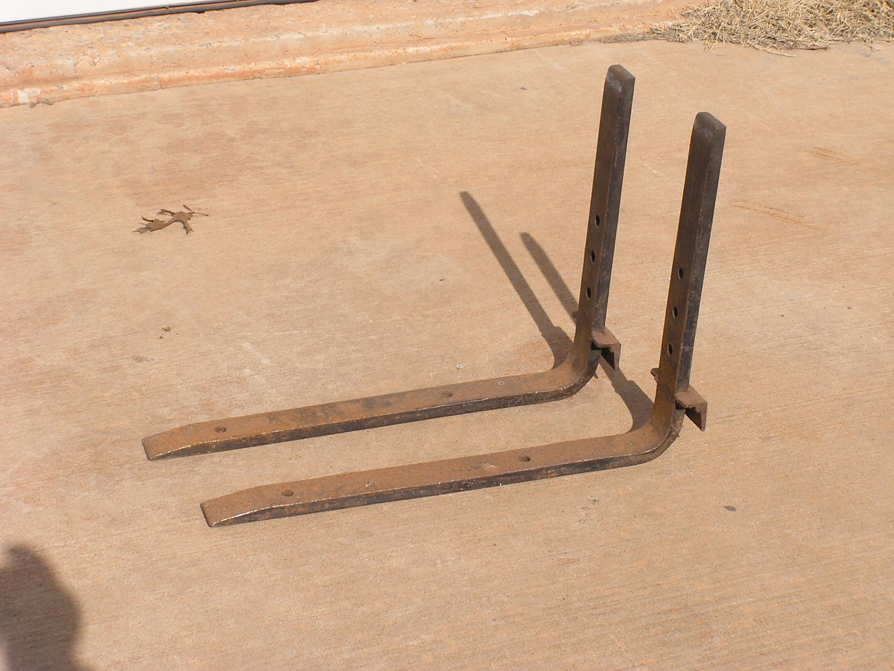

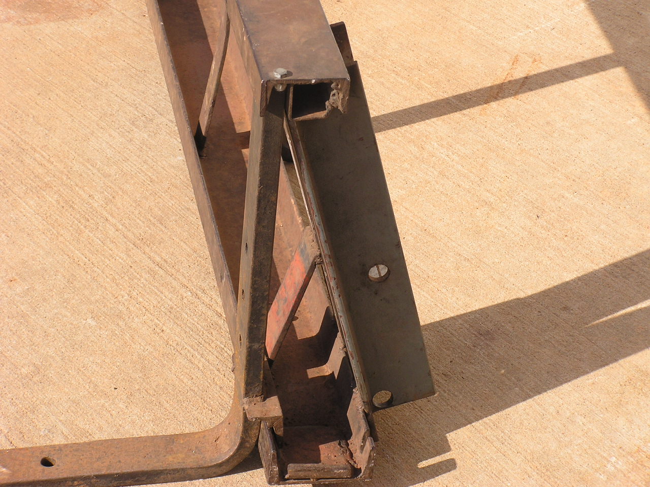

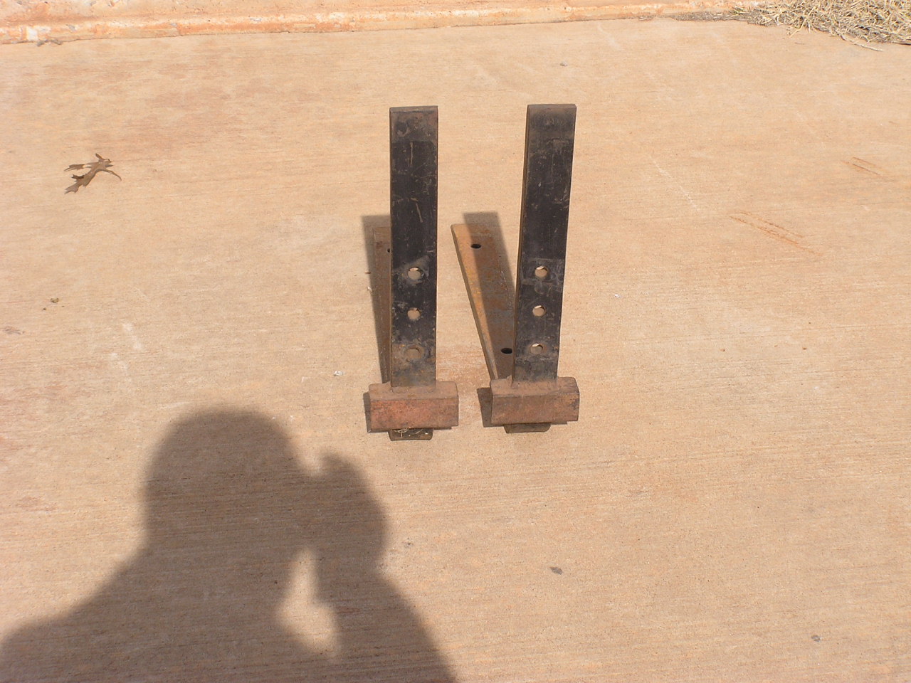

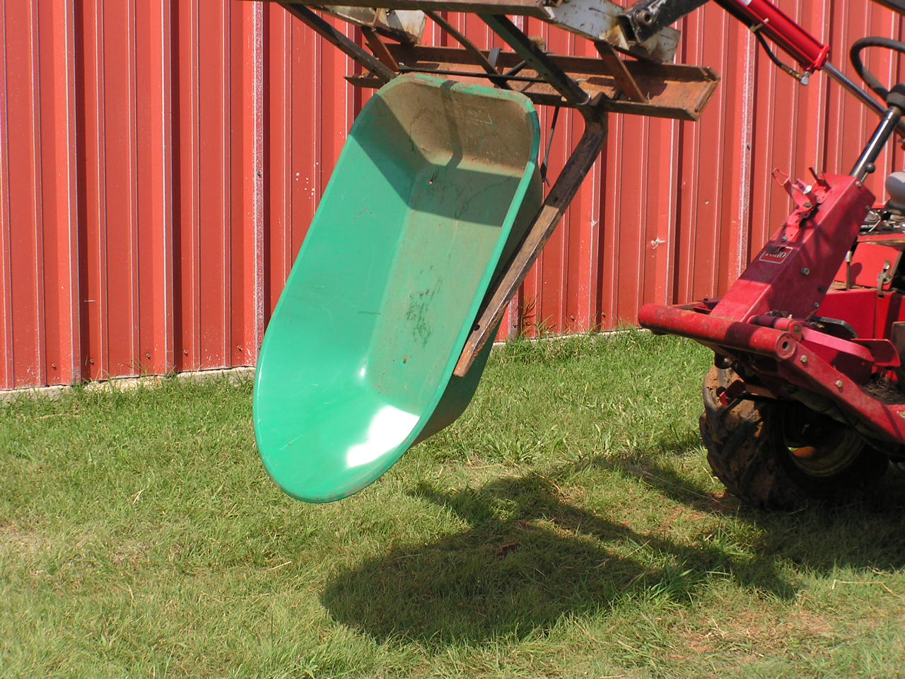

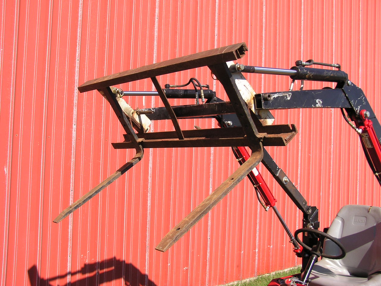

Wow you must have emptied the scrap bin when building that , I'm not being critical so don't take that the wrong way just looking at all the sizes and styles of steel in your build. Its like Johnny Cash's Cadillac, it all works in the end so good job.
By that, do you mean the loader or the fork frame?

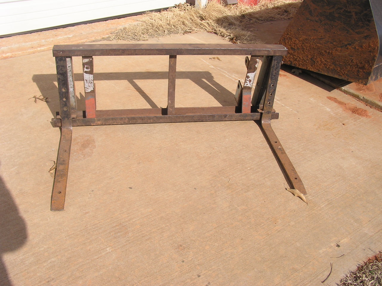

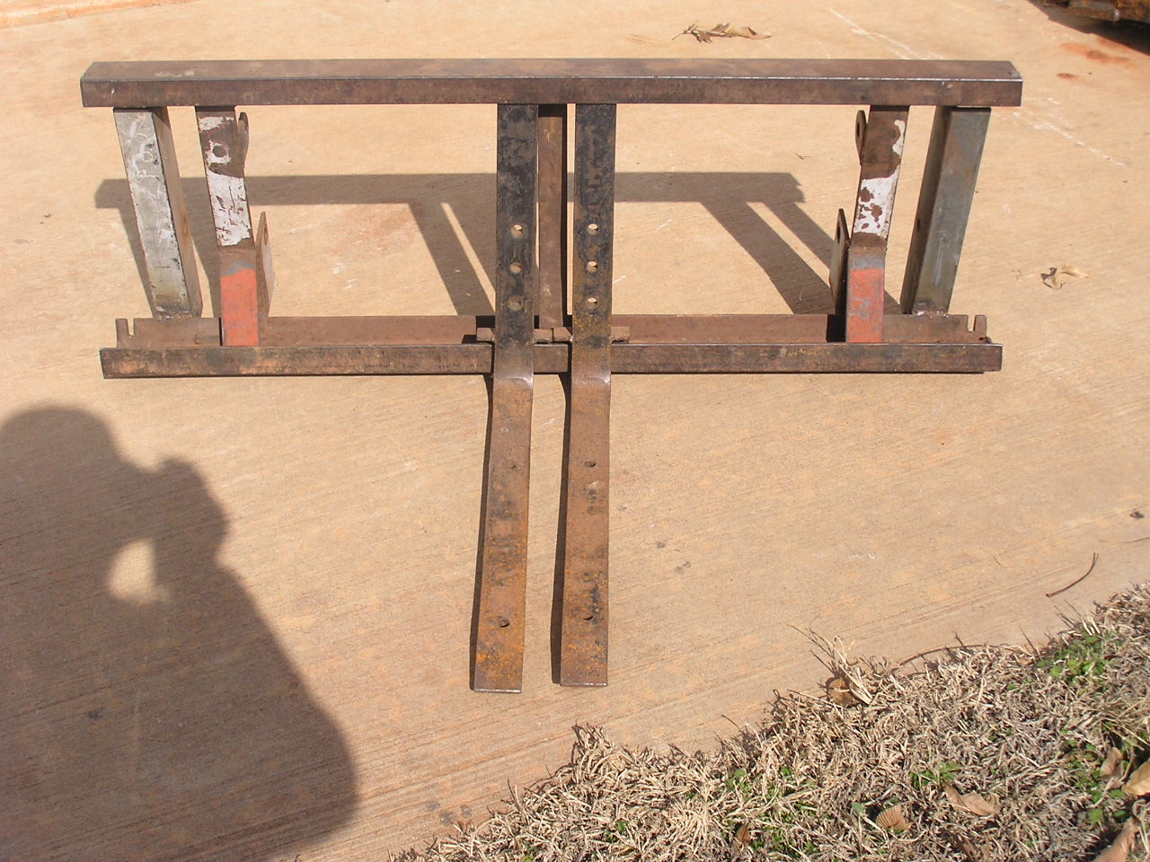

The forks where bought new in 1985, as part of a Wheelhorse garden tractor package deal.
They bolted to an A frame for the 3 point hitch. I welded the angle iron on the back.
I built the frame to fit the loader on a Craftsman GT that I had back then.

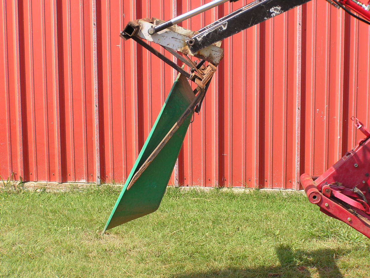

I added the outside piece of angle iron some time after putting this loader on the TORO.
Notice the chain slots at the ends of the bottom channel iron.
You are right about using the scrap bin, but I didn't empty it, didn't even come close too the bottom. :laughing:
I build things using the TLAR School of Engineering method. (That Looks About Right) :D
It has worked on three different loaders for 28 years, so TLAR works! :thumbsup:
Build thread for the loader: http://www.tractorbynet.com/forums/customization/272163-fel-toro-groundsmaster-put-together.html
View attachment 324348 View attachment 324349 View attachment 324351
View attachment 324353 View attachment 324354
TLAR, Oh I'm stealing that term for sure.lol
It was the framework holding your "bucket" that intrigued me.

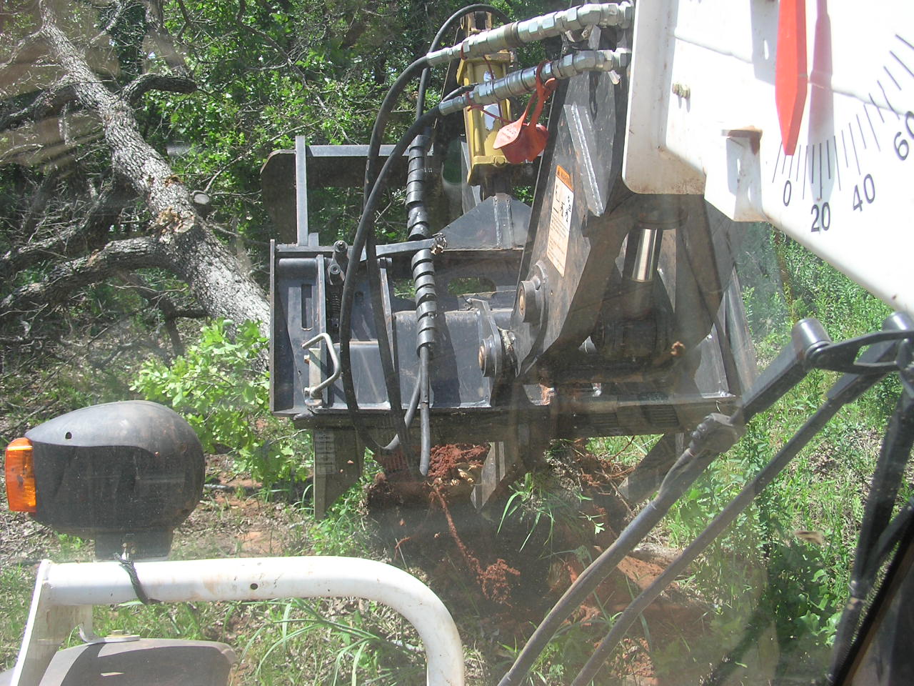

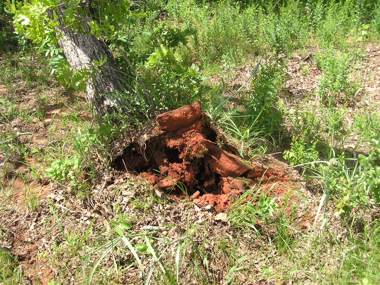

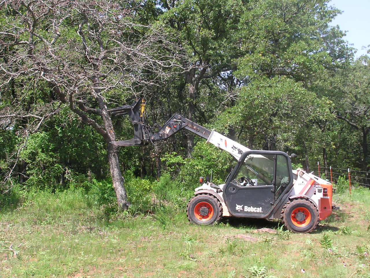

View attachment 324324 View attachment 324325 View attachment 324326
View attachment 324327 View attachment 324328
View attachment 324331 View attachment 324332 View attachment 324333
