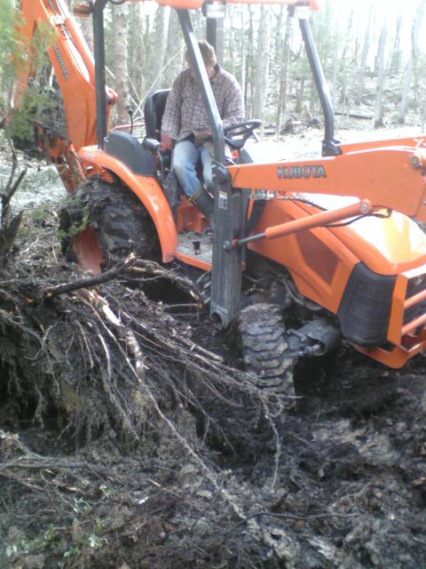

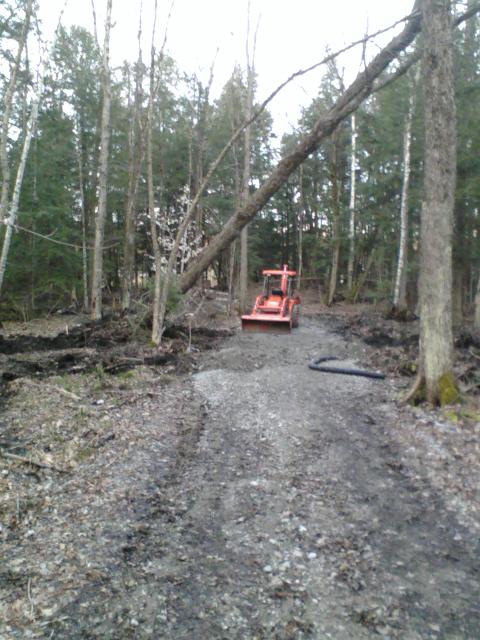

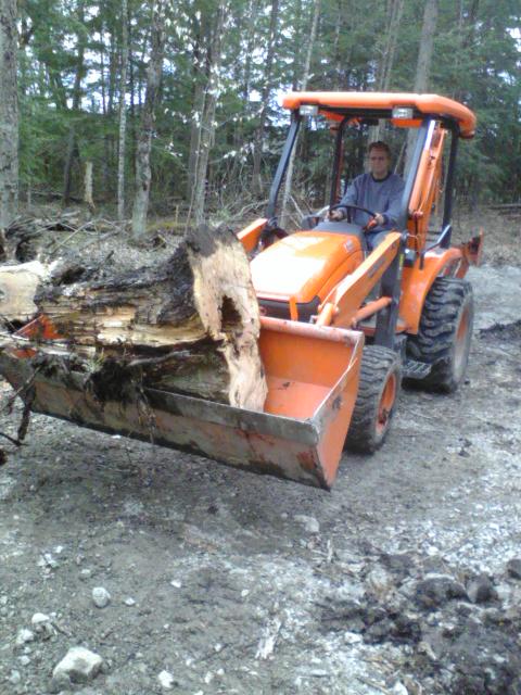

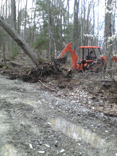

Finally got to do some real work with my Kubota L39 TLB this weekend. Dug a trench across the driveway, installed a culvert and then thanks to TBN posters tried falling some trees with the backhoe. I tested it out on a small 10 inch tree about 35 feet tall and was done in around 10 minutes. Couple of scoops to snap the roots then just push it over. The next tree was oak about 3 1/2 feet across, 70 feet tall. Took about 2 hours to dig out half the roots and then I pushed it over. It came half way down and was hung up in another tree. Took many hours and a chain saw to get it right down, cut it up and get the rootball out. Got stuck and figured out how to use the backhoe to lift the tractor and move it. Hope you enjoy the pictures. I have about 30 more trees to remove....
Pic 1 - The tree half down
Pic 2 - Digging the tree
Pic 3 - After being stuck
Pic 4 - Firewood

I read a whole long post here on TBN where this was safer than using a chain saw. Lots more fun...Ended up using a chainsaw after it hung up in another tree and i tried to pull it down with a chain but broke the chain. Besides it was my first time working the backhoe, have to learn somehow. It was very safe as the tree was leaning a bit and I knew which way it would come down.

Im a believer now. Using the backhoe pops up the rootball and saves a lot of digging time. The rootball on this tree was almost the size of the tractor. Had to use the chainsaw to cut through some of the roots as they were 8 to 10 inches.

That made me laugh. I don't think I need instructions on how to get stuck as I seem to come by it naturally. It was my fault for not leaving enough room between the trees and where I dug the hole. A rookie mistake for sure, but I will continue to learn. It does get tippy when moving the back end with the hoe.

Digging around a tree for hours at a time is dangerous. You are loosening the roots and taking away the trees support. The wind could blow it down on top of you. That 70' tree would make a huge dent in the FOPS.
I have had operators with decades of experience take down trees that size with 20 ton and larger excavators. They do it in a scoop or three and can control the tree. Even they are reluctant to attack a tree their machine will not pick up.
Why not cut the trees with a chainsaw at shoulder height then dig up the roots and push the stump over with the FEL?

I was trying to use the momentum of the tree to popup the rootball as just digging half of it took about 3 hours. Ended up cutting it with a chain saw as it only came half down and hung up in another tree. Ended up taking many hours to get the rootball out. It was almost the size of the tractor and far to heavy for the tractor to lift. Had to cut the stump right off and chain to an upper root and roll it out. Just to pull it on the driveway would only happen with the front bucket full and backhoe bucket full and fully extended.
