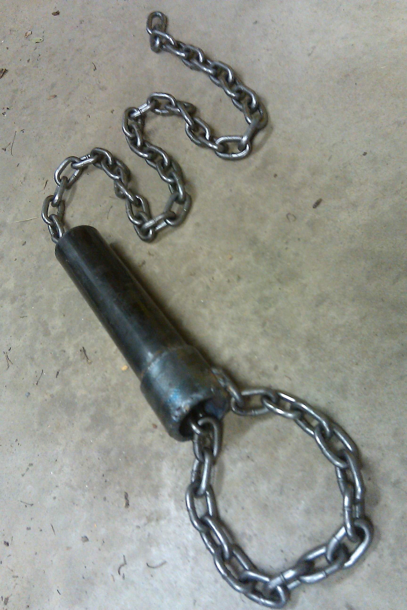

Wyobuckaroo, I want to hear more about that tree popper. Do you know where the link is?
Thanks
Here you go. I thought I had a picture of one in use but could not find. The choker attaches to the tree.
I save some of the old smaller tires. I then clip them to a chain, cable or rope when pulling. If it gives, the tires will help bring it down.

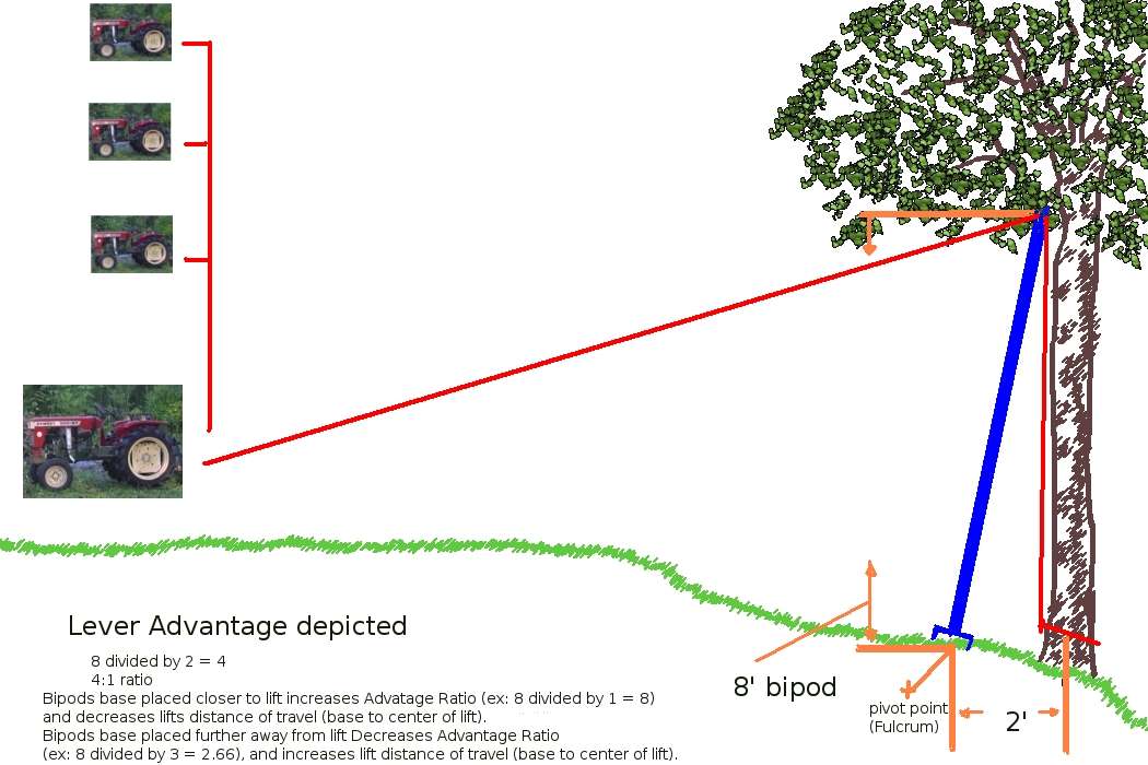

Anybody every try the bi-pod idea? looks like its pretty time consuming to set up/PITA but it might work well?
