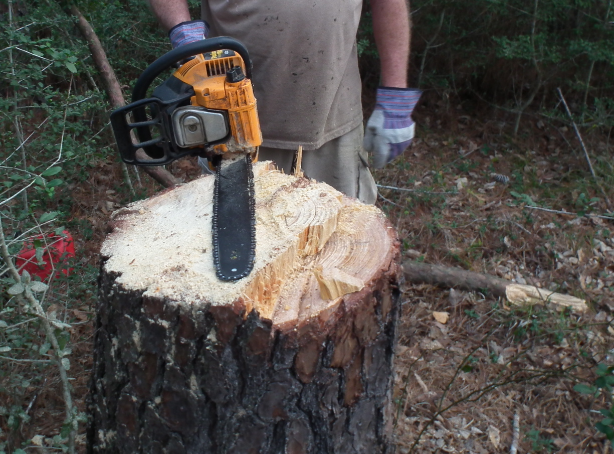

You can see the limb in the background of this pic showing that my chainsaw was probably too small for the job. I had to keep going from side to side to keep the back cut even.
I guess that just goes to show that felling trees safely is more than just technique. I had kinda glossed over the part were they said watch for falling debris.
