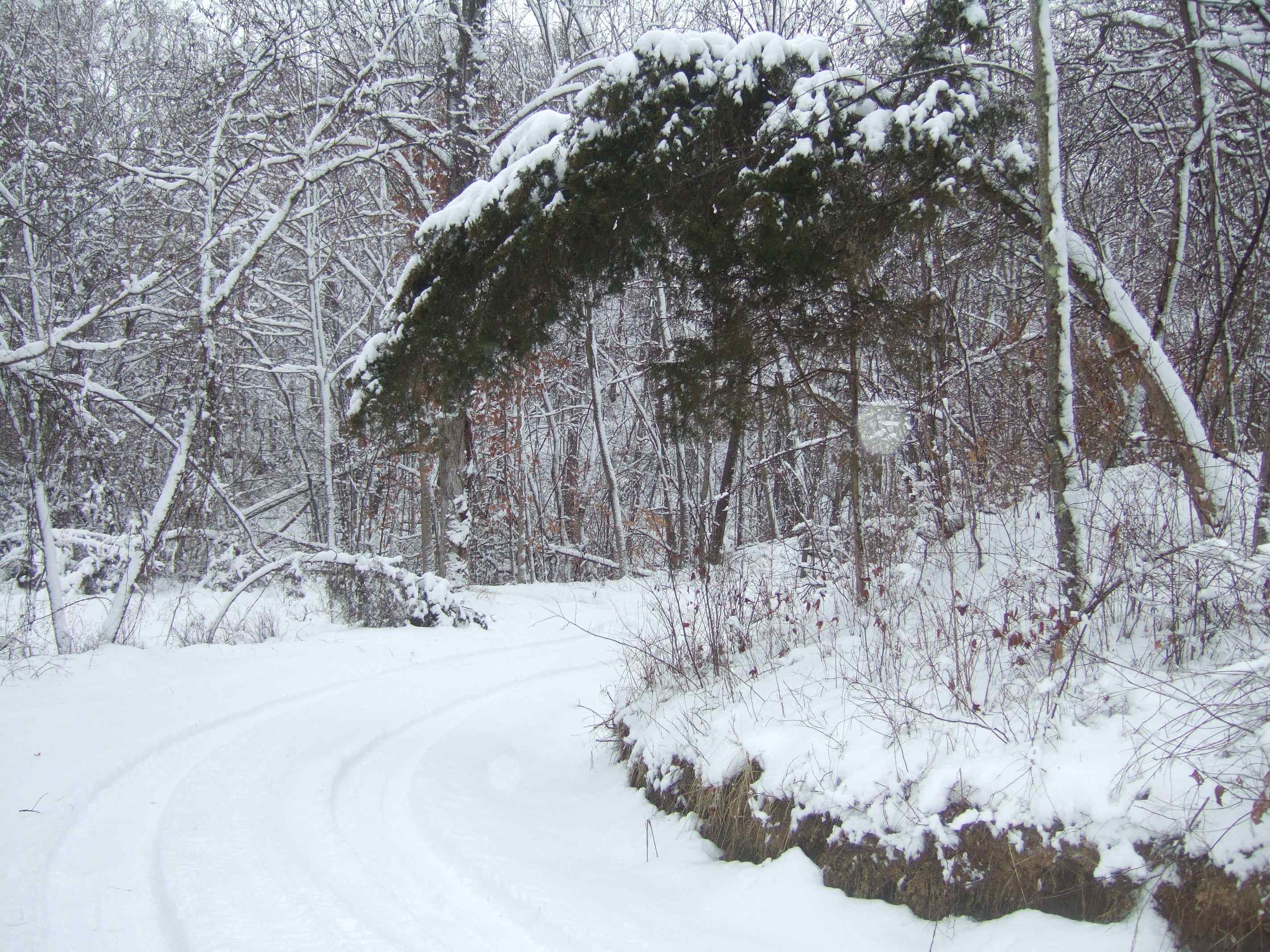

Hi. This is my first post and my first season of snow plowing. I have a 1/2 mile long driveway with two steep icy hills and my L3130 with FEL does not have filled tires or wheel weights. After sliding frontwards, backwards, and sideways down the hills I decided to get fresh underwear and consider tire chains. From reading posts here I guess I'd get rear chains.
Questions:
1 - What chains are best for blading snow on icy gravel roads? Should I get something like the V-bar duo or Double Chains? I don't foresee being on any pavement.
2 - Does salt harm gravel roads? What kind of salt is cheapest. I'd just apply it by hand or hand spreader in the worst curvy hill spots.

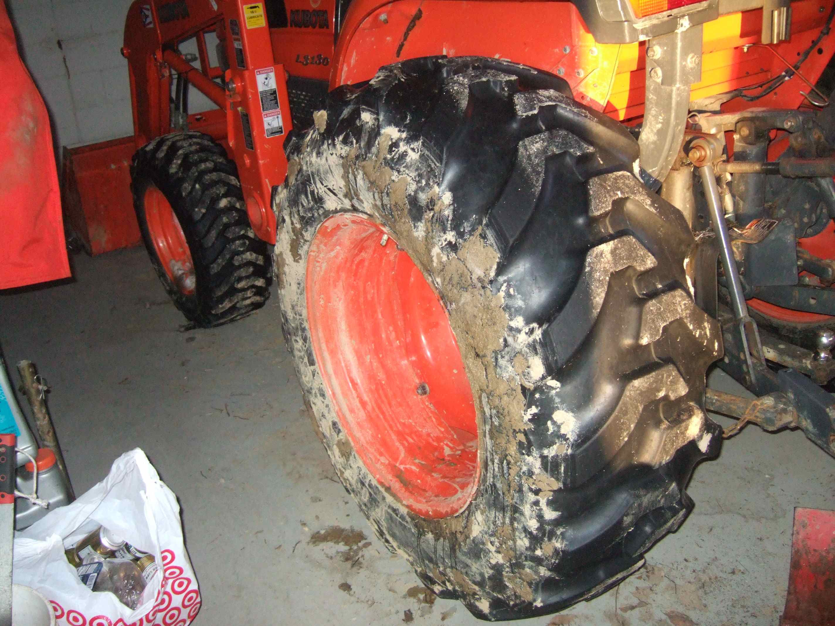

3 - In trying to determine proper chain size, I did a search and tirechain says my size tires (420/70-24) have two different kind of treads. Tirechain.com says:
420/70-24
NORMAL NHS TRACTOR TREAD ONLY
and
FOR INDUSTRIAL TREAD GO TO:
420-70R-24
Which are mine??
Heres a photo of my tires... can you ID?

a photo of one of the offending hills (the curve makes it worse.)

You have industrial tires (R-4's). You'll want to clean off the sidewalls and see which brand and size tire you have before you order chains.
Rather then order online, perhaps you should call Tirechains.com and tell them the brand and size.
Added: NHS is Non-Highway Service (learned something new today!). I'd guess your tires are "NORMAL NHS TRACTOR TREAD ONLY ". This should be embossed on the sidewall of your tires, so check before ordering.
During my search, it took me to tirechains.com and there was one picture (NHS tread) that look identical to yours.

Thanks for the info and the tire ID. I thought they were industrial tires but the "NHS" listing baffled me.

There's a thread here about chains on industrial tires.
http://www.tractorbynet.com/forums/owning-operating/159205-tire-chains-industrial-tires.html
At a minimum get chains on the rear. If you can swing it, get chains on all 4, you'll be glad you did. I have standard 2 link chains on my R4s and they work great. http://www.tractorbynet.com/forums/owning-operating/159205-tire-chains-industrial-tires.html
I second that. I bought my chains on line and ordered wrong size (for R1 tires I suppose.) so they are about two cross links shorter. Since I needed them right away I put them on. They work great even with missing links.

always load the rear tires on a tractor, you need that weight for traction and stability on hills. since you have those useless industrial tires the best thing you can do is put chains on them, front and rear, but without the loaded tires it won't help much.
/ what tires are these? #8
Everyone is right, a little or a lot of ballast on the rear of the tractor goes a long ways to regain some traction and balance front to rear. Could be some kind of liquid in the rear tires and or a heavy weight on the rear. Doing that some kind of chains on the rear would do wonders. Obviously more cross bars are better, but if it not ice anything would work. It take all these things to make a stable tractor that has traction in snow and ice, not just one thing.
/ what tires are these? #9
They are R4's and the best thing you can do with the current tires is fill them then think about chains.

I am in the same boat that you are. I have a 2.5 mile driveway up over a mountain and the R-4 tires really suck in the snow. My tires are not loaded either , I just bought the tractor. It is pretty helpless for sure.
As far as the salt thing on gravel/dirt roads goes, I was always told not to use salt or you will have a muddy mess. It is said to " take the bottom out" of your road. I tried salt on a short stretch once and it did make that section a total mess for quite a while... I wouldn't do it if i were you. If you have a wood/coal stove or know someone that does, ashes work great on the icy spots and it will not harm your road come spring.
never put salt on gravel or dirt roads, you'll be sorry, makes the ground spongey and the bottom will drop out of it.

Good advise with the salt.
Next winter I'll be "more" ready. Aggressive chains, weight in rear, pile of sand, fresh undies.
And if that doesn't solve it, would paving the very worst 60 foot stretch help?

Big e, you also want to check and see what type of clearance you have between the tire and your rear fenders. Some of the Kubota's with R4 tires have a problem fitting chains do to the clearance issue. I don't know if that is a problem with you L3130 or not.

Kubota sells wheel spacers to gain some extra clearance. I think it cost about $200 CDN for spacers for an L3400 (for reference). I would go with 4 wheel chains!
