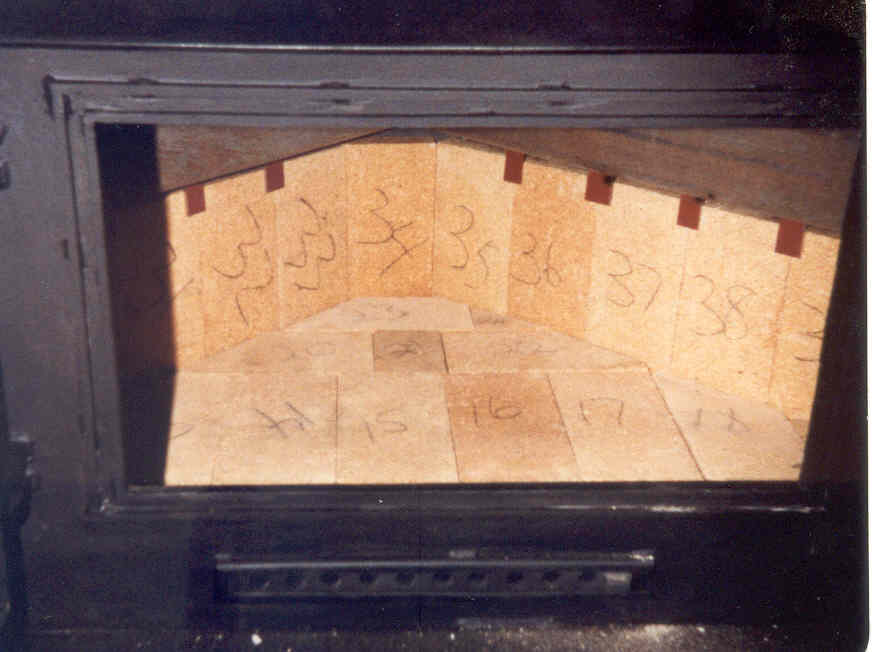

I sure would be replacing them bricks though .
Fred H.
I agree. This break happened above the the brick line however. I would hope to think that fire log height should have little to do with a wood stove cracking or else do not make the firebox so large. Lets face it, these new fangled EPA stoves are way more delicate than the old ones. More efficient definitely but of course, manufacturers are not going to tell you the extent of this frailty as they would scare off people from buying them. "Overfiring will void warranty" Beyond, "no part of the stove should glow red" manufacturers are a bit tight lipped about what can happen beyond "voiding warranty". Had I known, then I would have watched this stove like a doctor watches a cancer patient on chemo and if I had to do this, i would not have bought the stove which is exactly what they are trying to avoid. I feel a bit suckered in.

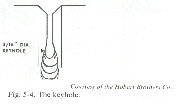

When you are talking penetration, for the root pass, you need a key hole, but the root pass may not be but less than 1/8" thick if done correctly. The weld on the back looks almost as good as the front. It's more of a "bridge" for future passes. The rest of the passes need only to melt the top layer and fuse the bottom of the top weld to the top of the bottom weld without voids. At this point penetration means something different, and anyone seeking more penetration than this is destined for a failed weld due to a large Heat Affected Zone (HAZ).

This over firing of a wood stove seems so strange to me. Never heard of the term until this thread. But then again I have never bought a wood stove. Built a few though, the ones for my self I've seen red hot, and no problems. :confused3:
