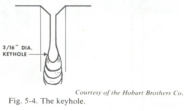

arrow here is a picture of key holing. When you see this you know for a fact you are getting 100 % penetration!;)
Thanks Shield. I have never seen this with my welder hence why everything I weld breaks most of the time.

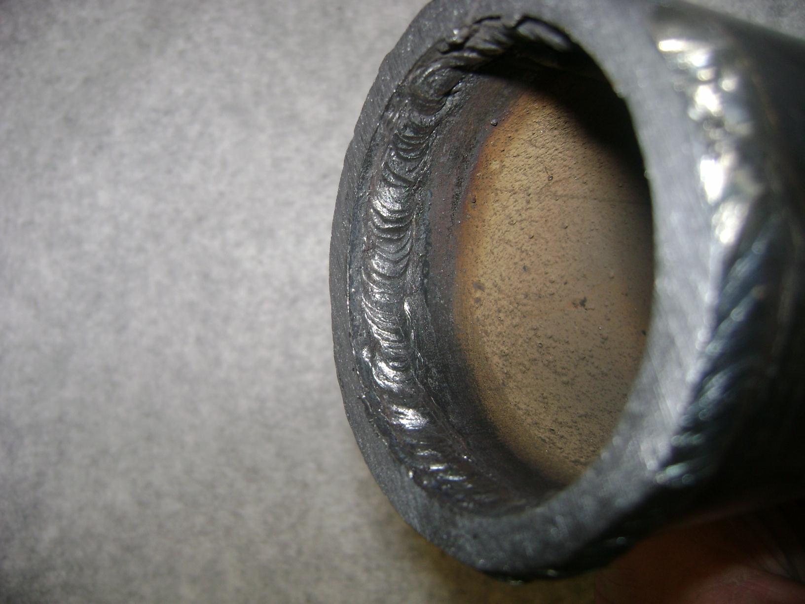

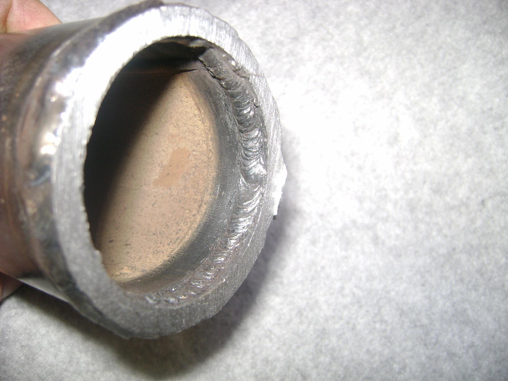

When I see that, I know for a fact that I'm about to burn through!
That is what you want!;) The trick is to get the inside / backside to look as good as the outside.

That weld looked like some 6010 or 6011 in the hands of a guy who only mig welds.

Oh OK, hard for me to believe a Mig only weldor can run open root pipe like the pictures I posted. Mark generally doesn't pick on me to bad.:laughing:
/ What caused this #39
No, I was talking about the chicken fecal matter that was supposedly a weld on the bucket posted above.
