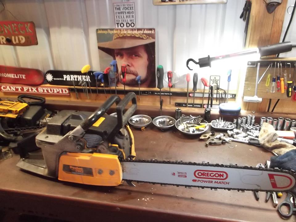

I've been buying Oregon roller nose bars, they have worked fine for me,

I prefer Oregon Roller Nose.

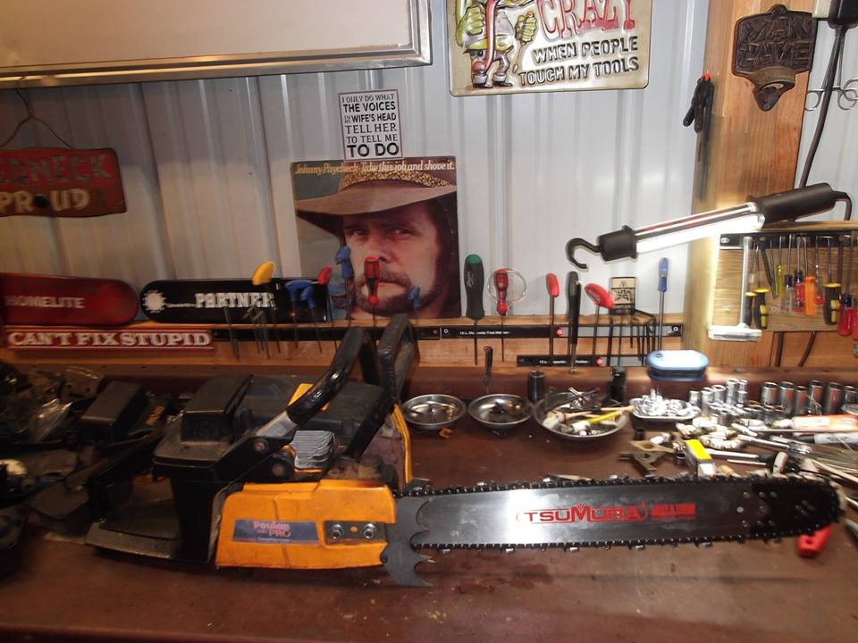

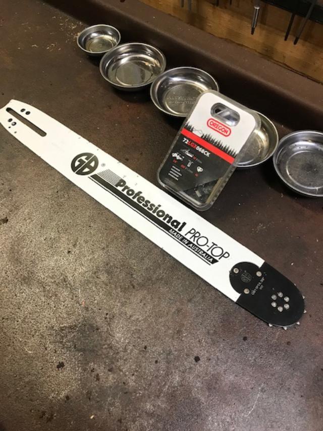

Tsumara makes a great bar and rails last longer then the Oregon.
GB makes a great bar too and longer lasting rails then the Oregon's too. But got to be sure the Aussie made ones.
Both in same price range too. I buy both depending on the deal I get.
