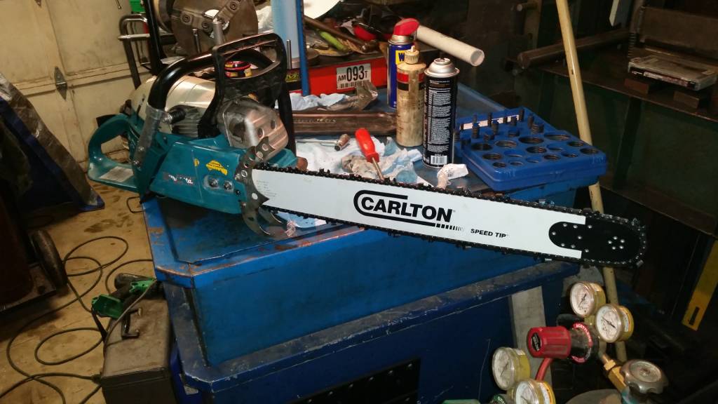

I really like my Carlton bars, this is a 24" on my Makita/Dolmar 6401603620186.jpeg

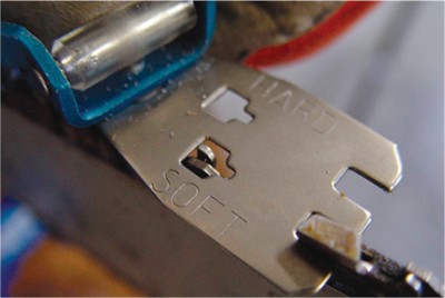

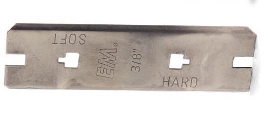

Are you sure that in SOFT setting that the front of gauge rests there? I agree it does for HARD setting, but the (somewhat confusing) picture instructions that came with my gauge shows SOFT setting with front of gauge resting on the junction of the next link back from the tooth. This would make the raker pop up through the little notch in front of the gauge‘s opening like it does for the HARD setting.
Note how the distance is difference between HARD and SOFT.
I believe if the front of gauge is on tooth in both settings, you’d end up with same results for both settings, instead of a shorter SOFT wood raker.
...and if you file off too much raker, next time you use saw “HOLD ON!” (assuming saw can turn it).

The Soft side makes a steeper angle and thus has you file the raker down farther.
/ What brand bar do you run? #33
It (the whole gauge) only has a steeper angle when you slide the gauge back from the tooth in front of the raker you’re filing to the next link junction.
It’s why the S & H holes in gauge are at a different distance.
The result is raker will be lower.
Also: How do you guys know when it’s time to retire the bar?
That's not my own picture. It came from an advertisement for the gauge. I always sharpen on "Hard", since 95% or more of what I cut is hardwoods (unless I am doing storm clean-up). The Hard setting still works fine on softwood, though it's just a little bit slower than the soft setting would be. I really don's notice, since filing with the "Hard" still cuts faster through pine than cutting through Oak, hard maple or hickory.
If I cut a lot of pine, I'd probably file on the "Soft" setting, though I suspect that would make it a bit grabby in hardwood.
Any time I use this, I always put the raker up through one of those side notches. Since the raker is offset to the side, it just fits better that way. I just put the gauge over the raker, and let the front of the measuring tool fall wherever it falls. The slope is the important thing. Hard to see in the picture, but when I put the gauge on Soft on my chain with the raker poking up through the side notch, I have a little room behind the back of the tooth. When I use the "hard" side, there is less room.

....The slope is the important thing. Hard to see in the picture, but when I put the gauge on Soft on my chain with the raker poking up through the side notch, I have a little room behind the back of the tooth. When I use the "hard" side, there is less room.
Exactly.
Not having the gauge pushed up to the tooth in front of it on Soft is the only way to change the angle that results in a shorter raker.
