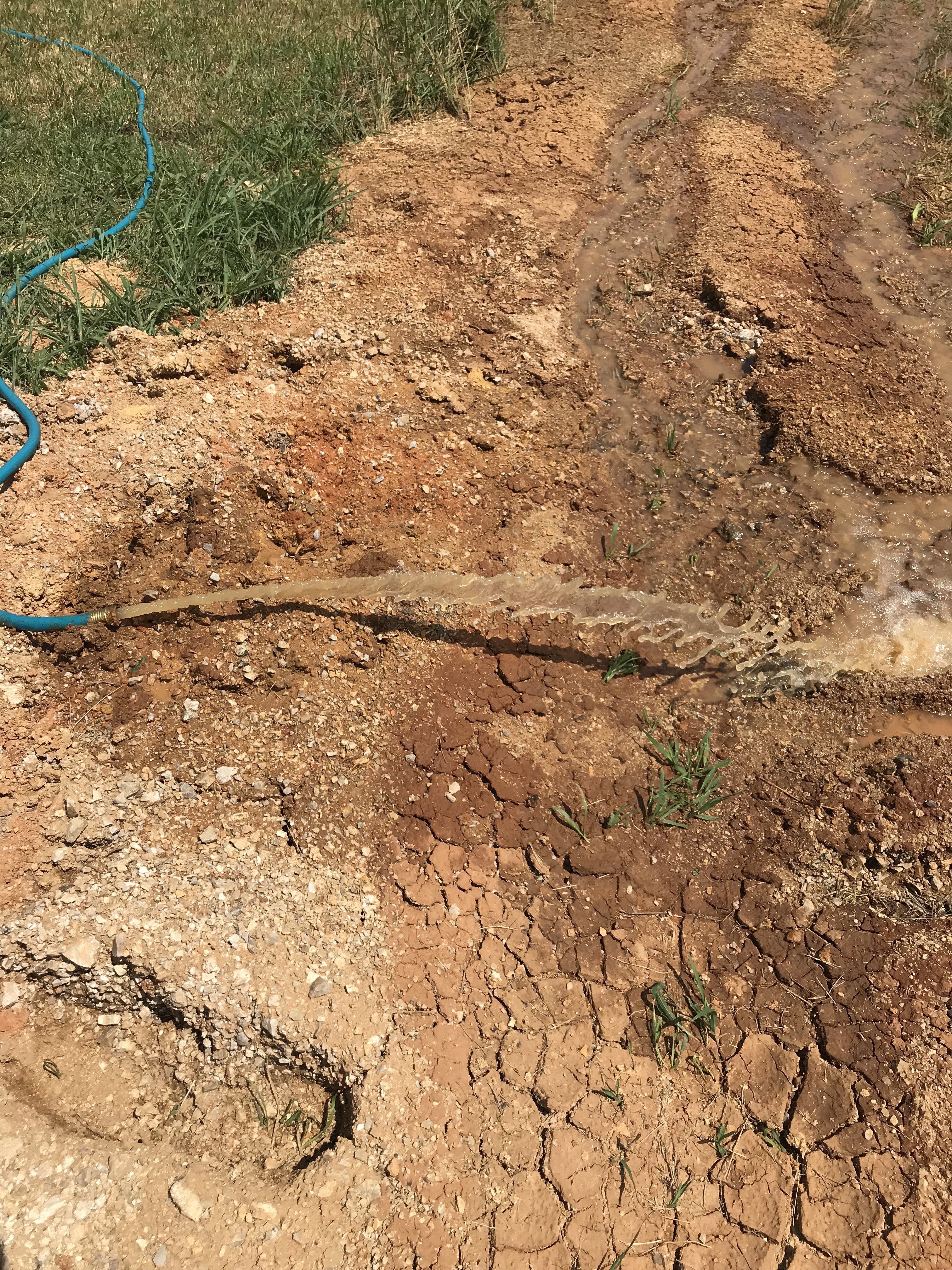

When the water is running (from a garden hose) are you seeing water run a few inches or two to three feet from hose. The well guys hooked wires to my pump wrong and I only got a few inches out of hose using my 5500-8500 watt generator. Had them check it. Now I get 2-3 feet.
   / Well is in...but I have some pump wiring and generator questions.
#28
Gary, I think you nailed it....thats exactly what it was doing. The generator would cycle on and off after about 6-8 mins. After reducing the pressure it has ran flawlessly. I ran it almost 2 hours today with no issues, the water is getting clearer but still brownish. I also noticed that now when I turn off the generator water still flows from the hose for almost 20-30 seconds then stops, it never did that yesterday. I believe that part is solved, so thank you every one for all the help.
When running, the water comes out very forcefully, shoots a good 2-3 feet.

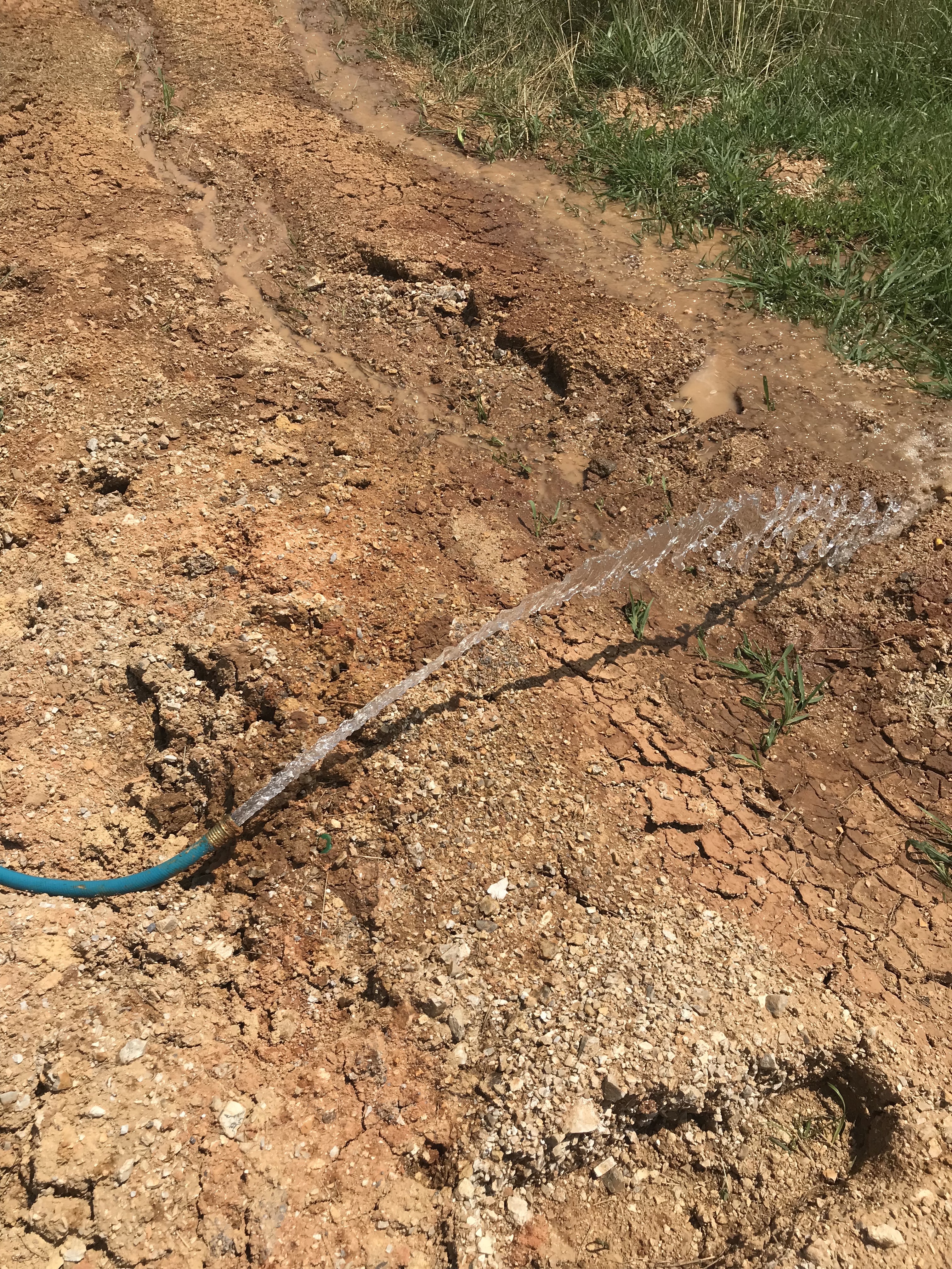

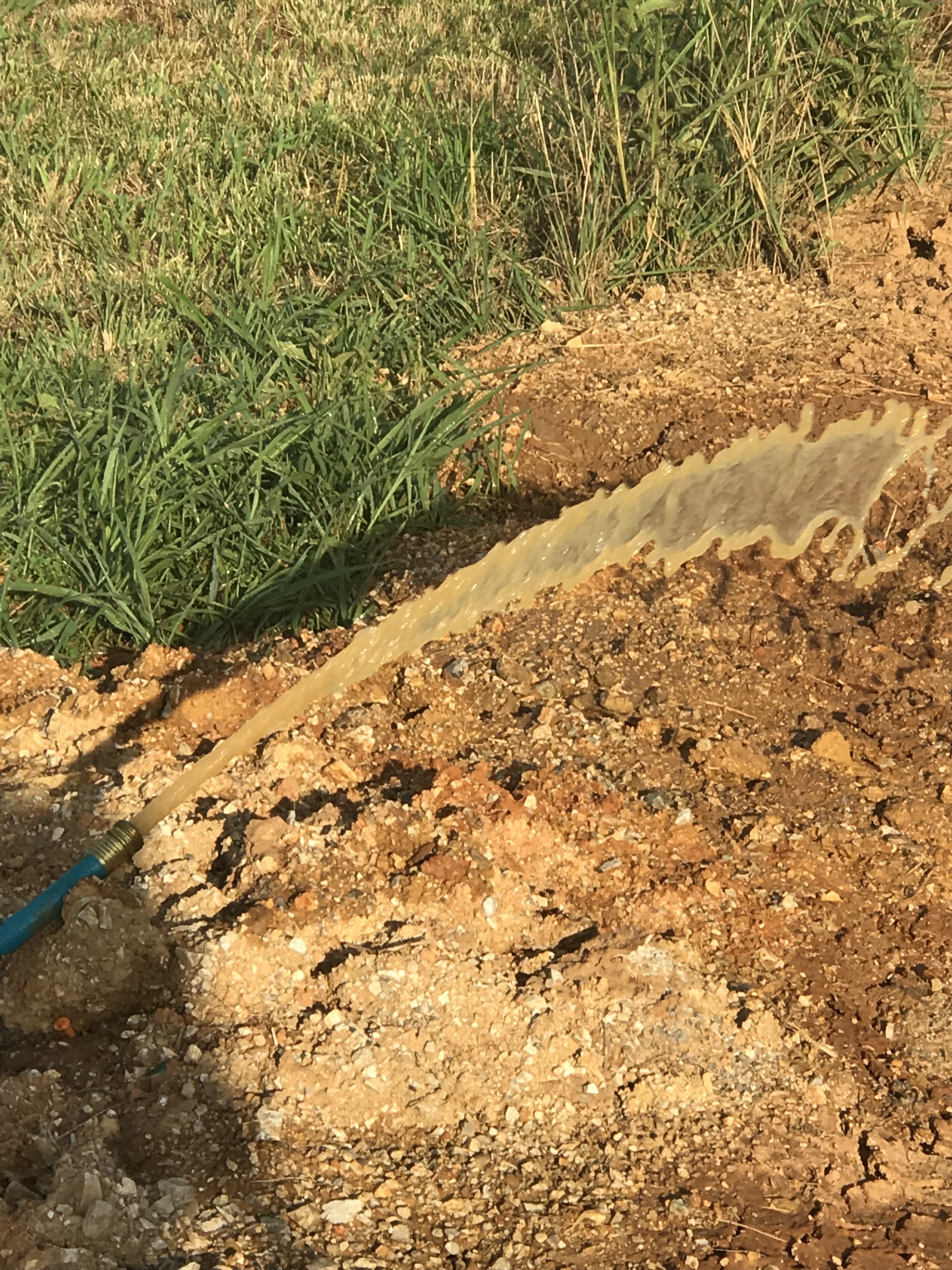

Here's how it turned it out today.....Went from brown to crystal clear then just a little cloudy. I want the crystal clear back! I guess it hit a clear pocket for a few mins, its not near as bad but not clear like earlier.
I'll keep running it daily and hopefully soon it will just stay clear.
