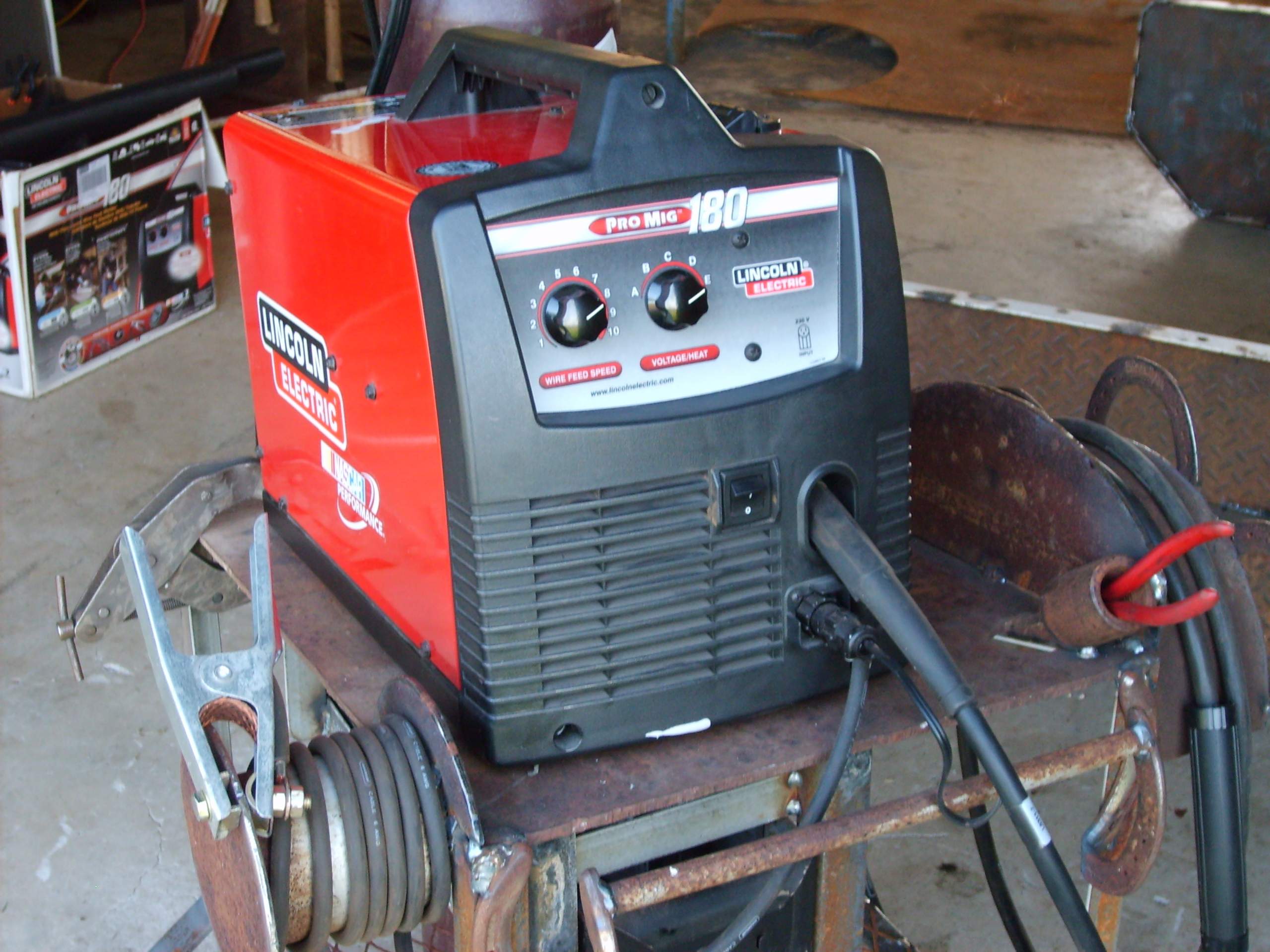

Beppington, I think you've started in the right direction. Now I know the buyer should always beware but I got my mig off of Craigslist. A pawn shop posted it. It was brand new in the box. My Lincoln 180 is 220v but I'm sure there's one out there that would accomadate your needs. This one sold new for over $600 and I got it for $400 plus tax. I guys it does pay to shop around.
