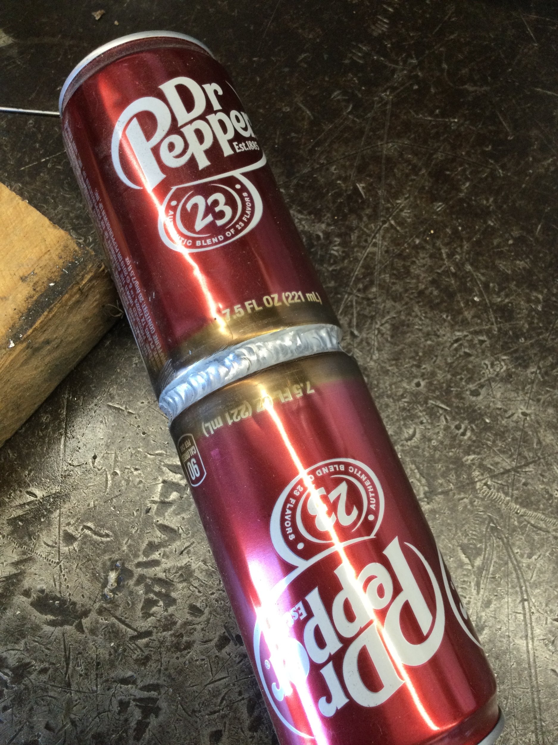

Maybe when he needs soda cans stuck together he can call you?

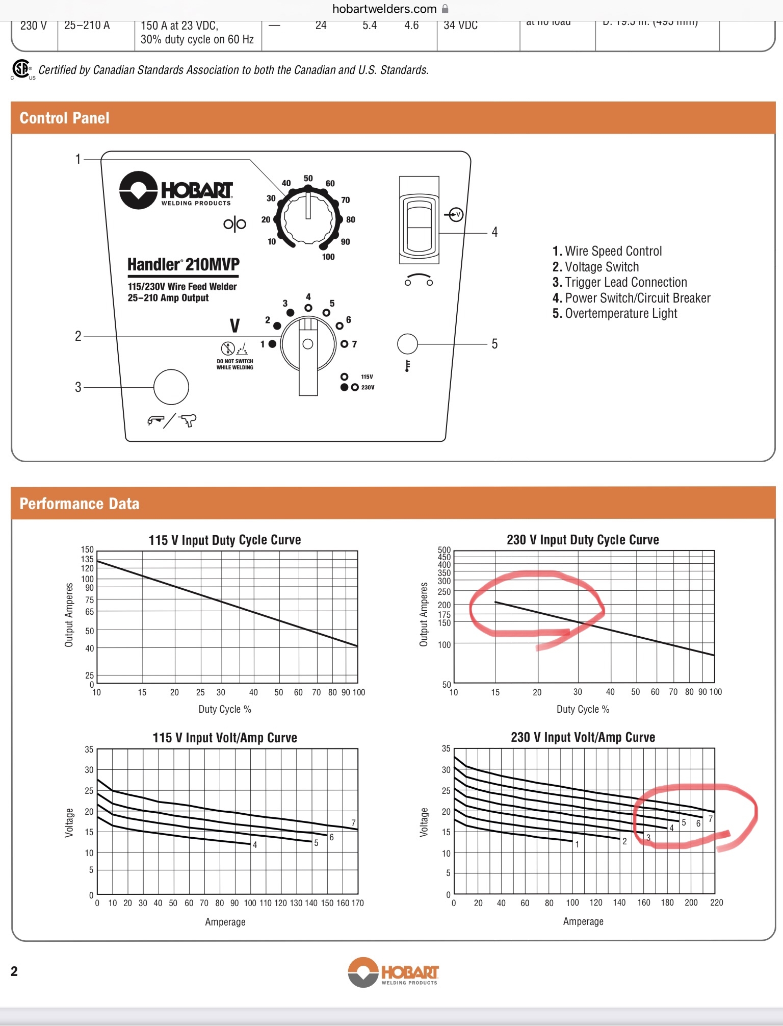

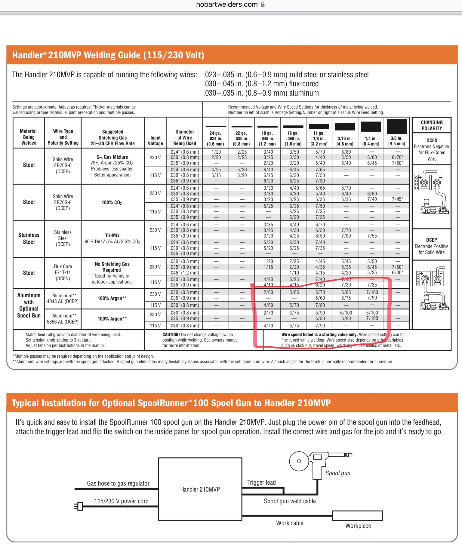

Have you taken a look at Hobart information in the machine. Their window on thickness they are capable of welding is only between .048 and .250” (At 100% wire speed).
Why I asked about renting. It probably won’t take the OP very long to realize the limits of the machine and MIG/aluminum process in general.
Duty cycle gets pretty low on that machine as well, as voltage is also maxed out.
So you can‘t weld thin and if you only have 10 minutes of welding at the higher voltage ranges, it should only take an hour or so…
It will work perfectly fine for my rare and simple needs. I'm not starting a welding shop.
