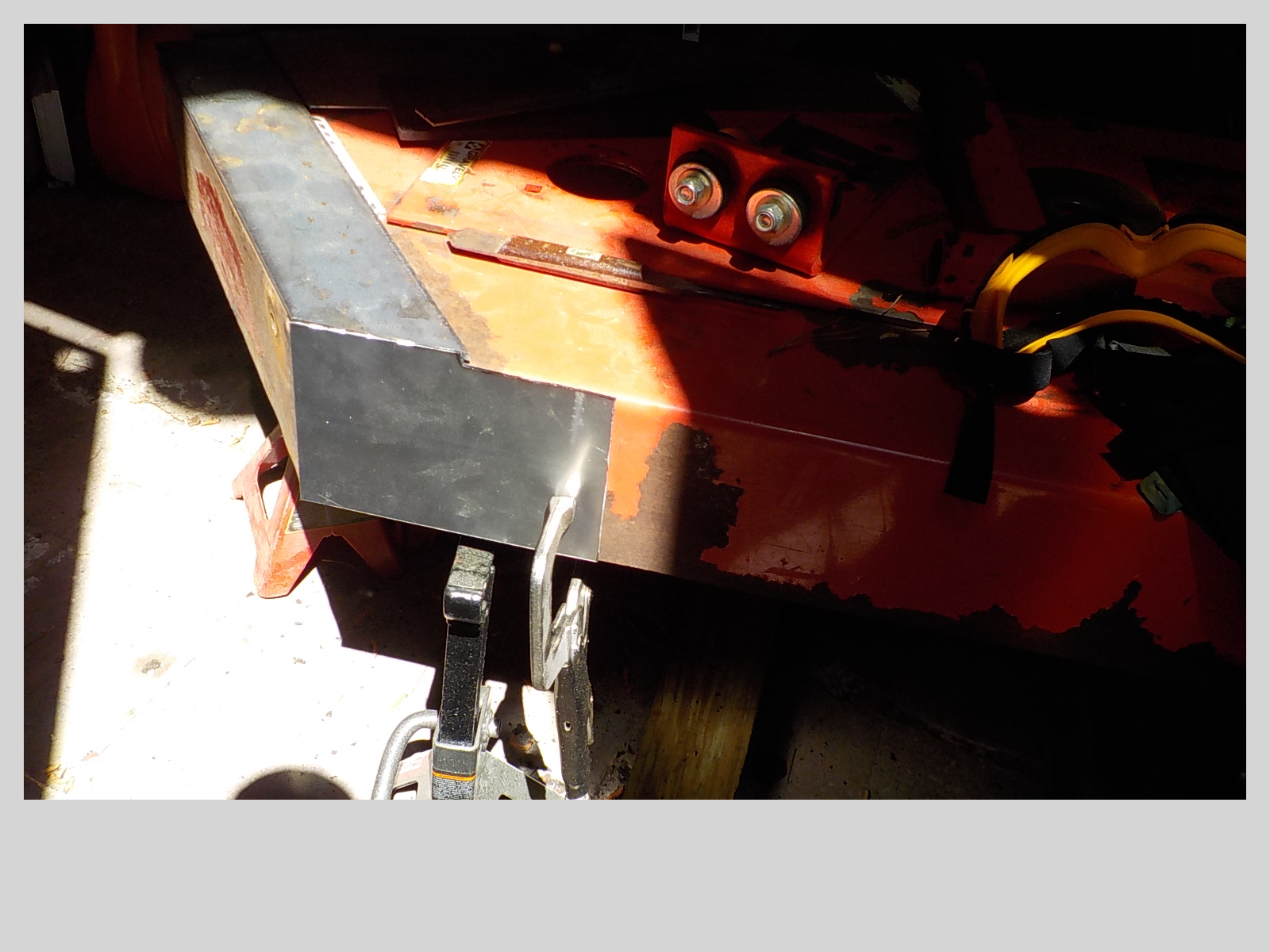

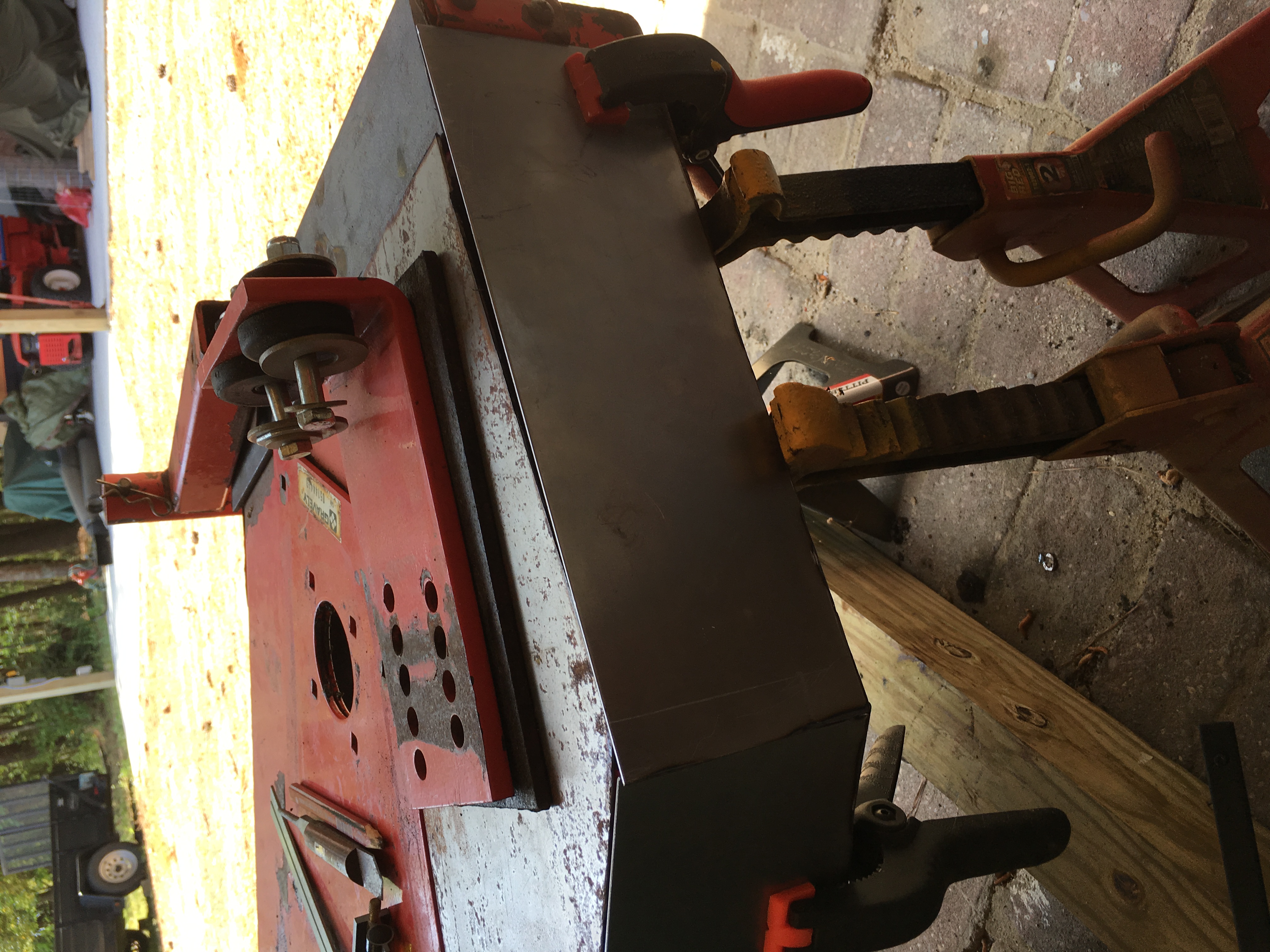

started at 7am this morning and by noon I had one piece welded...no one is ever going to hire me to do this :rolleyes:
of course I had to do everything three or four times, but persistence paid off.

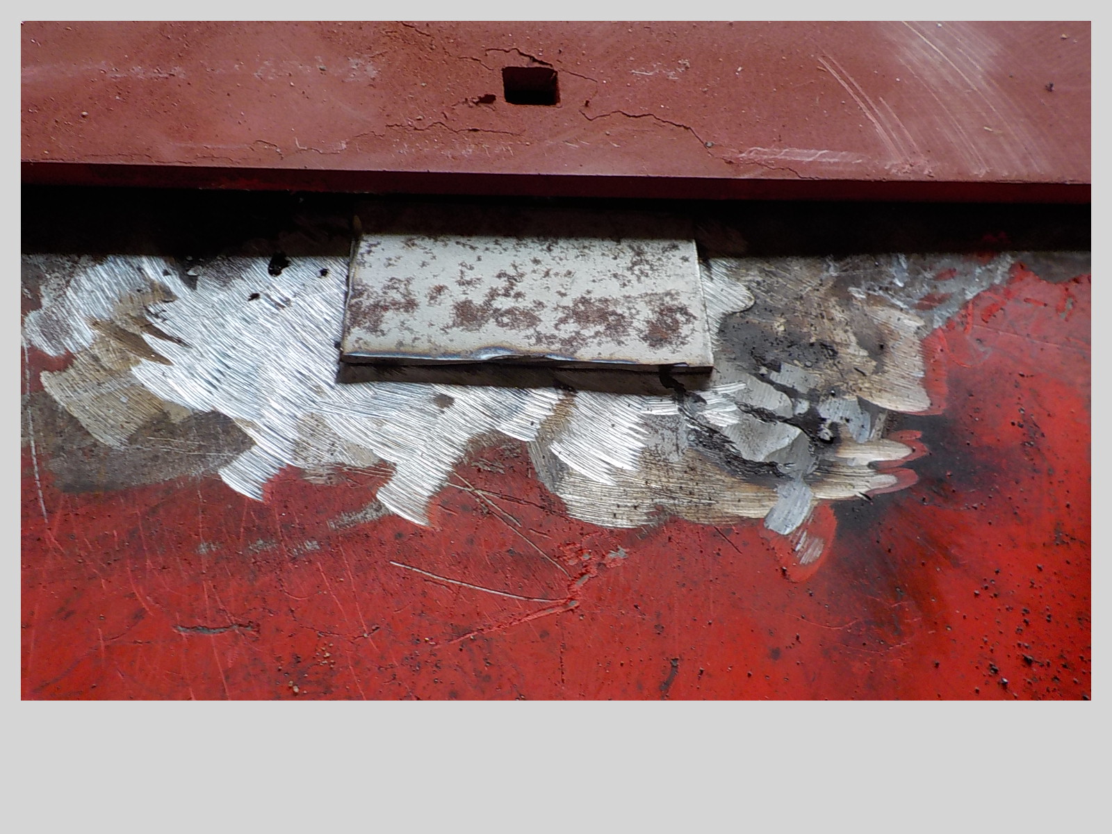

Made a small patch for the one hole I could not cover otherwise, and I'll weld that tomorrow.

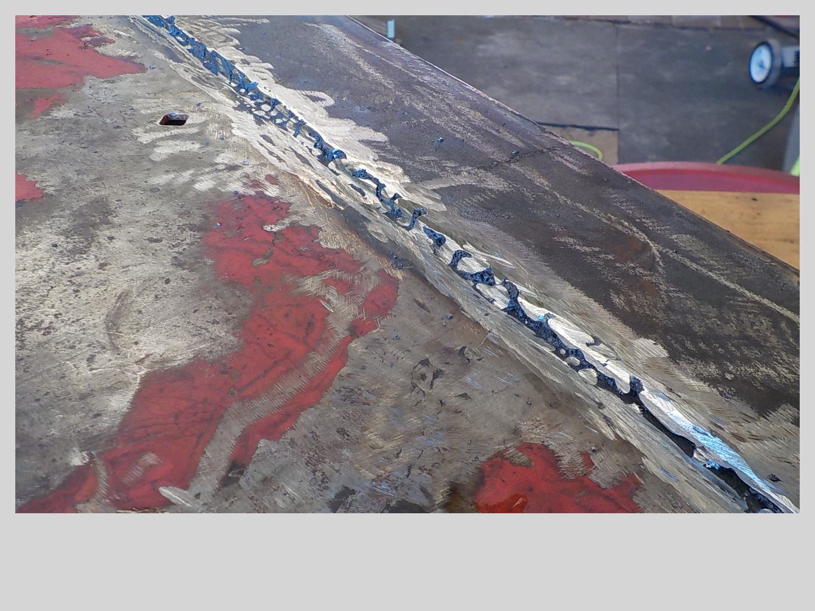

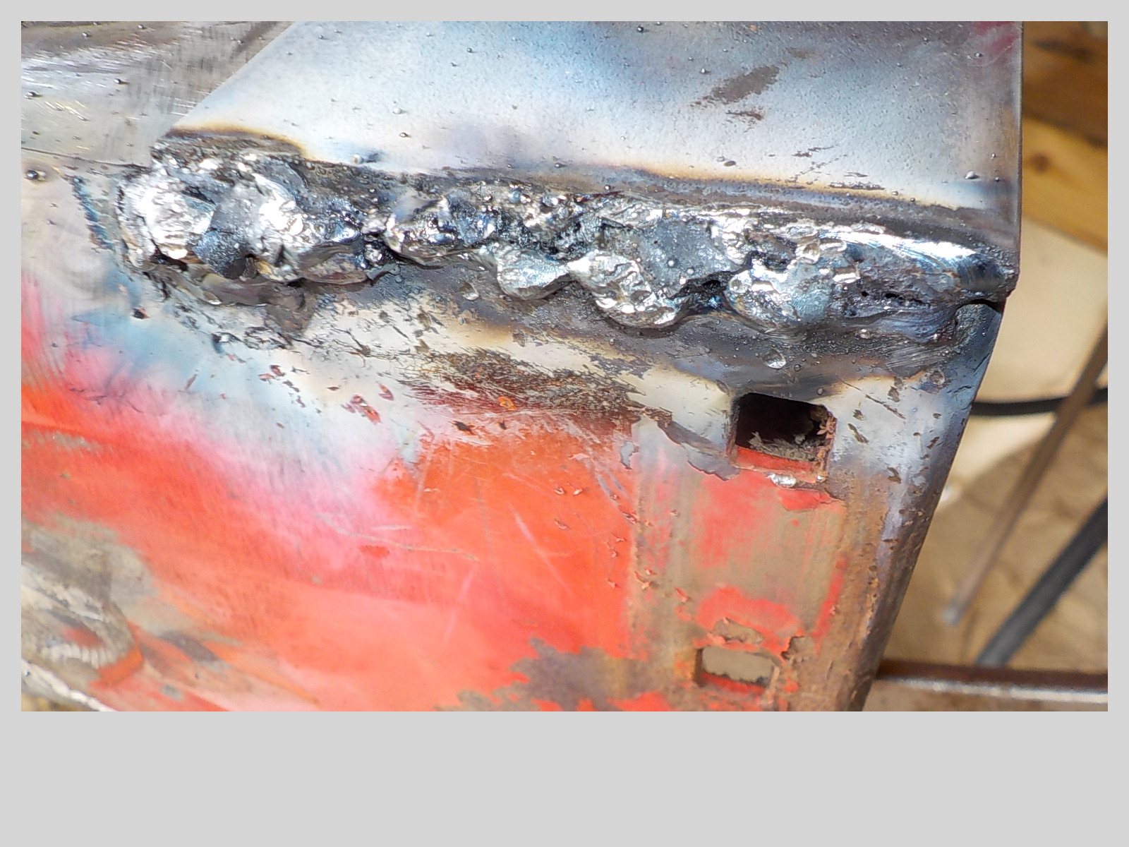

The first picture I believe should win a prize as world's ugliest weld. I mean, it's really ugly...takes a lot of talent to get something to look that bad!
Surprisingly there was some penetration under that glop. Gosh did I grind and grind...but I had more fun doing this because I was using a 1/8 7014 rod instead of 3/32
and it definitely ran easier for me, about 94 amps. And I sucked it up and grabbed the rod with my glove and that did help; definitely harder for me to control a full length rod.
By the third or fourth time I was actually pushing a puddle back and forth. It may not be pretty but this steel isn't going anywhere.

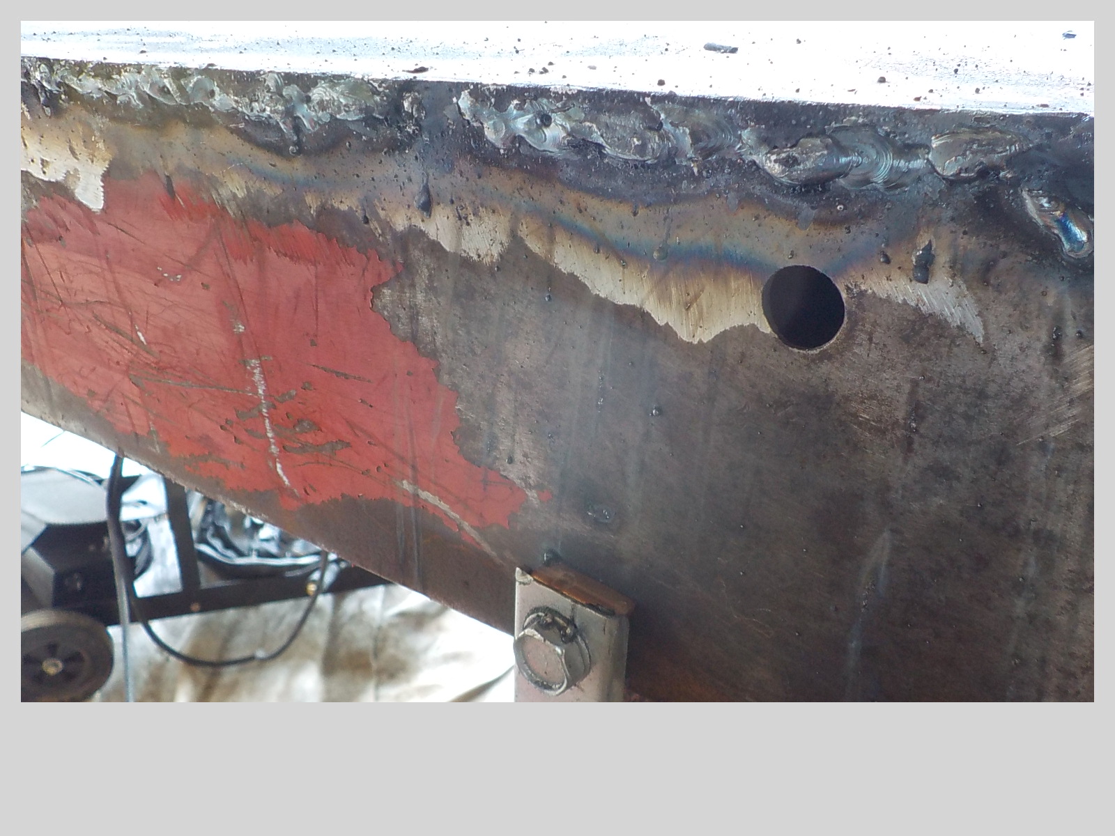

The outside weld was a lot easier than the inside one, not helped due to some gapping due a bent deck. I clamped it in as best as I could but...
The inside weld is too ugly to leave, I'll do it again tomorrow morning, but the heat index was 114 when I stopped.
the hardest part will be getting the bent/ripped deck portion in alignment but I wanted the main support piece in place before I started bending things.
Lots more to do.
the overlay metal is not super thick so I have to be careful with that tomorrow.

Drew - like others wrote, drop down to 1/16th rod. I had the same problem with my welding on my mower deck. I kept blowing holes through it until I got some 1/16 and ran my Everlast 300 almost as low as it would go.
With thicker rod and more amps I'd start to get a good weld then whoops, blow a hole.
I practiced just making a stack of dimes on 10 gauge metal. First try it too cold, then crank it up, blow some holes and back it down a bit.
Praise to angle grinders.

When i ran the heavier rod I knew I could not dig into the mower deck itself very much, concentrating more on the overlay piece.
Which is probably why I have that mosaic of slag all down that weld, which interestingly seems a shade of blue in the light.
I had used two smaller rods first, to be careful, and they just weren't doing it. So I switched up one size and ten amps and that helped.
When just welding that lighter weight overlay metal, I think I'll get some of that 1/16 rod first and try it.

Think I might make that one patch bigger. The whole area is in poor condition; thinking of getting the edge of the patch into safer territory.
So how does one make a patch look nice? ...not going to happen. I suppose grinding down the edges a bit would help.
/ Welding Rods for beginners #151
That's what i was suggesting above. Plate-over the weak/thin areas and weld to more consistant thickness steel.
Appearance? Don't grind it much. Leave it 'obvious' and solid-looking. It's a mower not a Michalengelo.

The first picture I believe should win a prize as world's ugliest weld..
I can run uglier welds than that with both eyes open and no hands tied behind my back!
