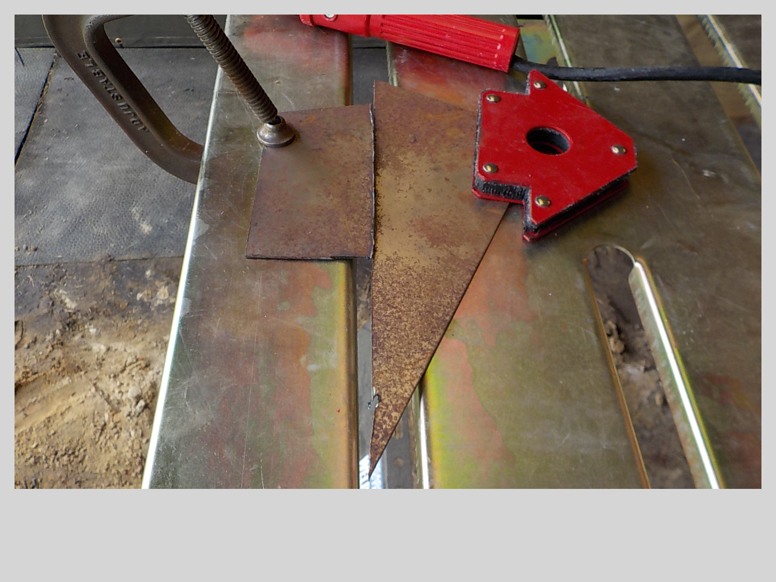

This steel is 80 thousands think. I don't remember the rod size I used but it was smaller than 1/8". The first 1" in the right was 80 amps where it burnt through. The rest was 60 amps. I welded the other side with an 1/8" rod at 60. IMG_9624.JPG
/ Welding Rods for beginners #184
"telling me things aren't right is more helpful than poking fun" - You're right -
Stick Welding Calculator - MillerWelds
Choose mild steel, and 1/4" 7014 - "Suggested Amperage Range: 330-415"
If you're at 90 amps I'm pretty sure you're using 3/32" rods... Steve

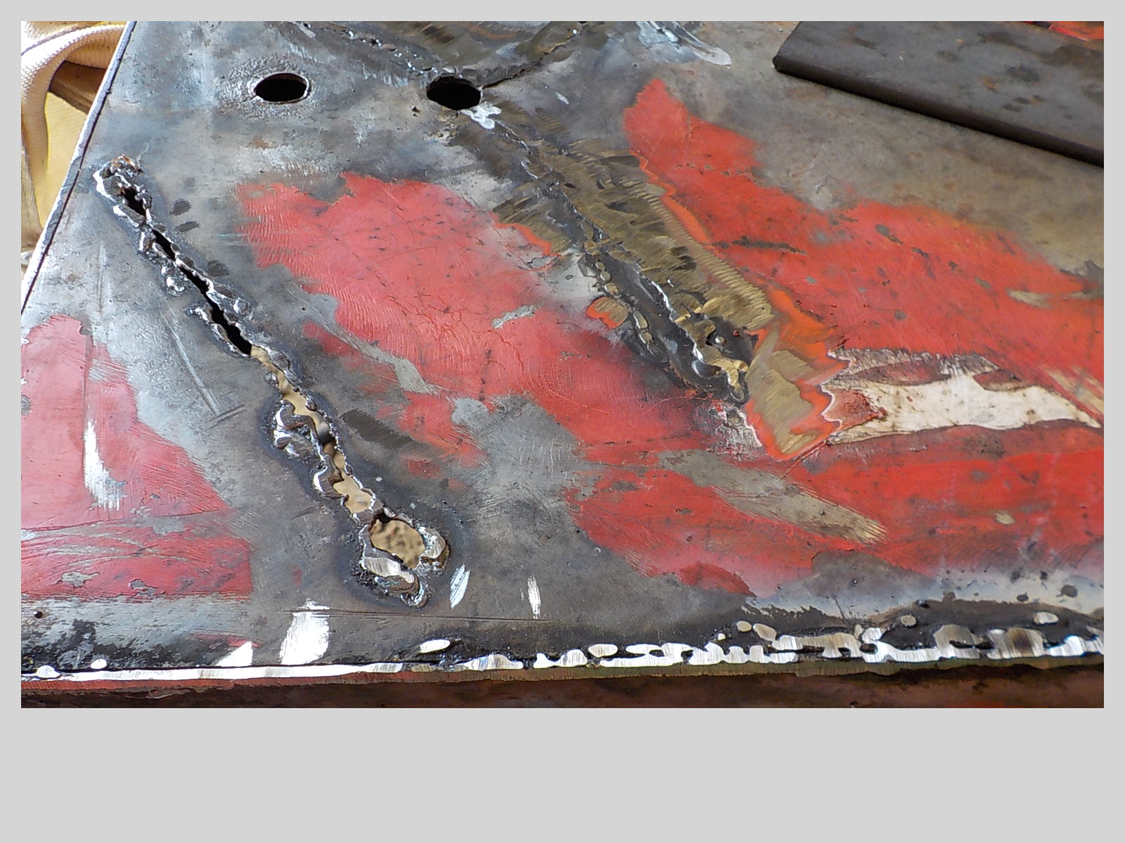

I finished the mower deck today, slowly getting better at this. Still have to make two or three passes, and certainly
a final one to neaten things. Used 1/8 rod at 115 amps after trying one size smaller. That seemed to work well for me.
Paid special attention to underneath lip.
Again surprising how nice filler primer can make things.
Now on to the frame. More heavy metal there.

Now to the mower deck I would have used a 6011 3/32 and would have done a vertical down, this allows the heat to move straight up and away, Now I am a fast and hot welder, I would not Vee the crack out as this actually makes it harder to welder as it makes it somewhat thinner I usually never vee anything less that 1/8 inch. When welding two different thickness of metals there will be the parent metal which is the thicker of the two. Always favor the thicker of the two or concentrate more heat to that metal.

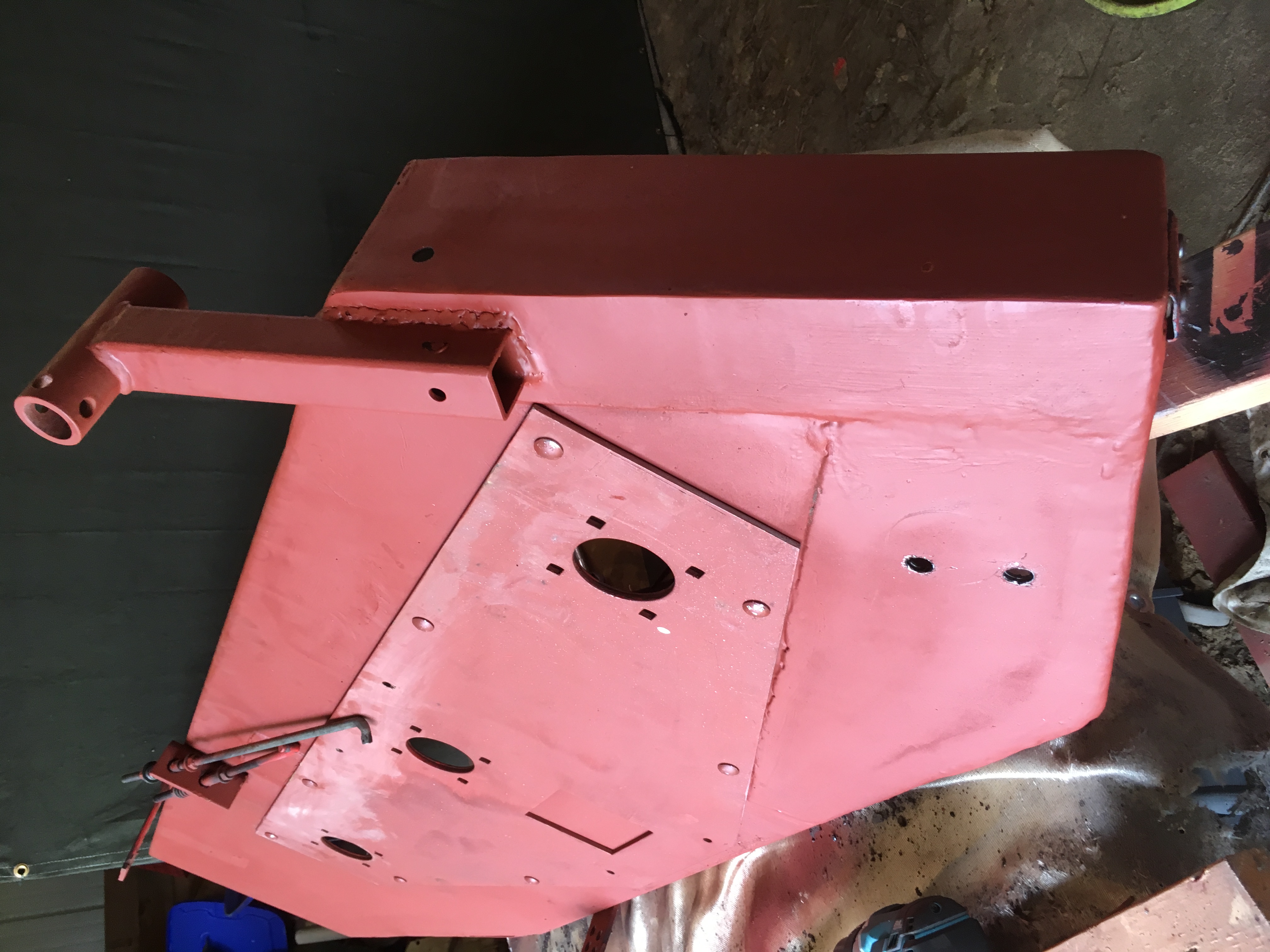

finished all my welding today. Built a new hanger piece to replace the one that had ripped off. First had to cover the hole, then welded the new piece on top.
1/8 7014 at 115 seemed to work well. Still ugly. About four more layers of filler primer it will look almost respectable.
Now a huge amount of hand sanding all this primer, and I start to paint.
It will be shiny paint over a bunch of bumpety bumps but the job got done, and it was a wonderful learning experience.
Now I would like to try something perhaps a little easier than stick, something that doesn't create all that slag I seem to
create. So...time to get a bottle of argon and start a new thread.
thanks guys.
oh, I spent a lot of time welding the underneath of this hanger tab; the oem ones aren't welded at all underneath.
Shows that whatever they used was strong enough to have metal rip out.
