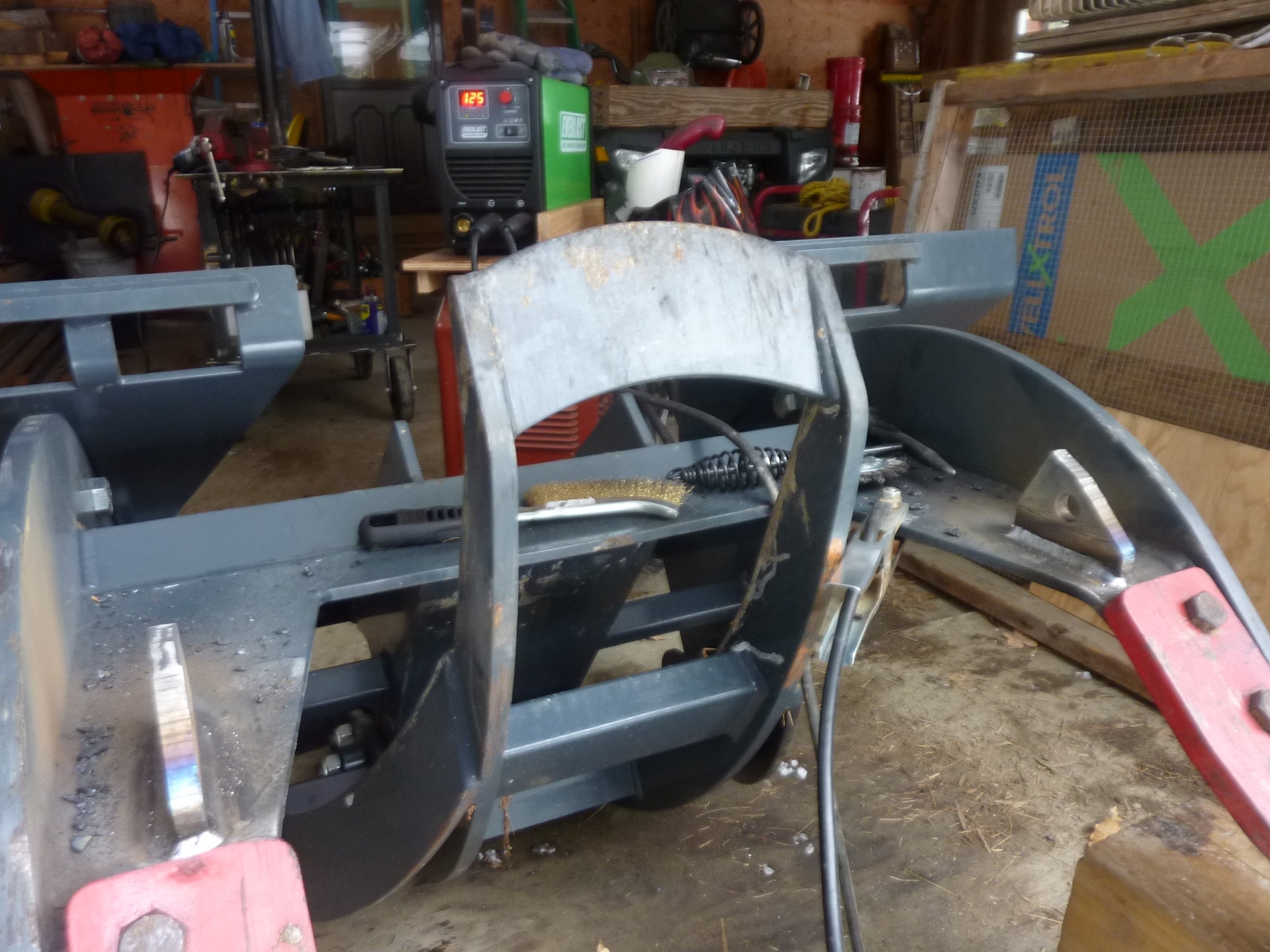

My 200STi says it will do cellulose rods. Next time it's fit to be out working on the scraper blade project I'll experiment a bit. When I bought the Everlast I did pick up a variety of electrodes to try at the hardware store. There's one canister of 6010, 6011 and 6013 of different diameters that I don't remember much about. The 7014 has been working so well the others have been largely ignored.

The post above yours is a clip from my Everlast 200STi manual and it includes mention of 6010. Below is a picture of the front of my welder showing the button referenced in the clip.
One of my rod cans has an assortment that I haven't taken the time to test drive because the 7014's have been doing well. It has some 6010, 6011 & 6013. I'll make it a point to give them a try and post the results when I have time. My welding is done outdoors and right now if there's a good weather day it is used to make progress on refurbing an oddball 7' rear blade.
