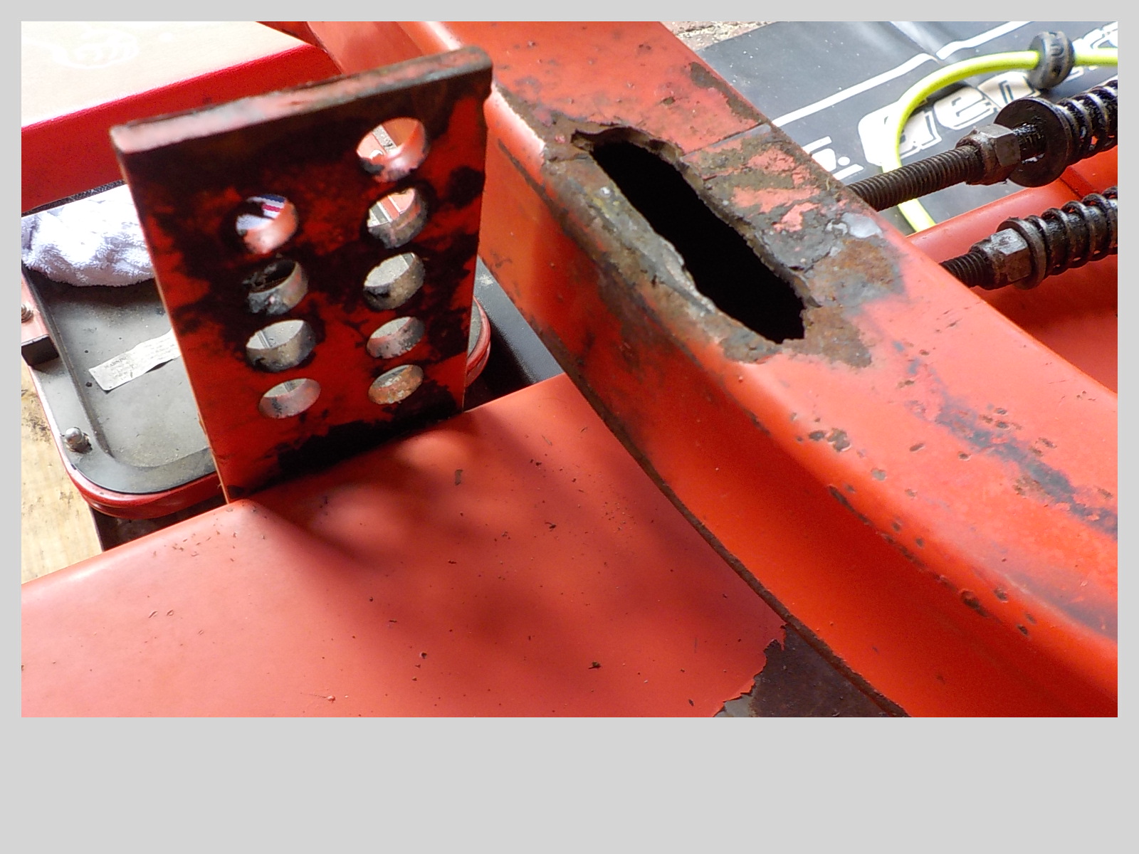

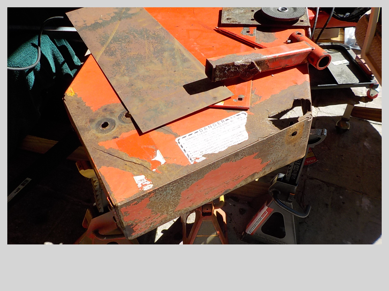

I am learning how to weld in retirement, and have a mower deck project I am cutting steel for right now that will be part of
my learning process. I have watched the YouTube videos, got a big Welding how to book, and also have all the hardware and tools.
My machine is an everlast stick tig, 160 something, about four years old, bought from vendor here and never used due to family
emergencies. Now I have time to learn to weld, and know that I have some training welding to do. I bought some rods years ago for this, and
when a friend/pro welder helped me fire up the machine for the first time, it welded quite nicely at 85-100 amps using a 7014 rod.
So here's my primary question. I have two boxes of 6011, two boxes of 7014 and one box of 7018.
What should I have as a basic supply?
At one time I knew why I bought them...the characteristics etc. I'm doing very simple steel welding.
Once I learn stick I will likely try the TIG half of the welder, all the parts including the foot pedal are here except for the gas bottle.
I'm not going to be welding aluminum or stainless steel. I have done a lot of soldering and understand molten metal but this is clearly
a different process with different rules.
To begin with, what should I train with on moderately clean steel?
thanks Drew

thanks. I haven't even begun to prep for welding, the pics just show the "before".
Have a Dewalt hand grinder and expect to do a lot of cleaning first.
Strong believer in importance of prep based on a lifetime of painting and seeing the results
of various degrees of prep.
is there a solvent/cleaner I should use on steel to be welded other than paint thinner and then denatured alcohol?
That is my usual approach after a primary degreasing.

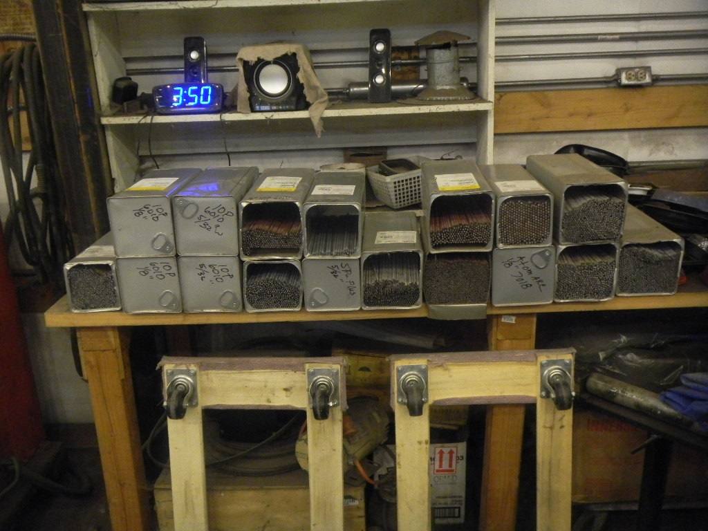

/ Welding Rods for beginners #8
Majority of the rod I keep on hand is 6010, and 7018. I do have some stainless steel, and aluminum rod too.

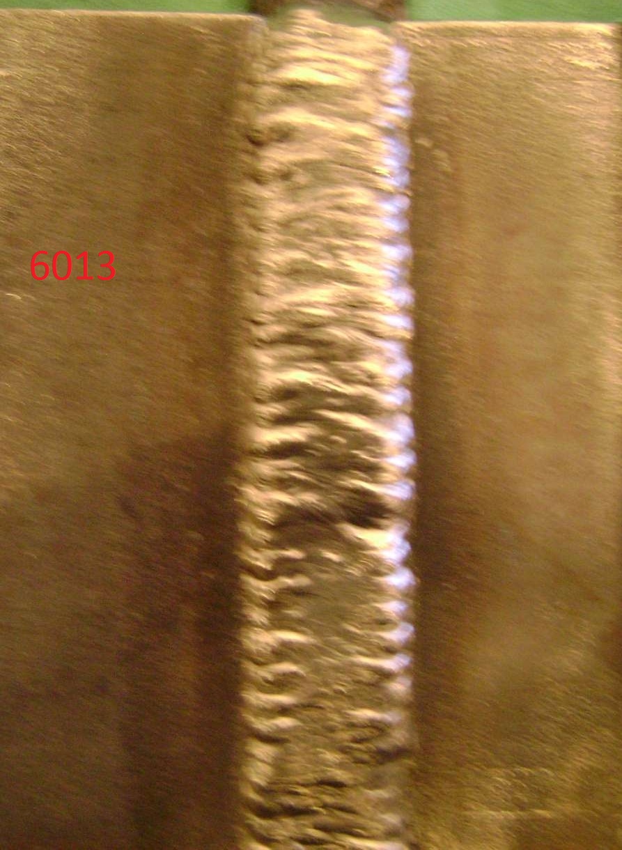

/ Welding Rods for beginners #14

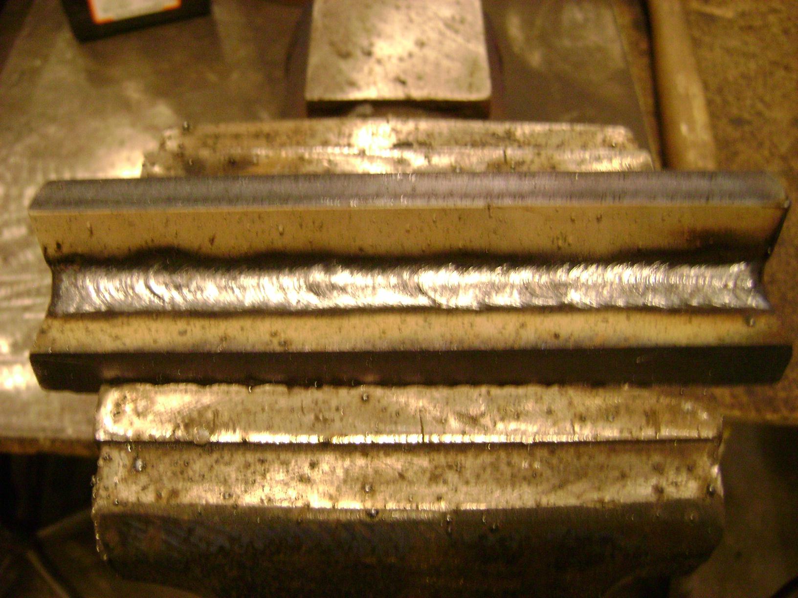

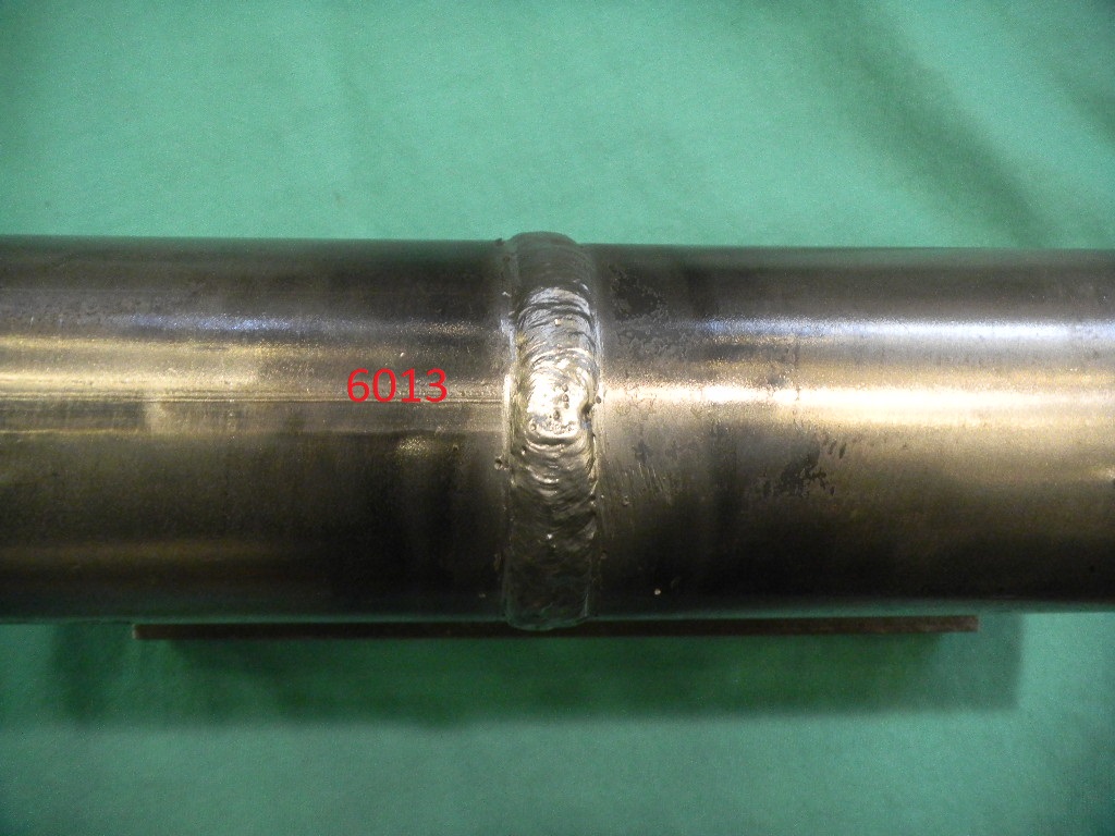

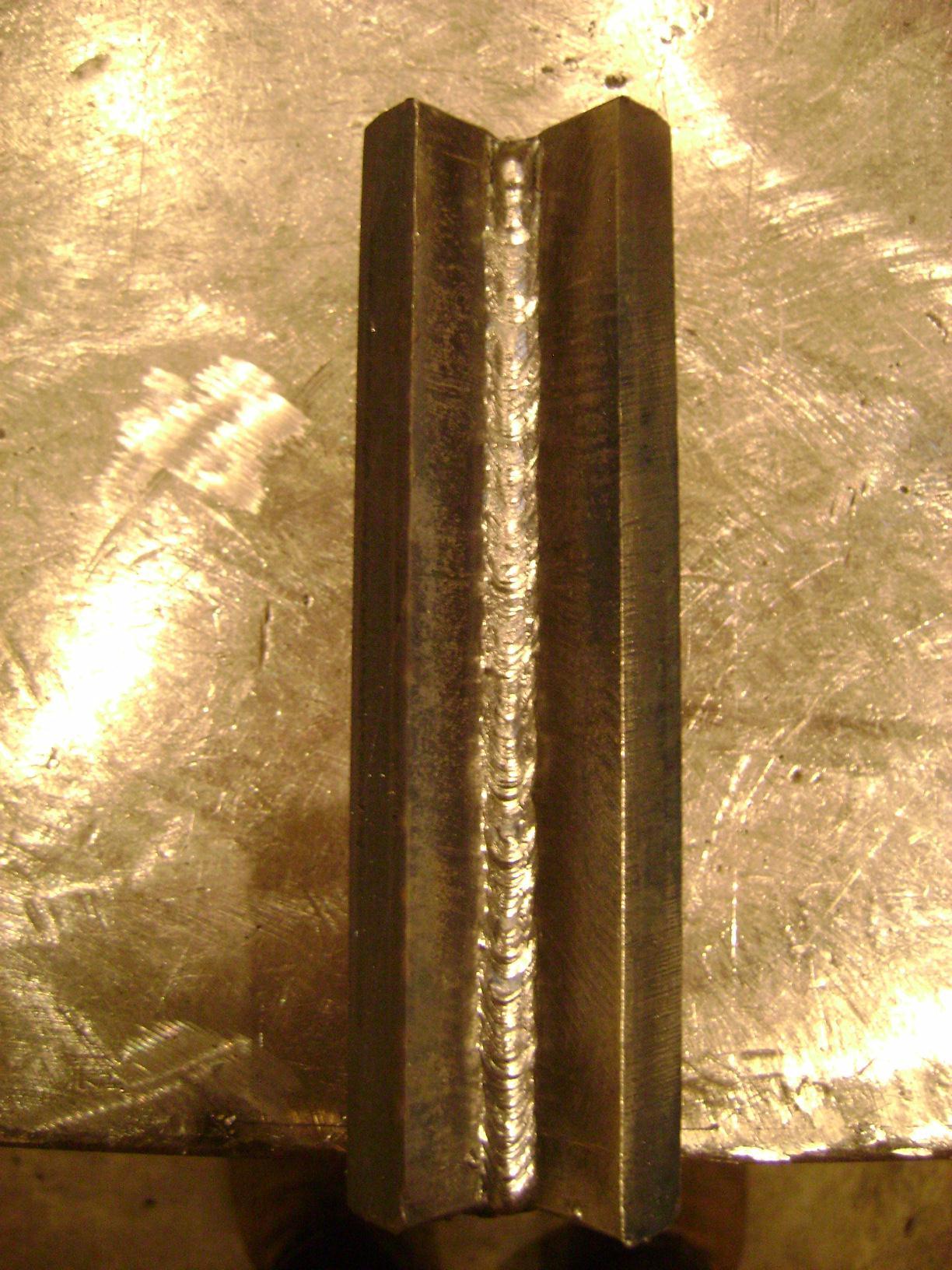

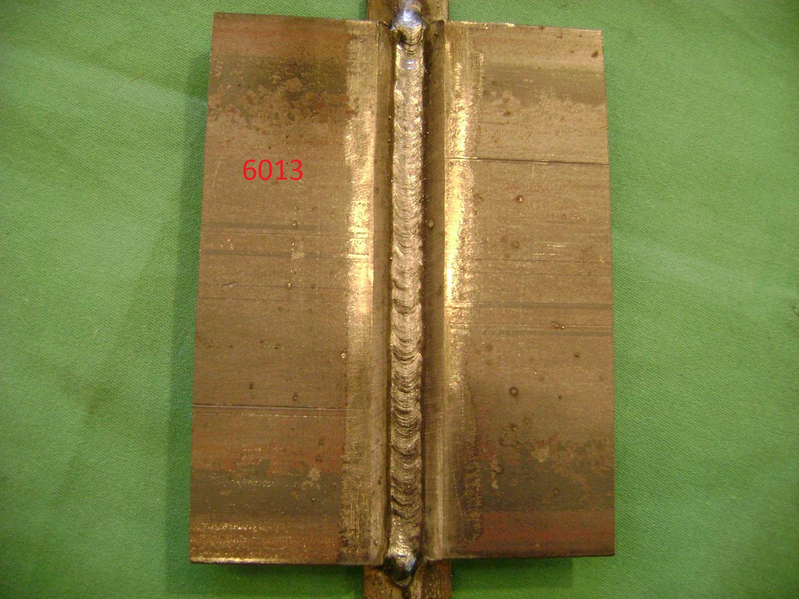

daugen here is some 6010, 6013, and 7018 welds.
