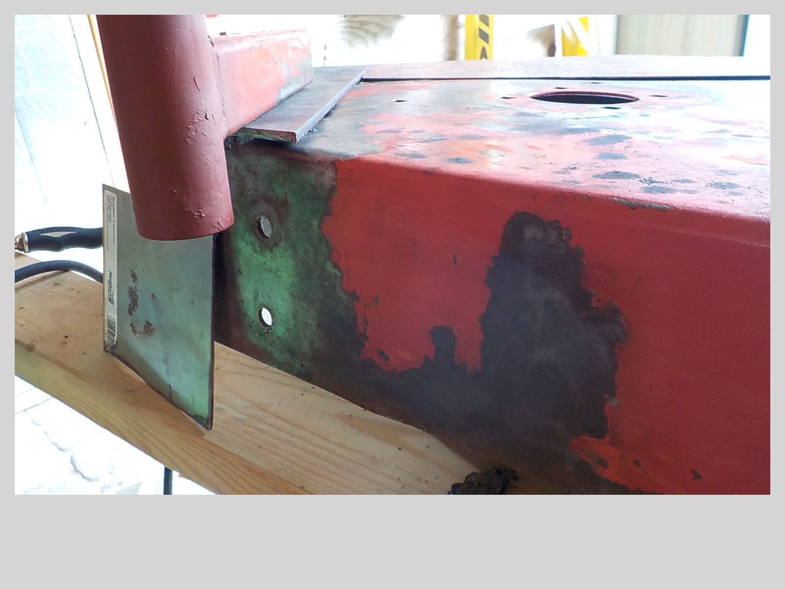

I already have that and a foot pedal but no gas.
wanted to learn on stick. I can always turn the whole thing over when I'm done recovering that area and fix it from the other side.
I can also clamp a piece of metal underneath where this hole now is and attempt to fill it from the top.
I'm just starting...
thanks

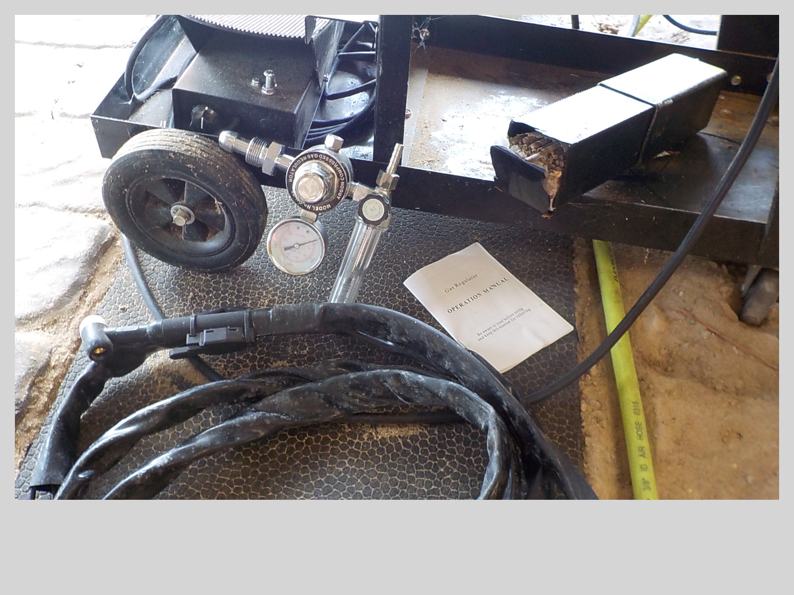

OH, I didn't know you had a torch and valve..OK then.
/ Welding Rods for beginners
#103
combi unit, Everlast 160 something
no, not sure I have a torch, valve yes. Lines yes. Foot pedal yes.

Yep, of all welding methods, filling holes, on thin stuff is the least desirable.
But you at least have chosen the same rod I would have.
Certainly don't try to close that all in one pass or you will just keep making it bigger.
Move fast enough to prevent burning metal away. What's deposited is deposited and it will get smaller with each passing.
Trying to fill a gap like that, the tough part is getting slag trapped in the thin crack. Everything will look welded until you chip slag. Gotta make sure you get all the slag cleaned off before next pass. A needle scaler is a great asset for stick welding

without a doubt I would attack it with the TIG too, but given what he has, would you make some recommendations for trying to get those holes closed with stick? I would try to do it with 7014. But you have a lot more experience than I do.. what say you.
Well first off, I wouldn't have even attempted it with stick! Being a structural welder. I've never been good at welding thin material. There was a time in my life, where I thought 3/8-inch steel was sheet metal.
To fix that now, I would use a copper flat bar backing. And a 3/32-inch rod. 7014 or 6013.

I thought I was doing pretty well for a newbie, until I wasn't...
ok, I actually feel a little better that welding thin steel like this isn't so simple.
I'm going to put another piece of metal there, underneath, to create a "floor" of sorts, since the top has to remain
level and smooth to get the reinforcing plate over that area.
am looking forward to another shot at this today. Will start off practicing a little more.
Slowly and patiently...

Easy fix with a 1/16 6013.
/ Welding Rods for beginners #110
I would Tig weld the cracks! ;)
Yeah, I have found that when using TIG, you can "follow" the crack as it magically grows longer than you imagined it to be! You can certainly find the end of it (then no holes required!)

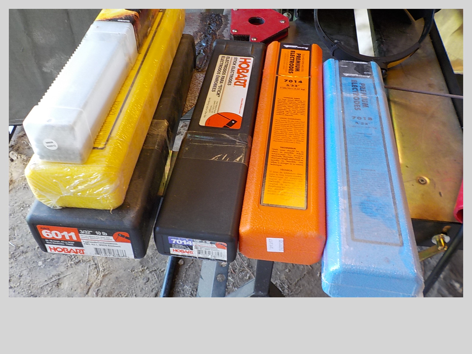

got sidetracked with field mowing this morning but got that done, maybe this afternoon when it rains, if it rains, I'll get a chance to go
back to it. Took stock of my rod supply, about 13 pounds of 6011 and 7 pounds of 7014, both split between 1/8 and 3/32
Not that I can't buy something else for this. I have more pics, need advice on joining different size metals, so let me post them later, now

With stick, to fill a hole with a fill freeze rod, keep it buried. That helps keep the slag chased out.

here are some pics of the steel going over this area.
And part of what I'm dealing with involving big gaps
One area needs to be pulled into alignment, then tack welded, then get all the clamps
out and weld it properly.
in for a penny, in for two pounds
I have two of these wing mowers. One is already welded and fixed and just needs refinishing. This one was in such bad shape the dealer said two for one.
So this is the one that would have wound up in the scrap heap somewhere, so as long as it doesn't look like Frankenstein when I'm done with it,
the net of all this is positive. Besides that Honda engine runs fine. The thinness of this deck is clearly evident in the one corner where there are two little holes that look
like metallic moths had a party there.
and a pic of the welder, the accessories I have and the rods in stock.

daugen you need to pick up a bottle of argon for your Tig welder. You will be surprised how much you will use it. Especially for small projects. :thumbsup:

I know what you mean, was in the high 70's here today, yuk. You have a good selection of rods, my favorites, but me thinks that repair work is better suited for a small mig welder, with .023-030 70s6 wire, that will keep you from overheating.
