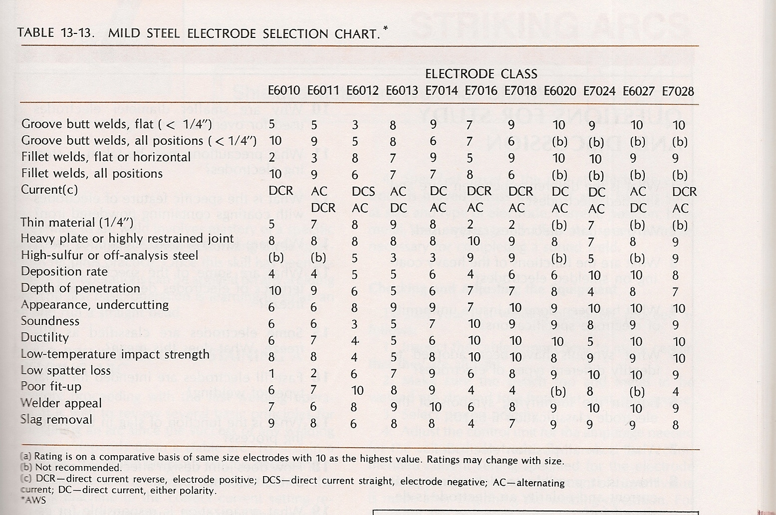

Now a ? for the welder extraordinaire on here, what do the numbers mean in 6011 and 7014 or which number means All Position?
The second to last being a "1" is all position (but not necessarily vertical down)
A "2" in that position is flat/horizontal only, such as a 7024.
This chart from AWS may be helpful as well:
