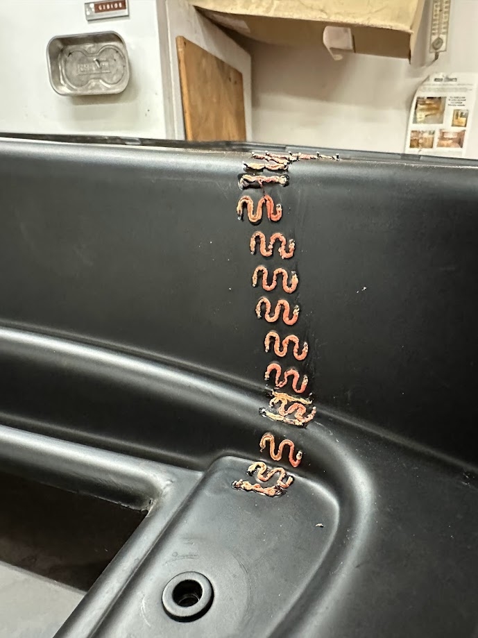

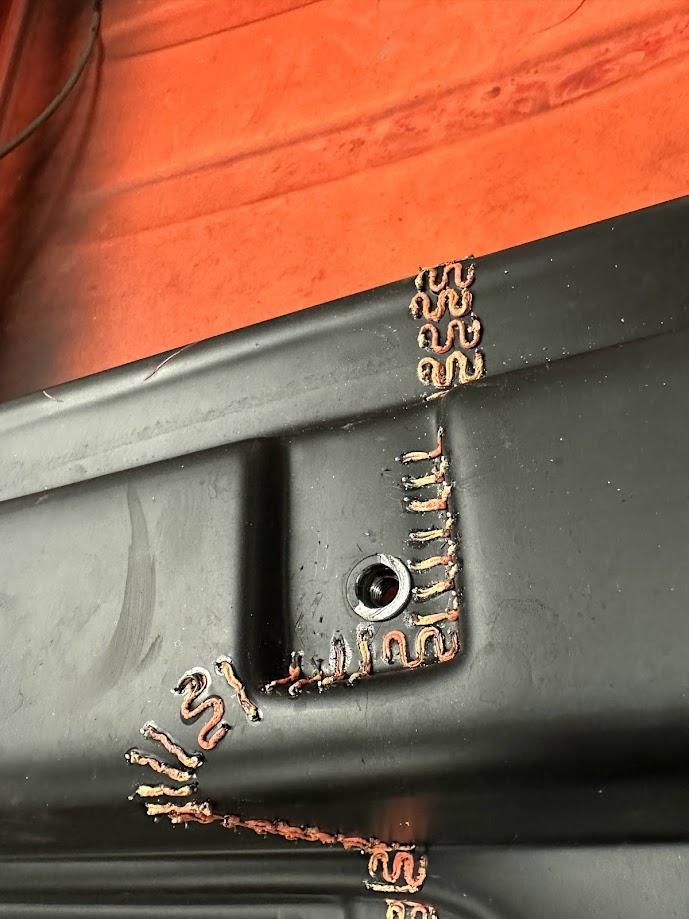

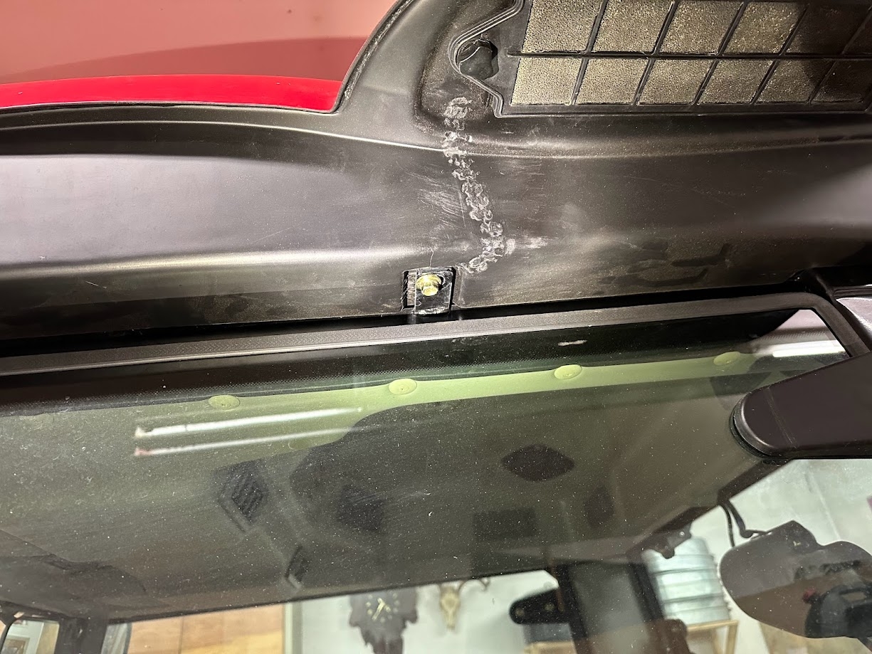

I bought a hot stapler kit for around $20 and have used it to fix bumper covers, fenders, wheelbarrows, and an ice fishing sled. None of the repairs has failed. A few friends that have body shops now use them to repair headlight housings, was actually recommended to me by one of them. Car bumpers used to be ABS, now most are ASA.
   / Welding plastic #35
This is me fixking my cracked cab over winter after it cracked in -40F. Using plastic welding staples.
