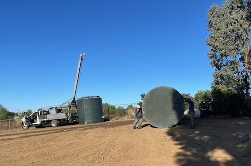

I have a 200w amazon kit Amazon.com
Repaired a large in ground valve box that had been split and discarded when run over by a truck. Worked good. Looks like getting nice finished results might take some serious practice, sanding, painting, etc.
I used paperclips for stitches. Simply push them into the material across the break with the hot iron then weld over them.
My plan is to repair a leak in a 4k gallon water tank.

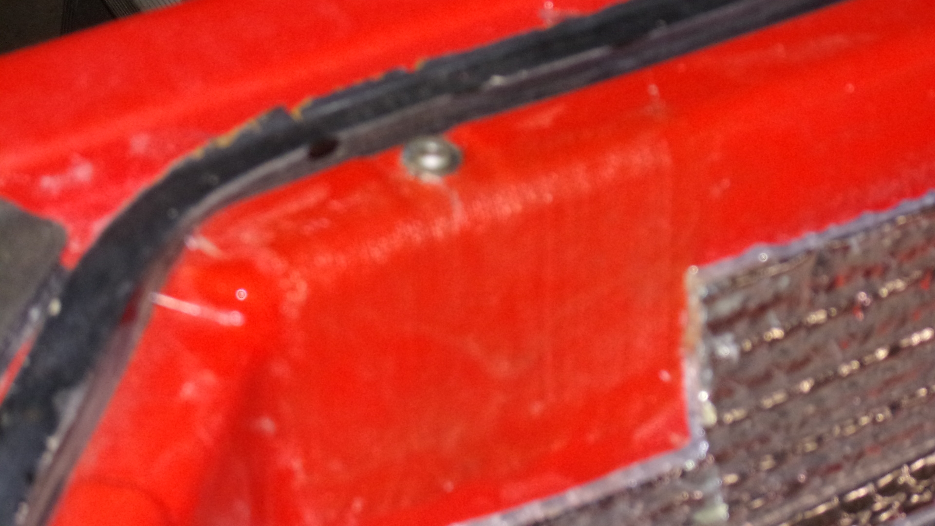

I have a cracked fender extension on my M9 open station (bought it that way) that I need to fix at some point but I'll use fiberglass mat and resin on the underside and sand and paint the now cracked area.
Works good for me. In fact that is how I secured the OEM Riv nuts that got loose in the roof of my other M9 and strengthened the stress cracks as well and the roof is blow molded plastic.
