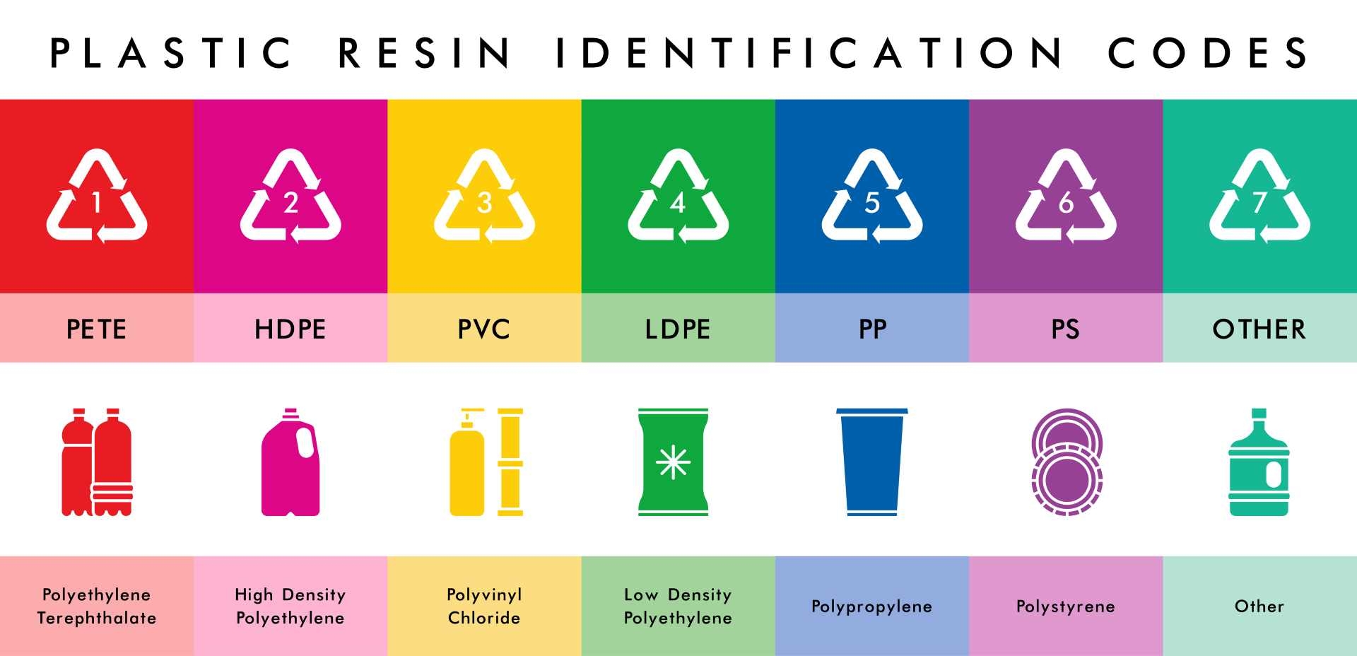

Should show something molded into plastic ID, like these

What tractor? You show 3. I think 'yomax4' is most likely correct that the fender is made of HDPE. A good reference to id what kind of plastic for me is Identify Plastics.
