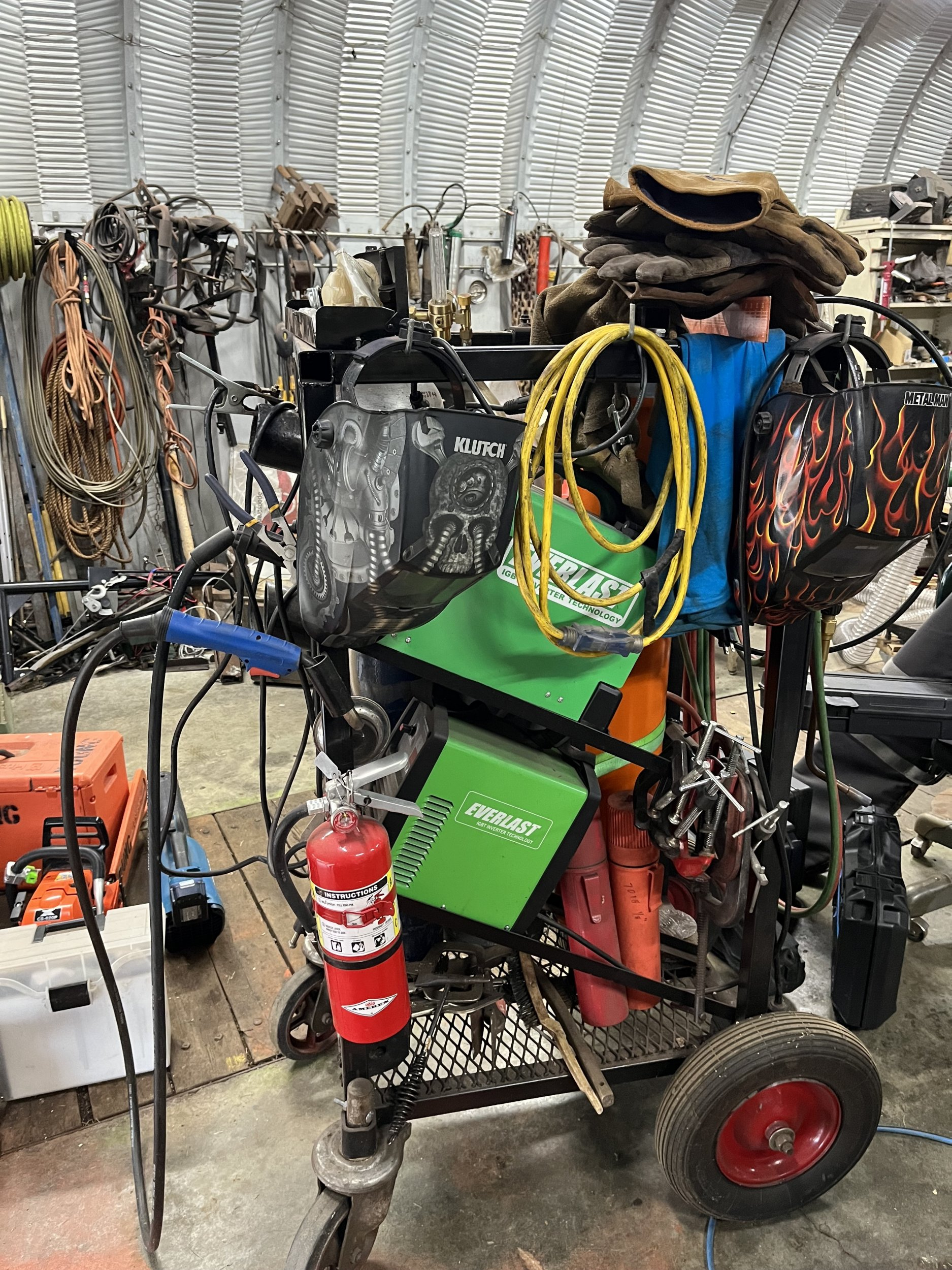

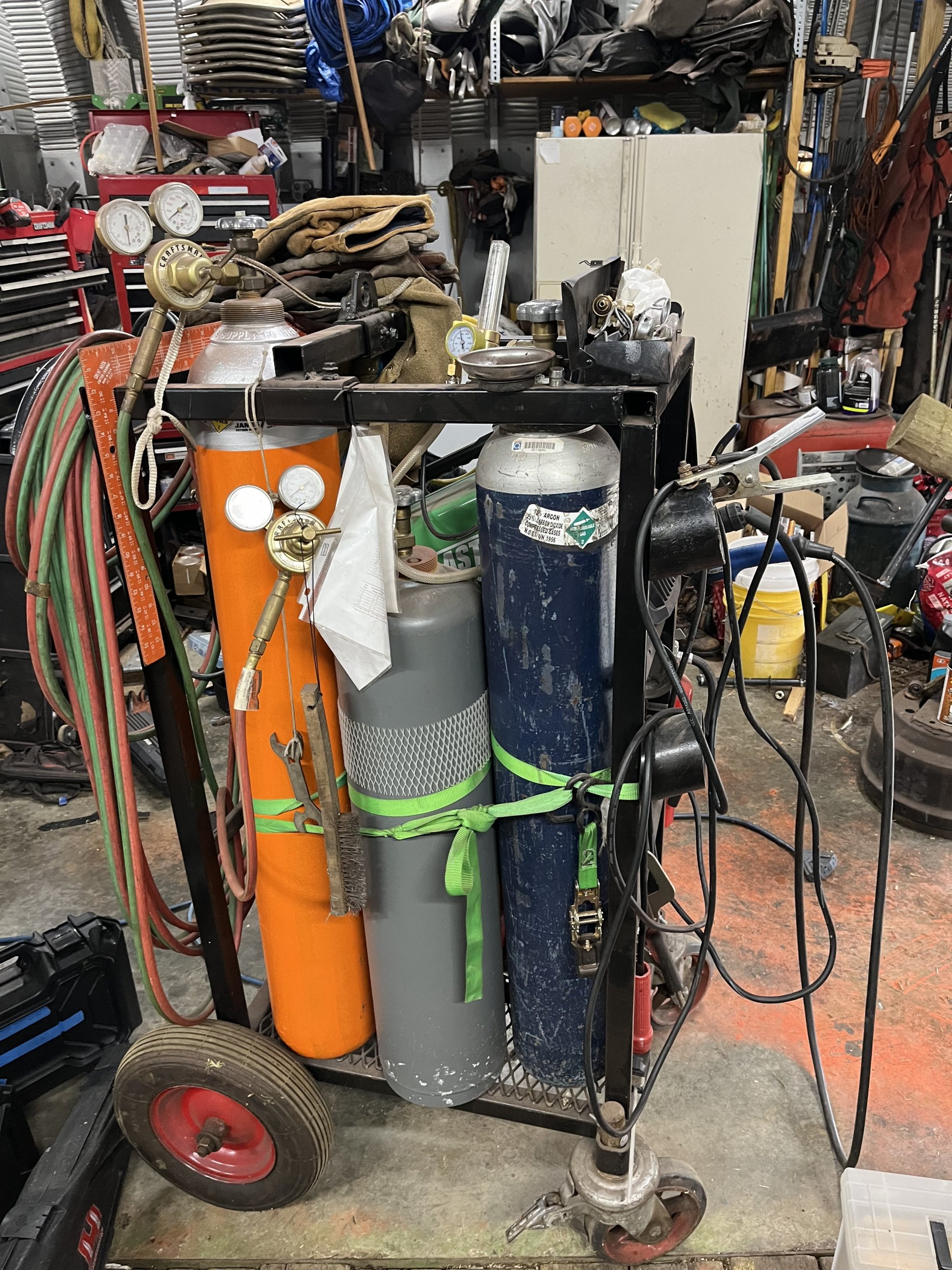

Here are a couple of picture of my welding cart. Holds an Everlast stick and a MIG welder w/gas, plus ox/acetylene tanks. Has a bar for hanging clamps, holders for the cables, hooks for helmets. Made out of 2" tube, the large wheels are foam filled wheelbarrow tires, front swivels are scaffold wheels. There is a lifting point on top where I can use my motor lift to put it in the back of my truck if needed. Rolls on concrete very well, possible but harder on gravel or grass. I have enough 220 volt extension cord to get about 50' from the shop. Only thing I think I will change is a bigger box to hold tips, starters. Of course I copied ideas from here.
