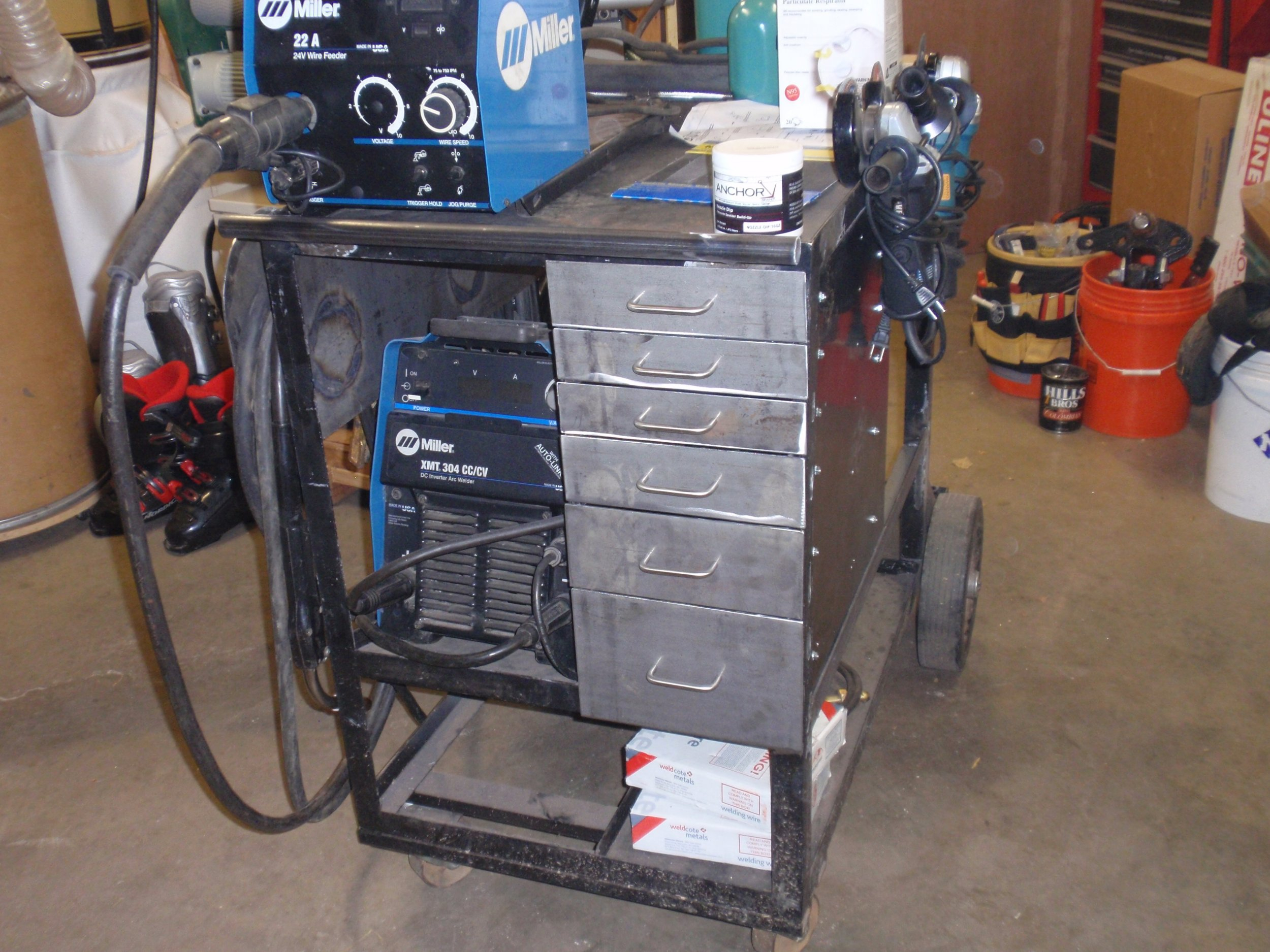

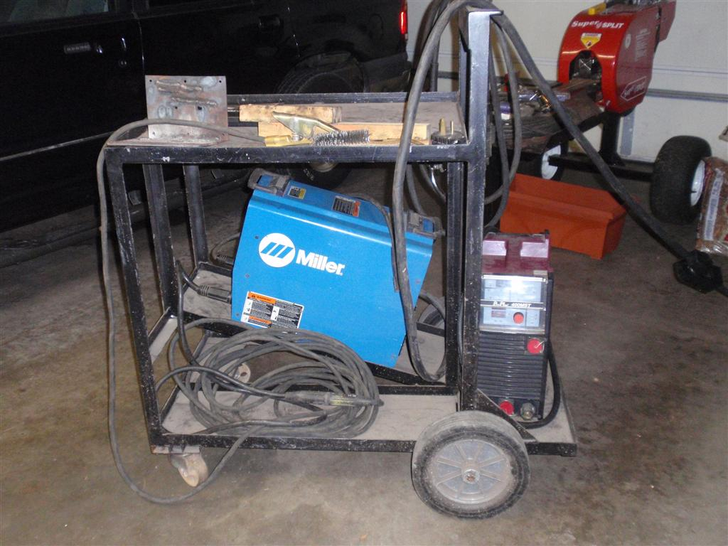

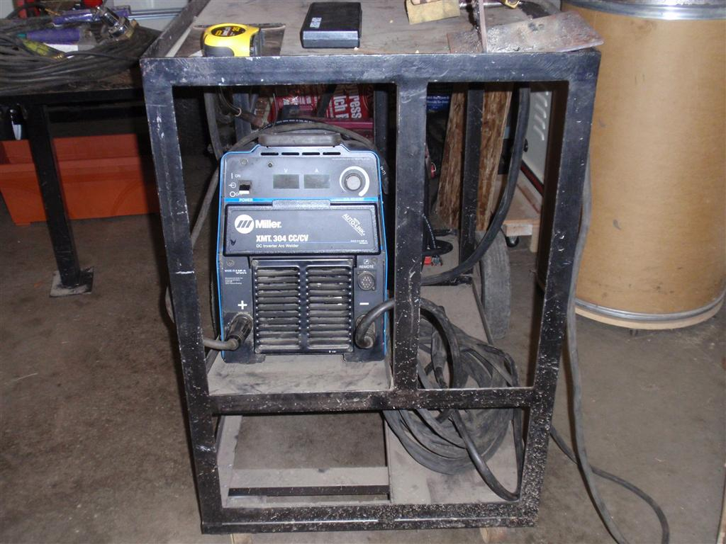

I figure I might as well show my cart. The cart came with the welder at auction (the XMT304) but I added the drawers and cable holders and redid the tank rack to hold three 120cf tanks. Making the drawers was a challenge and I am rather shocked they came out pretty good.
Before photos:
And after:
I never did paint it, beyond the black paint it had originally.
