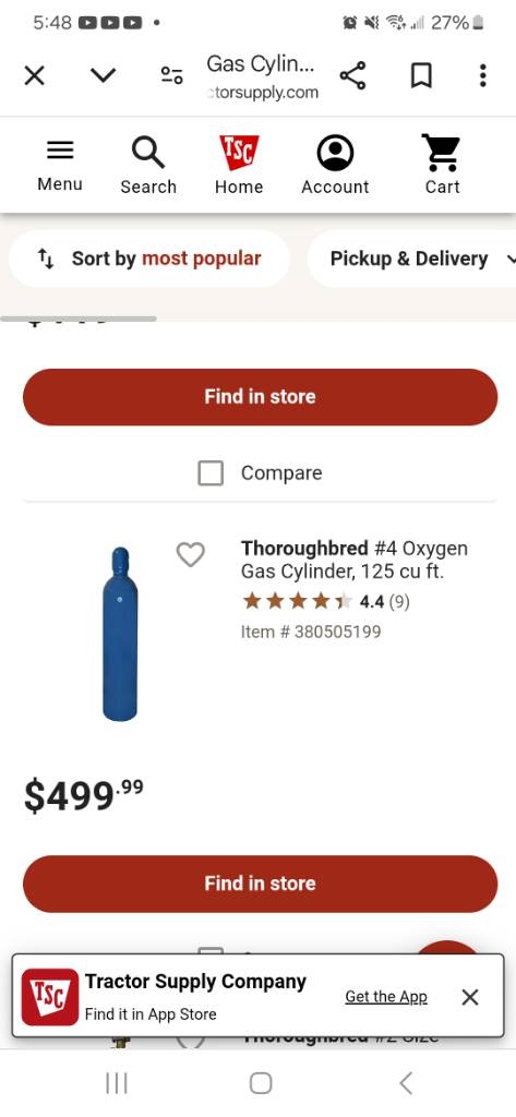

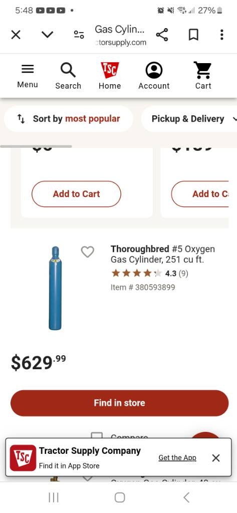

I have one each oxygen, acetylene, and argon mix bottles I bought many years ago at a local welding supply when I lived in Idaho. I ran into problems trying to refill them here at Airgas in Lexington, so I ended up swapping them out at TSC. Had to pay a "certification" fee with each one, but it got me going. I trade them for filled bottles as needed. Price isn't all that bad. If I were you, I would scout craig's list for used bottles and go that route. I see them come up from time to time at reasonable prices. TSC wants like $500 each plus for outright sales.
/ Welding and OxyAcet gas... where and how to get it, Lexington KY. #28
If you go this route, make sure to talk to TSC, cause their training manual says they can do that, but locally they say they only take their own Thorughbreed marked bottles
