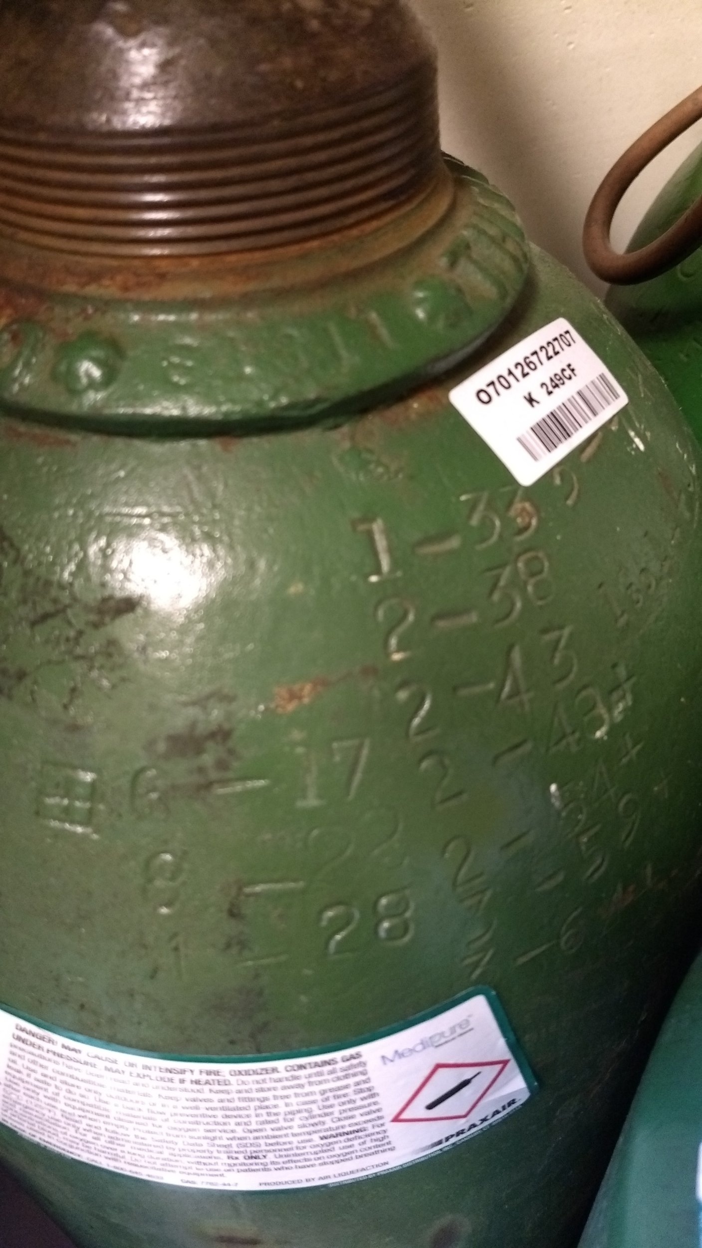

I just got a 3 in 1 Vevor Mig/Tig/Stick welder, and kinda want to try some Tig. I need some 100% Argon; and have thought about couple options. 1: Order full tank online, looks like 80cf is approx $300 or 125cf is about $350; Buy an empty online, about $50-100 less then above and swap locally; buy a throughbreed tank from TSC, about $400, and expensive refills; get quotes of purchase or rental from Airgas.
Question; and I have looked, but not dug too deep; How does Thoughbreed exchange work? Does it have to be their tank? Do you have an account? Could you swap another tank to them if it's current hydro; how about out of date? Can a take an old tank, paint it blue, and swap? Heck, is it like Rhino gas, and any old tank?
I specifically read they swap only like size for like size.
Can you swap an O2 bottle for Argon or Co2/AR blend?
I have two very old O2 bottles, both partially full; like a 250cf and 300cf; along with 2 80cf sized acetylene tanks; just sitting around, but they are almost 25 years out if date.

Found the Gaspony employee training PDF; looks like they 'should' take owner tanks, including out of date; if in good condition, with good DOT stickers; IF they stock that tank size, and had a cap, and some other requirements.
Now; does the 18 year old kid at TSC know any of this? Can I sneak a odd size in? I might have to order a Amazon O2 sticker for the smaller of those old O2 tanks, and try it out. Just cause their manual says they can take owner, outside tanks, with bad hydro, and charge for the retest; does that mean they actually will?

That's not what I meant; their pamphlet says it has to have the sticker intact. It says they charge for out of cert date recertification.
I just checked the old bottles; and unfortunately, they both have Linde stamped on neck; so probably a no go.... unless some bondo and paint made those letters go away :). Mostly joking, but I haven't ruled it out. Dang bottles are crazy expensive.
I didn't see specifically what their policy of shaping O2 bottles for another type of gas was.
I know all this seems silly; but I don't want to drop $400-500 on something I just want to try. Was talking to a local gas company welder at work, and he told me local rental bottles have gotten ridiculous, where it's nearly purchase price per year for rental.

Never have had my gas supplier check the neck ring.... Supposedly a blank neck ring is "customer" owned, but have only seen one (the one I have now) , I just lay my money on counter and they get empty out of PU and replace it with full.... I guess each retail purveyor of compressed gas may have different protocols regarding neck rings.... But then again one supplier I don't use has all his bottles painted blue and has shop name stensiled on each bottle...

Just had a out of date tank hydro tested ($34), valve changed ($32.5) and 50# of CO2 installed ($40).
Would have been about $30 more without a established account (ran it through the account for work and paid when I picked it up).

Was out checking out the 2 O2 tanks; both 'did' have raised Linde-Union Carbide on the neck rings. The O2 sticker is in good condition on the smaller tank. I went ahead and filed off the raised letters on that tank and will touch it up with rattle can green before trying swap.
These 4 tanks came from wife's grandads garage, and he's been dead for like 20 years; and his last few years, he wasn't real mobile; so probably last filled atleast 25 years ago.
There really doesn't seem to be a consistent policy, even in the same parent company, between each gas supplier. Figure, nothing to lose, the tanks are sitting out there not doing anything now. I do have a cutting torch set up; but it's ancient; hoses leak; regulators leak; and I just don't see much need for Oxy/Ace cutting. Figure if a grinder and cut offs won't do it; plasma cutters have gotten so cheap, oxy isn't worth it for hobby stuff.
Once touched up, will see is TSC will exchange. If I find I use it a lot; I can always switch to regular gas supplier.

Checked, last Hydro was 1985. The small cylinder is approx 51-52" tall with the cap on, and just shy of 8" diameter. The worse shape tank is about 56-57" tall and roughly 9.25" diameter, dated 8-76+, and still partially full... "Propoert of National Cylinder.
