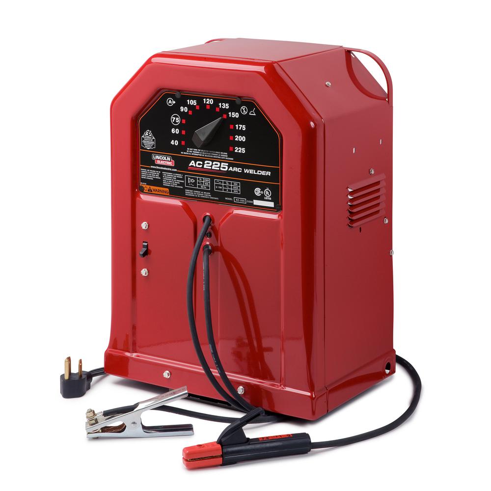

These have been around forever. They are cheap, easy to use and they work
i has one of these, till she gave up the ghost after 25 years of use. Replaced with a Miller Thunderbolt XL225. I absolutely love this machine. Does beautiful welds. If i was into it i can also do tig with it with some lead changes, etc (been reading up on how to do it). But i dont tig weld much. I have a friend thst has a fantastic tig machine if i need that kind of work.DAEDE388-3598-4A81-B4F2-B2C4D7F7F9C3.jpeg
/ Welder Question #13
Yes Sir! I have one of those I think I paid about $180 for a couple decades ago. I believe they go for ~$400 now. The predecessor (made back in 60's or 70's) was more rounded, is what I learned to weld on back in my youth on our farm. Dad was a pipe fitter/welder/Jack of many trades and taught me. I think those will be around a long time due to their affordability and capability.
