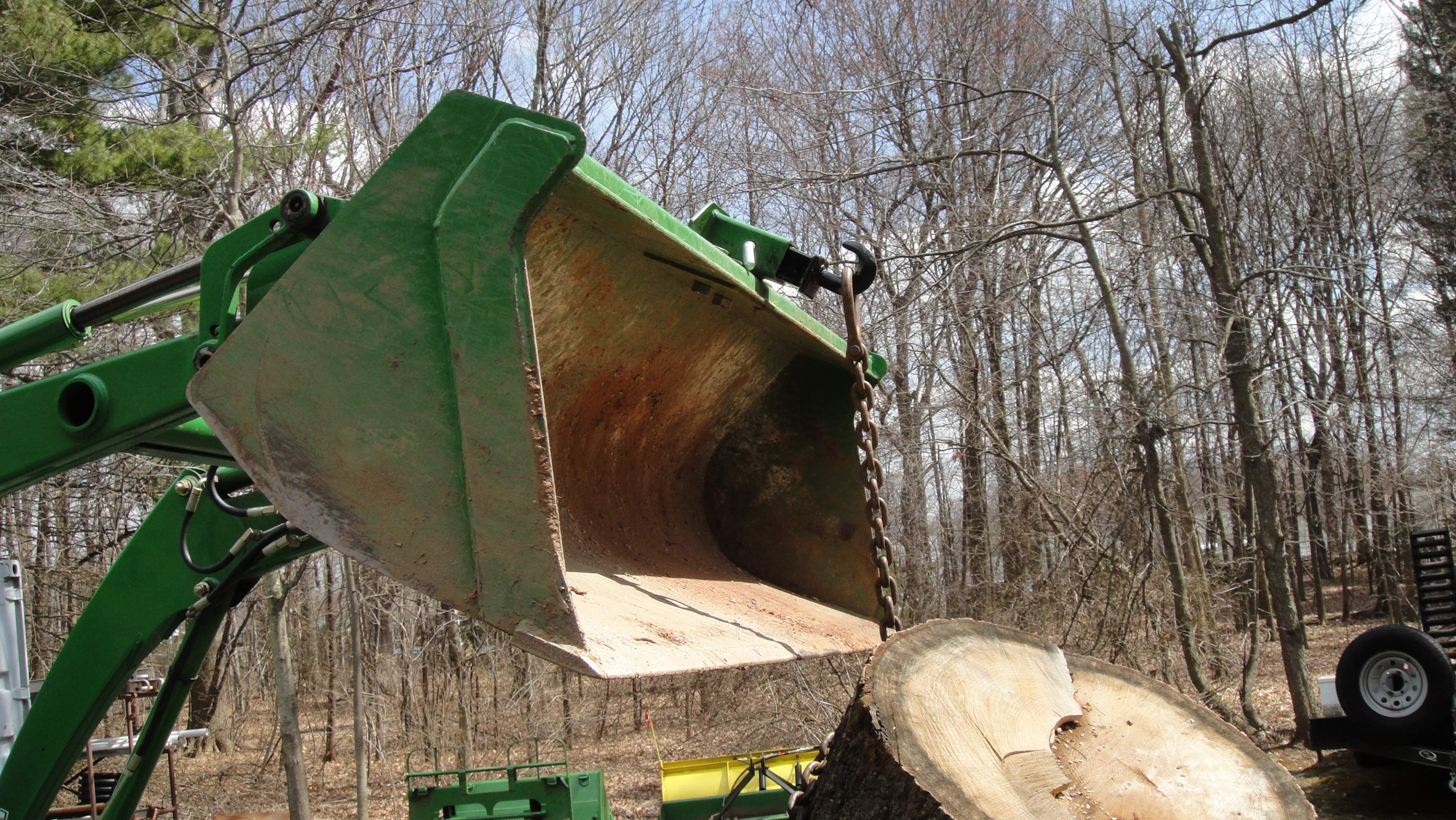

I don't know if the bucket wall is even 1/4, mine is double walled and I'm pretty sure the walls aren't 1/4. So I think you would need a heavier plate between or put it on a reinforced part of the bucket top.

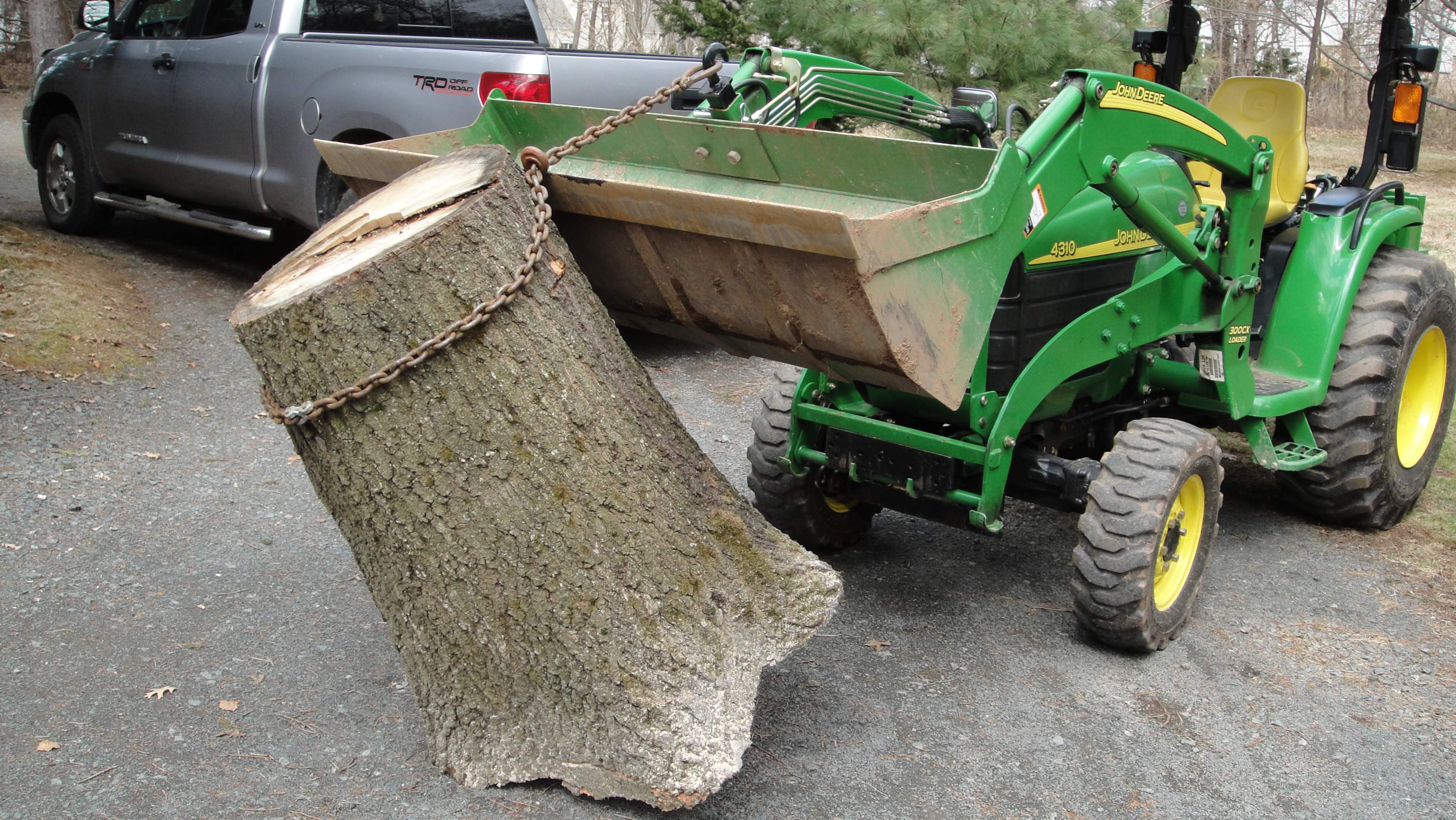

I had a pro weld my hooks to a 1/2 X 3" piece of steel the entire lenght of the bucket: then bolted that to the top of the bucket with bolts near each side of the 3 hooks and one at each end . Looks nice and strenghtens the bucket too; painted it cub yellow.Congrats. on the cub/yanmar purchase I think you will love it,I do my EX 450 :) I also put a 3/8 piece on the underside ;but large washers would probably work also.

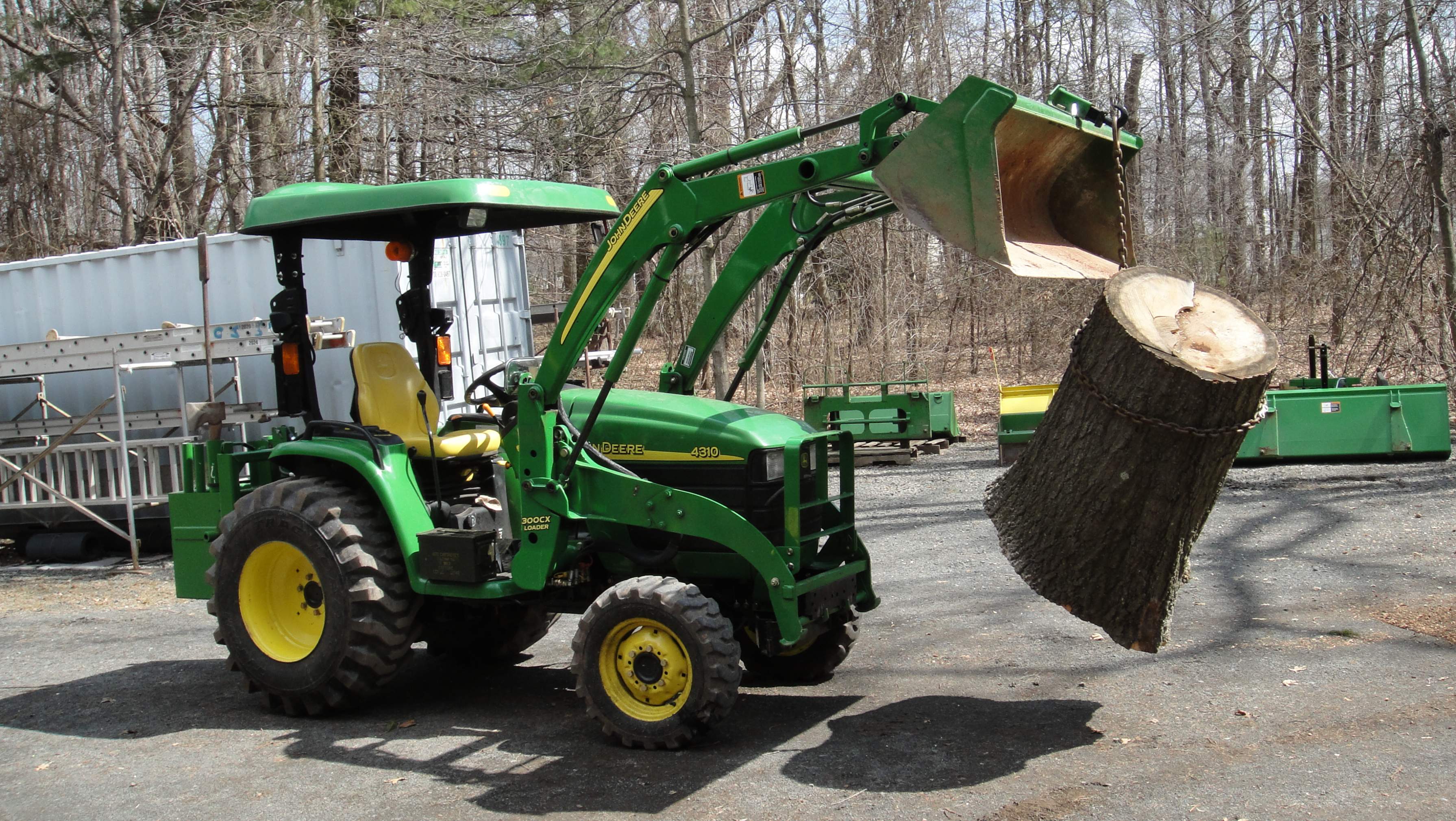

I don't know which would be better, I guess that would depend on your skills at either using a welder or if you have something that could drill metal. I chose to weld some hooks not on my bucket but on my bobtach part of my loader. The metal was thicker and with the bucket off I can lift more.
These are what I bought. They have a nice beveled edge along the bottom which makes the welding easier.

When I bought my CCY tractor, I asked for three 3/8" hooks to be welded onto the bucket - one in the center and one in front of each loader arm. The fellow who did the welding used a triangular piece of 1/2" steel on the inside of the bucket, directly below each hook. The piece of steel fits into the angle formed by the top wall and back wall of the bucket, and it acts as a support bracket for the hook. The welder's comment was that the brackets would lend more support than a flat piece of bar welded along the top of the bucket's lip. I thought it was a nifty alternative, and the brackets cannot be seen unless the bucket is curled and raised a couple feet, or you crouch down to peer up under the lip of the bucket.
/ Weld hooks or bolt them ? #20
He's right...adding any kind of bend increases stiffness.
