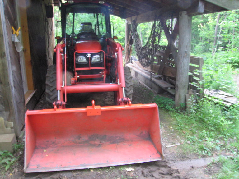

I have 4 hooks welded across my bucket top, and they are handy as a pocket on a shirt. Here is some of the "light duty" stuff I use it for...
The inboard pair are right in line with the FEL arms, and the outer pair on the bucket corners.

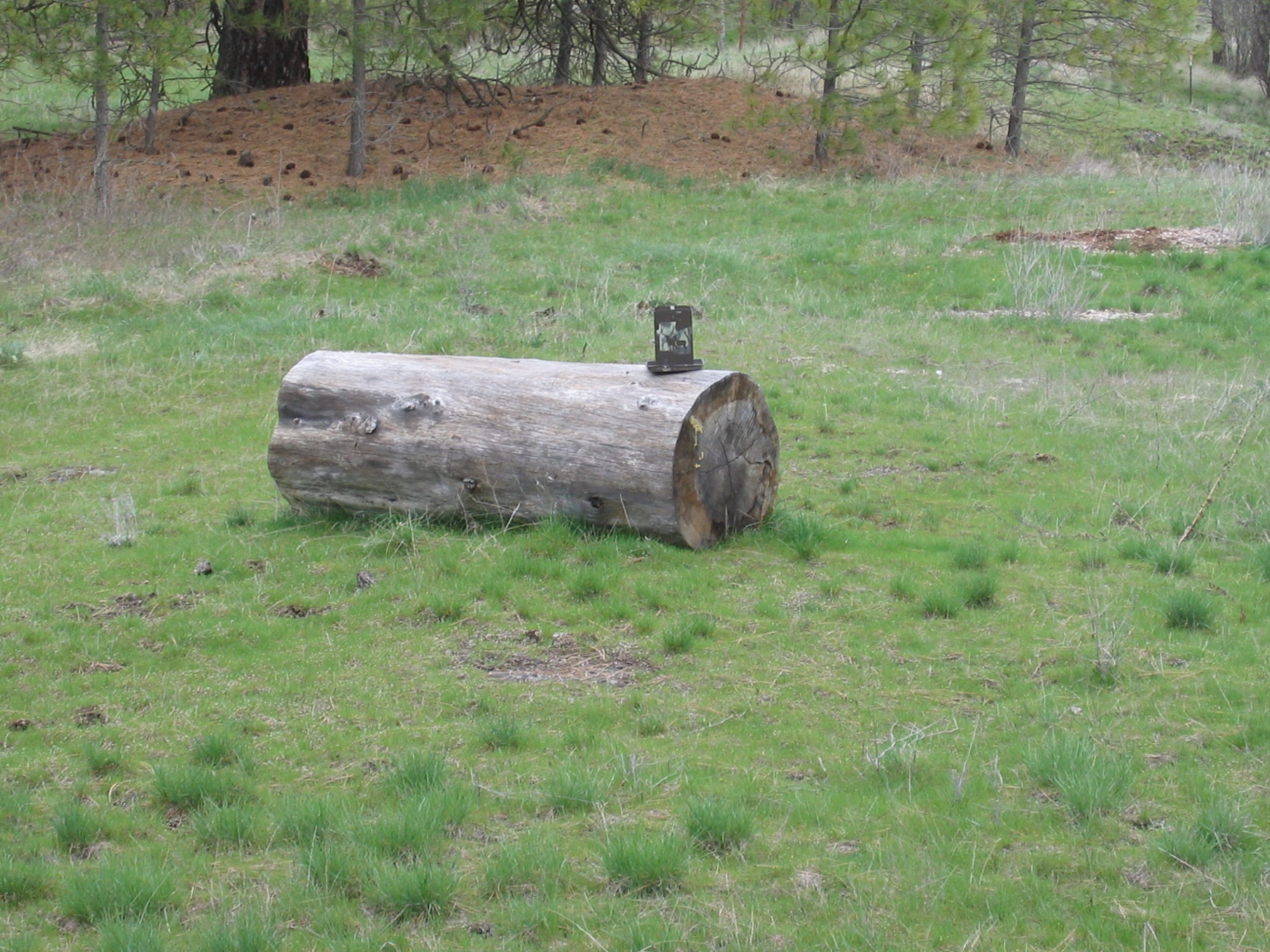

ponytug ........ Before I got my grapple. Ten foot chunks of pine tree trunk. Brush. Rail road ties.
This chunk - 8' x 34".
Which was cut off this 16' section.
And this is the stump. One of my ancient Ponderosa pines. 38" on the butt x 110 feet tall.
