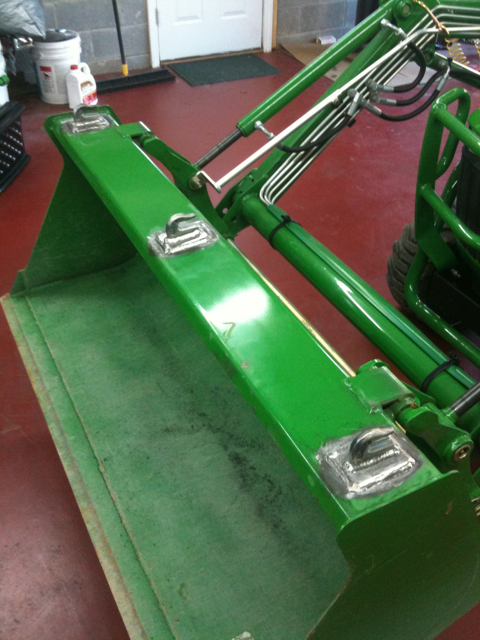

/ Welding Hooks to a front end loader #5
I wanted hooks on my bucket but was unsure of the bucket top thickness. I fist welded on a 2x2x3/16" piece of angle then welded the hooks to that

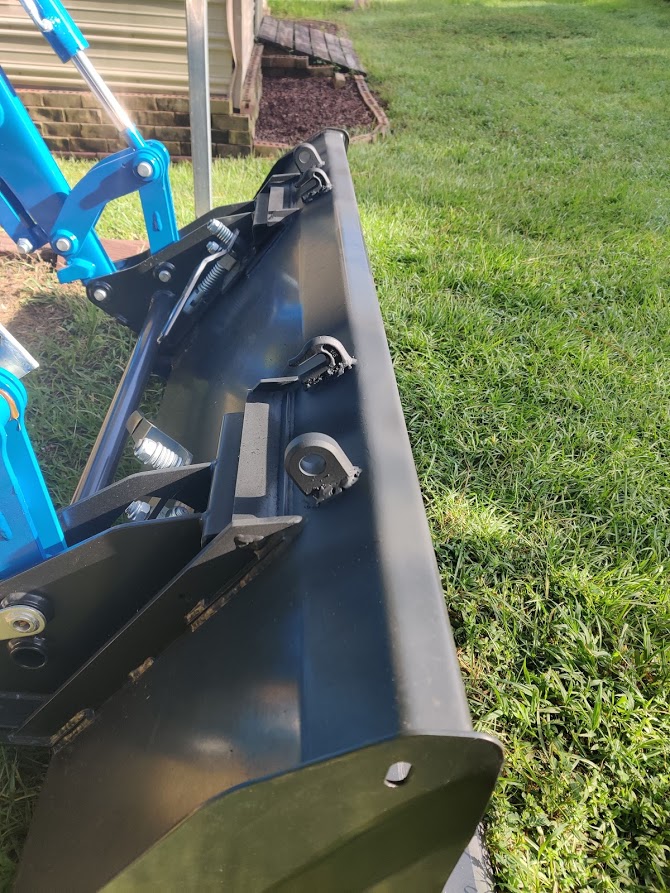

/ Welding Hooks to a front end loader #18
I used Ken's bolt on hooks on my Kioti. I felt the bases that are on the hooks would provide extra support.
The center of the factory Kioti bucket has angle welded on for extra support. I placed the clevis/plate mount inside the bucket. (Need longer bolts) The outside hook bolts go through a 3/4" pipe as a spacer to sandwich between top and inner bucket.
The bucket is definitely not built as heavy duty as the one on my old machine. I am just realistic in what I do with this bucket and hooks.
Note..I saw that Ken recommended to not paint the hooks..... after I painted the hooks. Don't paint them!

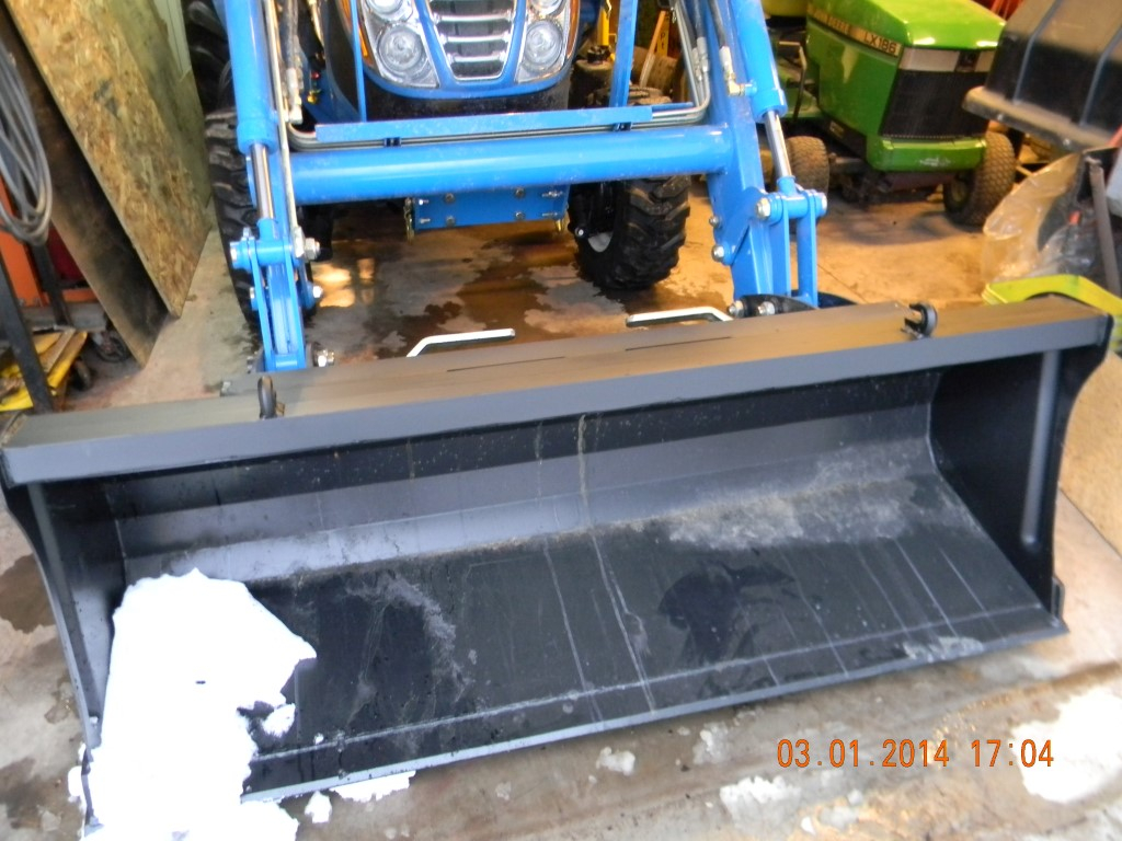

/ Welding Hooks to a front end loader #20
Here's what mine looks like. The hooks are inline with the loader arms. I do have pallet forks for big work, but for a quick "grab something" these hooks work great.
