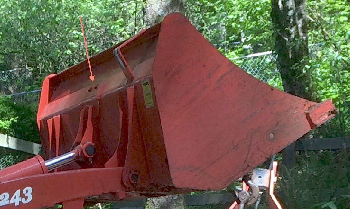

I'd like to weld a couple hooks so I can lift up trees using chains with my loader and make a pile. I'd like to do something that would look like the attached picture.
My question is, I have heard of people saying you need to first reinforce the bucket to keep it from bending, what do you guys think of that? I'm looking to lift mostly pine tree about 12 feet lenght.
Also my tractor is a Kioti Dk42se with a factory bucket.

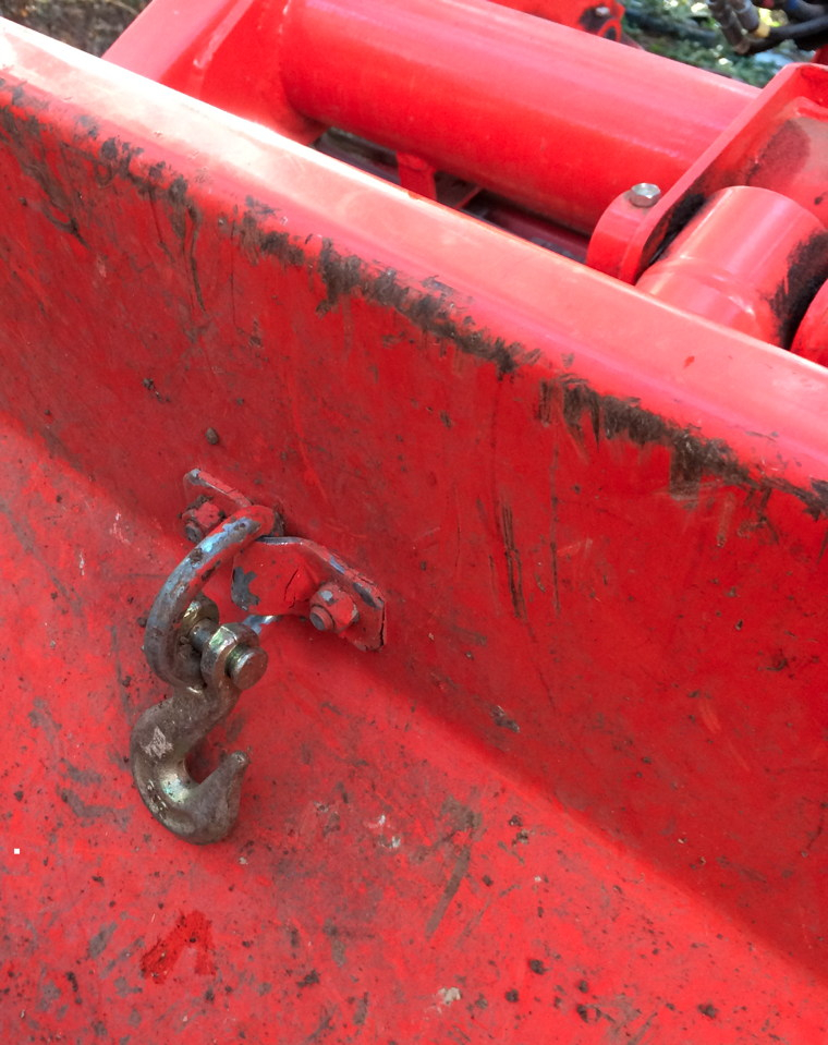

I considered welding hooks onto my bucket but arrived at (what I consider) a better solution for me.
Home - BoltOnHooks LLC They were well designed and you can't get much simpler than a bolt on installation. They came with the necessary reinforcement.
I have the same hooks on mine. They easily will secure a 5x5 round bale, without issues. My machine is rated for about half a ton of weight, and these are rated much higher. Follow their directions on placement, and you will be fine.

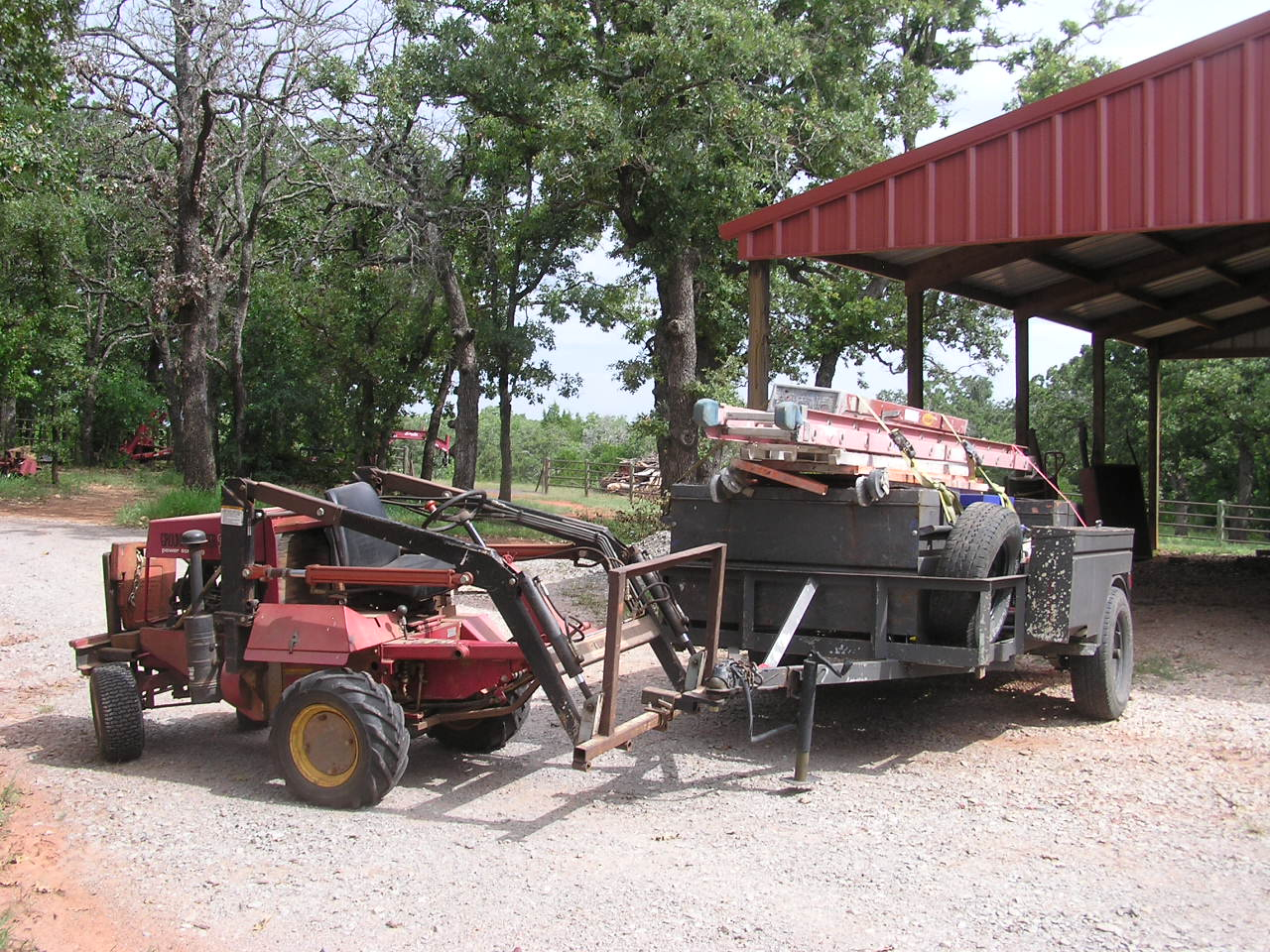

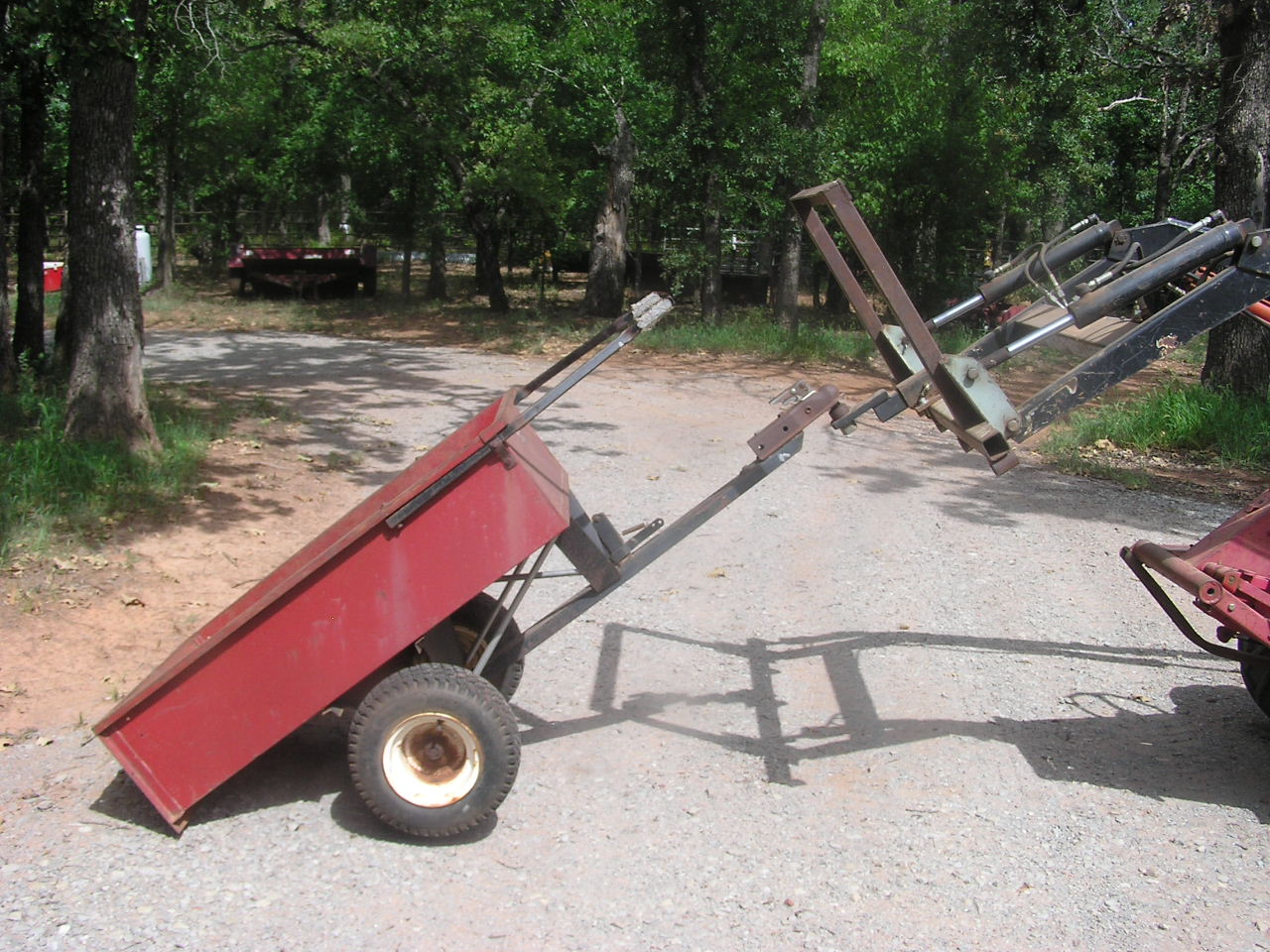

/ Welding Hooks to a front end loader #29

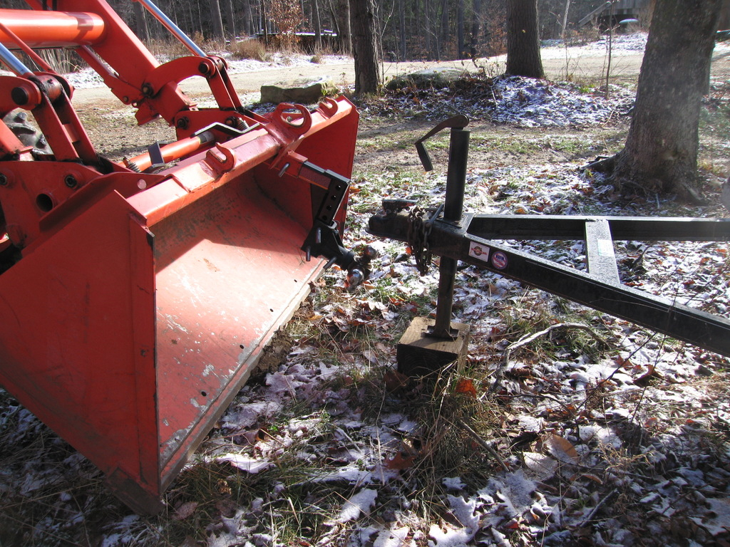

I did this: grab hooks in line with the loader arms and big slip hook in center all welded on reinforced areas and drop hitch mount.

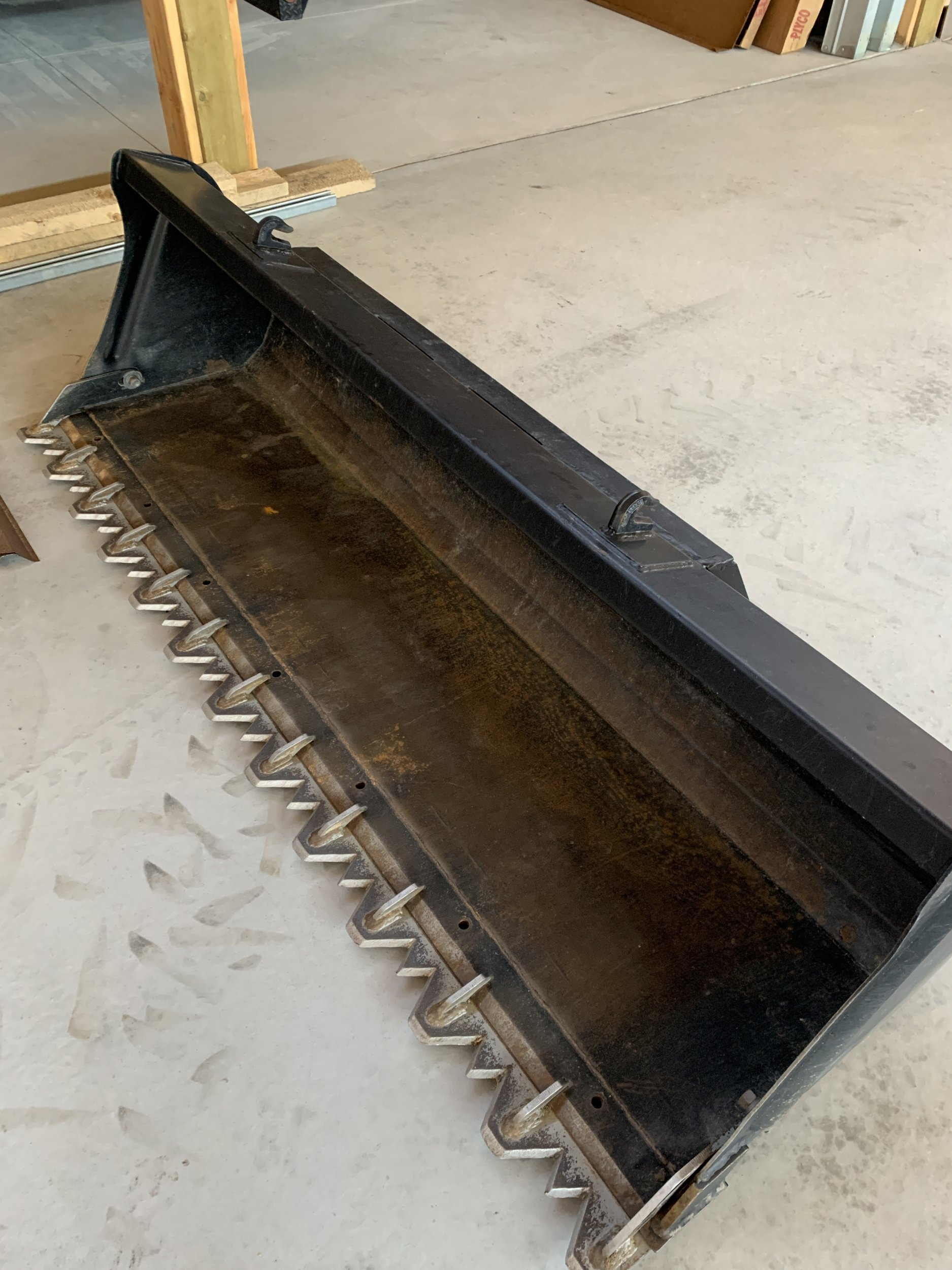

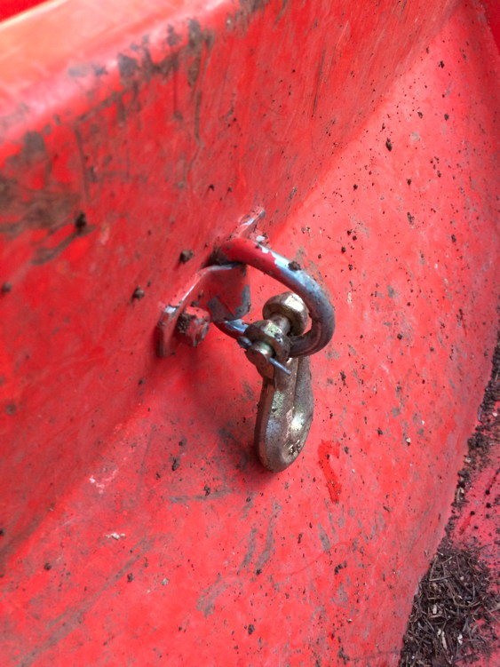

/ Welding Hooks to a front end loader #31
I saw a machinist advocating placing the eyes inside the bucket, so that if a chain breaks, the bucket offers some protection from flying chain pieces.
Any thoughts on the idea?
All the best,
Peter

I use Bolt On Hooks. I think there is a plate on the back of them. They are very strong and very nice. I thought about welding when I bought the tractor, but did not want to redo the paint on the bucket. These work great and look great.

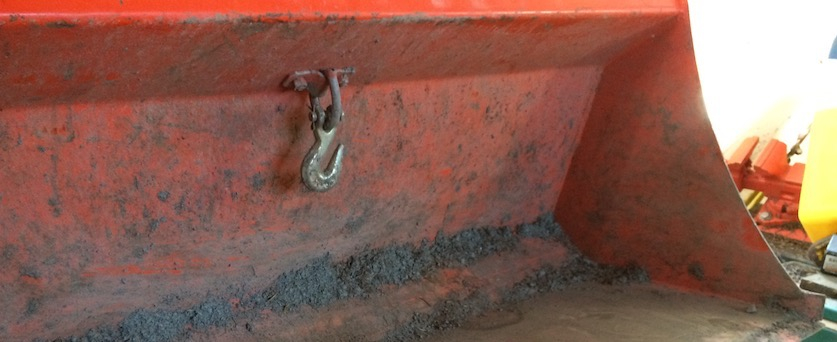

All the best,
Peter
The machinist is not the only one.
I used to watch a utube fabrication expert who went on-and-on about the inherent risk of hooks on the top of a bucket, for the same reason you state: objects flying back at you. He documented how a hook placed inside the bucket was a choice location. He installed in the center of the back, a very strong location. Weld-on or bolt-on with a plate behind are purchase options. The earlier photo of the yellow Payloader bucket is a good example of inside-the-bucket protection.
As for lifting power, on one of my buckets, I welded a hook on the rear of the bucket next to, but outside of, the connecting pins so a chain could be hung down from the hook. Its more lifting force.
Oh, and I always paint mine, using the matching OEM color. It looks so much better and is durable. There once was a time I did not paint, but realized that I do like a more professional, finished look.

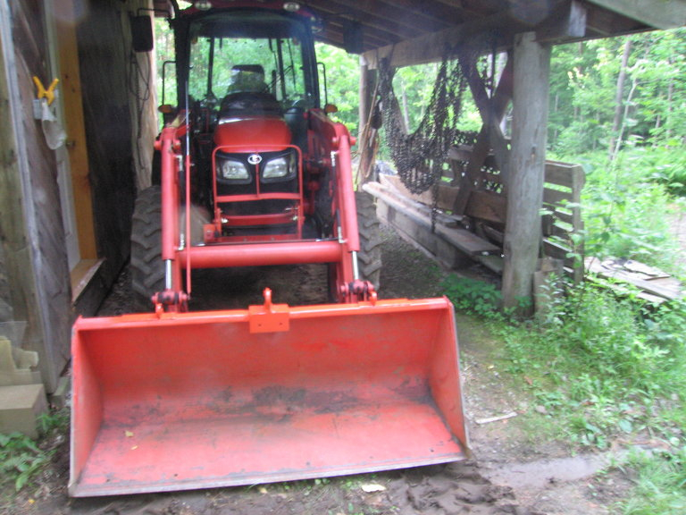

I don’t have a center hook. I hook to each side and drape the chain down the center of the bucket when I want to lift. This distributes the weight in line to both lift arms, not in the bucket center (weakest part).

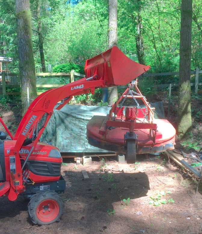

Center only on my BX. That's where the cylinder reinforcement is located.
buckethookD.JPG buckethookB.jpg buckethookA.jpg buckethookC.jpg BXcraneMower-s.jpg
Bruce
