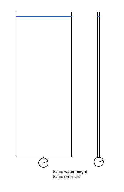

If you have a vertical pipe that's 100' tall and filled with water, the pressure at the bottom is about 43.3 PSI. To make water overflow out of the top, you can apply 44PSI at the bottom.
I see what the OP is saying and it doesn't quite relate to the above. He is lifting the volume of water in the space between the large and small pipes on the upstroke. With more the space between the two pipes, he's lifting more water. His physical effort is 43.3 pounds times the area of the water space.
Think of it this way. There are two vertical cylindrical tanks, both 10 feet tall. One is 6" in diameter and the other is 24" in diameter. Both have around 4.3 PSI at the bottom with 10' of head. Pushing water into a pipe fitting at the bottom of either tank at a pressure of more than the 4.3 PSI will make either one overflow.
Now, lift each one off the ground.

Agree with what bcp first said: weight of water, diameter of pipe, length of pipe, does not matter. Only matters how high you are trying to lift the water.
There will be piping losses requiring more pressure the faster you try to push the water.
