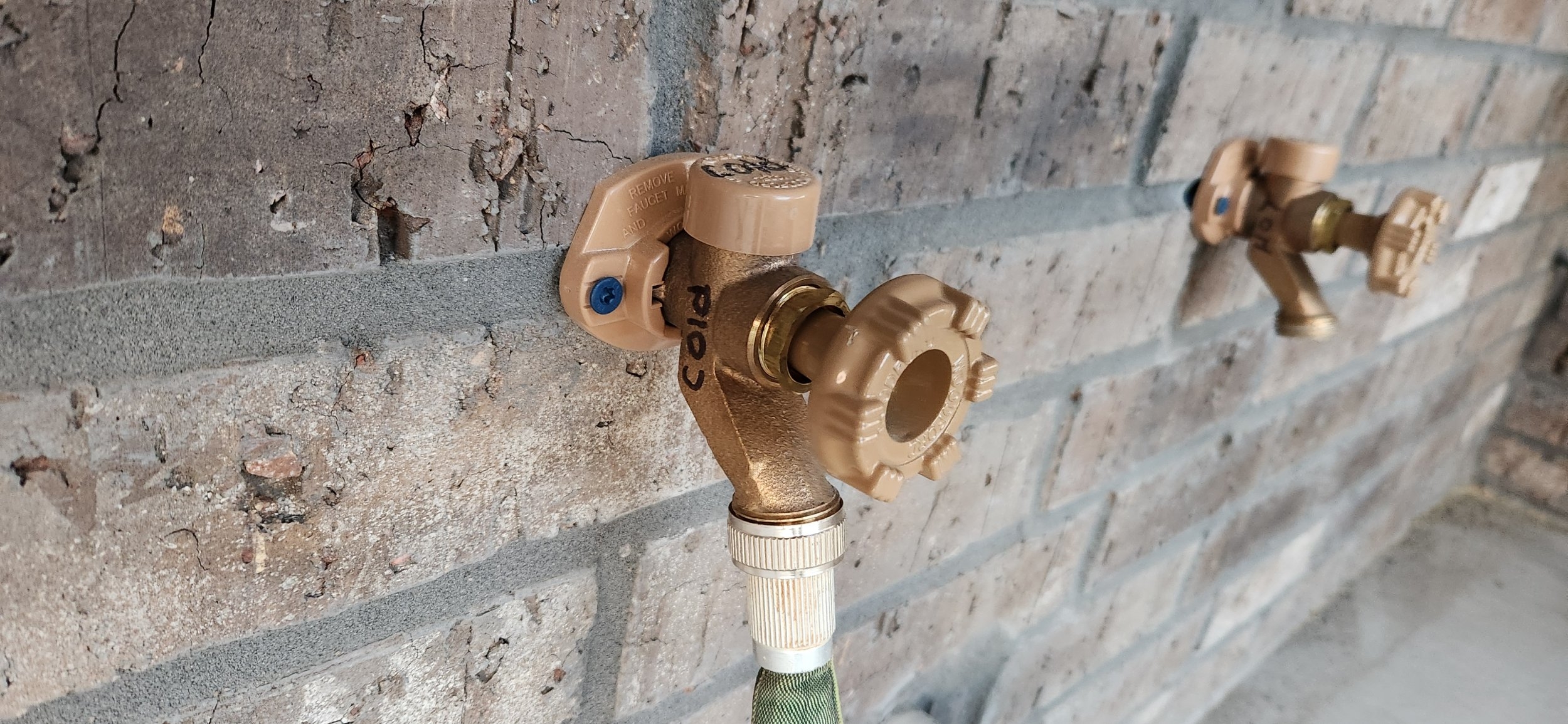

Can you take a pic of your outside hose bibs. Cause I agree, there are some cheapie ones that just suck too

Do you know if this has a water saver in it?
/ Water pressure/ flow question #14
When I built my house, code said anti-siphon on all hose bibs.
Talk about flow restricting. As soon as we got COO, those were removed.
Those bibs you have there may have something of an anti siphon valve built into them?

I'll get a pressure guage and take the regulator up from the road side in the next couple of weekends.
Nice catch @34Willys!
As @34Willys caught, the knob at the top houses an antisiphon valve, which may, or may not affect flow, but I prefer to have the antisiphon valves on the garden hose side, as not everything needs it in my view, and it is much cheaper/easier to replace when needed.

I think those outdoor drain back/not freeze style bib valves would have to anti syphon, or they wouldn't be able to drain back through the wall as designed?

Those are frost free, anti siphon silcocks. I don't believe they have an intentional flow restrictor in them. Why are there two side by side?
/ Water pressure/ flow question #18
Hot and Cold??? maybe for RV?
#19
Yes hot and cold. It was the closest one I could get a quick pic of. I had them add hot, cold and a drain on the back porch. I plan on putting a sink out there to use when I'm grilling. I'll hook it up in the summer and unhook it in the winter.
