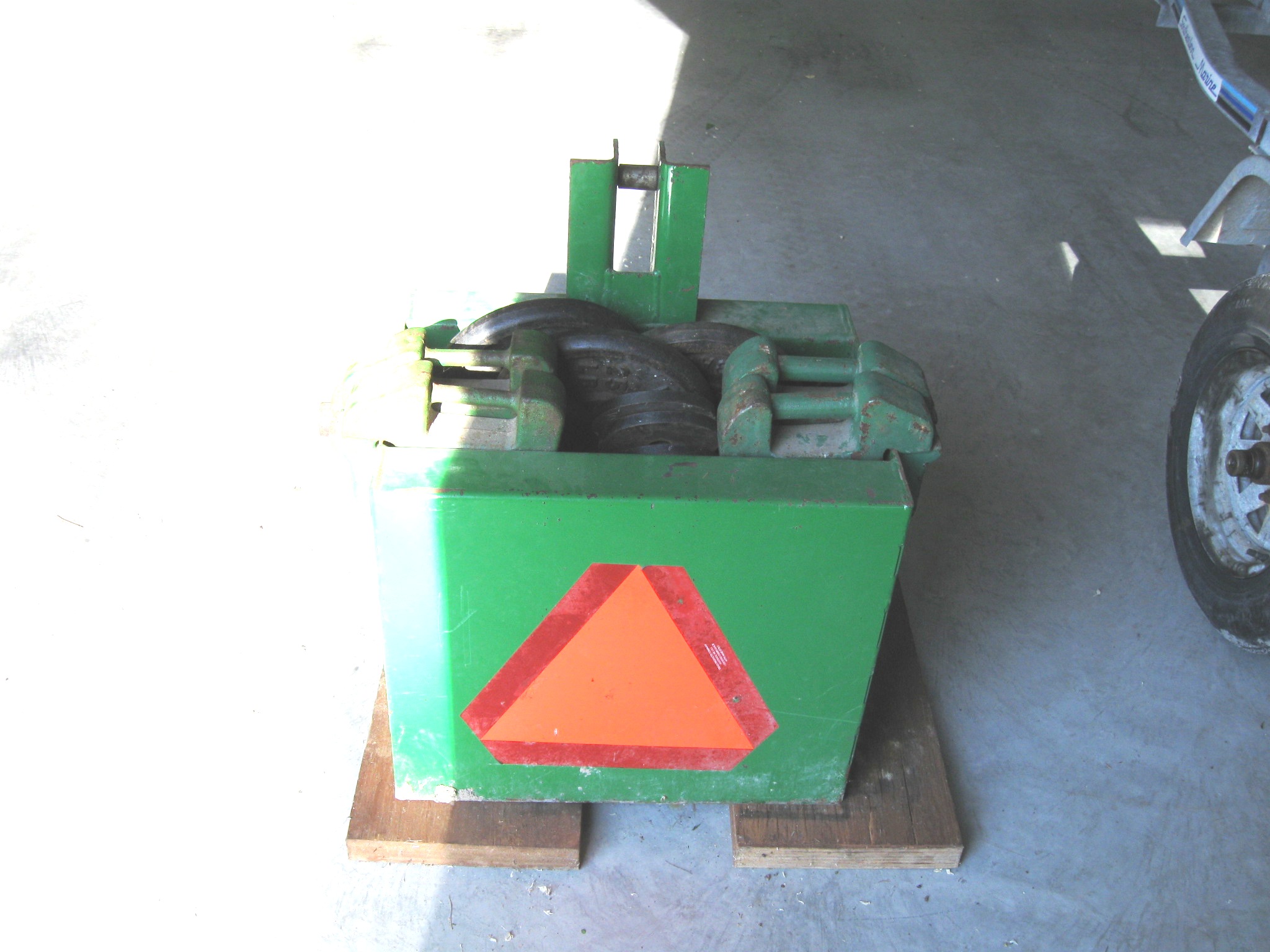

I filled my ballast box with lead weight lifting weights (metal only).
This way I can add or remove as necessary. Currently keep about 1000 lbs in weight including the weight box itself.
/ Weight box when??? #8
Picture should have been posted as well; please excuse
/ Weight box when??? #9
^^^^those aren't lead BTW.
