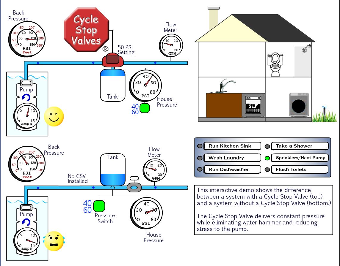

Hmmm, are the pumps variable? I was under the impression that it was either on or off. I guess some are variable, just not sure of whether mine is or not.
/ water well drilling info #25
The cycle stop valve sets the max pressure, the pump motor turns fast enough to supply the flow required: Cycle Stop Valves, Inc.

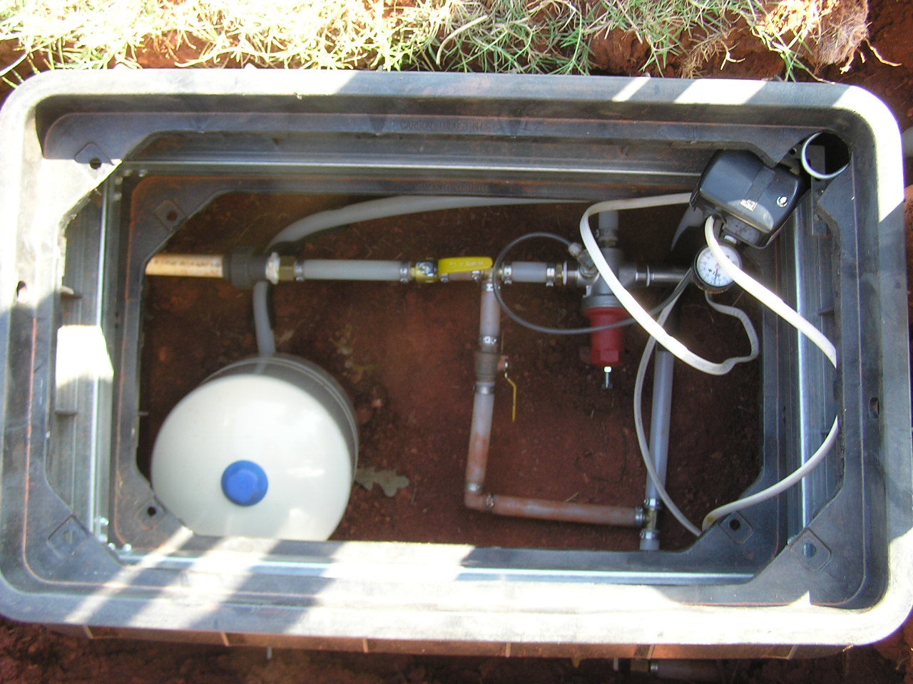

About 7 or 8 yrs. ago a family I built a house for installed the on demand pump in this link and it certainly impressed me how well it worked. He recently sold the home and saw it was working as good as ever. Watered a few acres and the house hole use. This is my only experience with this system.
Goulds Constant Pressure Systems
I install lawn sprinklers , I do a lot of well systems . When the customer has the constant pressure system , they work great . The customer can even shower while the irrigation is on with no pressure loss . Its the way to go

Realize that a Cycle Stop valve is nothing more than a regulator. This means the pressure before the regulator will be very high. Although there will be fewer starts, I'm not certain I'd like my pump laboring to produce a pressure that is beyond it's design spec. At that point either the amps will be off the chart or the pump will be cavitating. Cavitation will wear an impeller just as fast as pumping sand. Personally, I'd go for a larger pressure tank before I went with a Cycle Stop valve. Also, check your bladder tank as it may have developed a leak. Frequent starts and dry runs are a symptom of the tank pressure being off. The correct pressure is 2psi higher than your pumps cut in pressure. If you see any moisture come out of the schraeder valve, then the bladder has failed and the tank needs to be replaced.

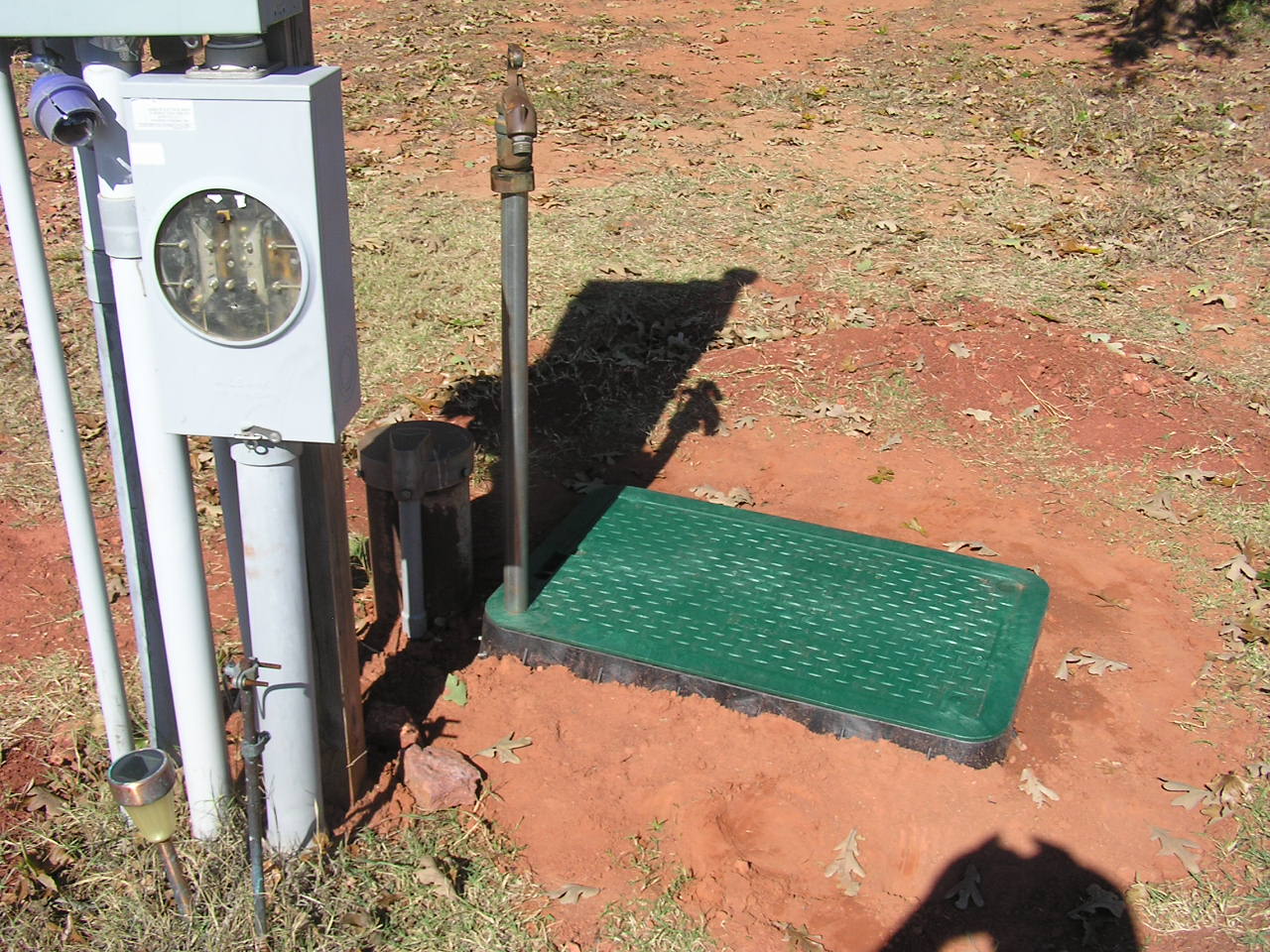

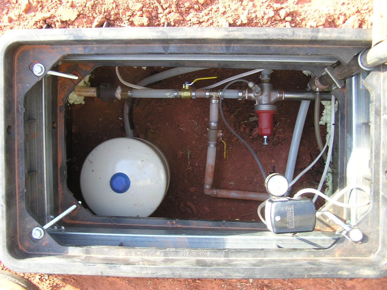

This is not true, the amps will be lower than if you remove the CSV and let the pump run at full flow. It is true the pump will have the maximum pressure that it is designed for but I never heard of it cavitating. The pump here was installed ten years ago and is still running good.
Mine draws 8.3 amps with the CSV set at 50 pounds and the hydrant wide open, and a lot less at 1 gpm. The electricity consumed is directly proportional to the water flow in gallons per minute.
The CSV and pressure tank are underground, no heated well house to worry about freezing when the power goes off during an ice storm.
