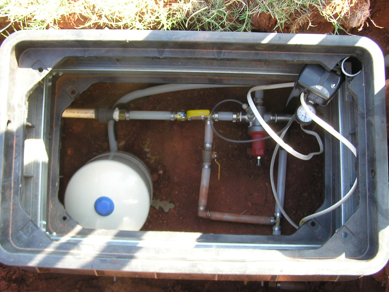

Yes, you will want a pressure tank. And not a undersized one shown in the picture above. Frankly, you really can't go too big on the tank. The bigger the tank the longer the pump run time and the fewer the starts. Starts is what kills the pumps, they can run all day without damage (so long as they stay submerged). Also be sure to have the correct sized pitless, drop pipe and lateral pipe installed. I have 1" on my pump at the friction loss at 17gpm is off the charts. If you want to hit 17gpm, go no less than 1.25". 1.5" would be even better and required if you are over 17gpm.
This depth is really beyond your ability to set the pump. It will get very heavy and only gets worse the deeper you go. The problem is that many pump setters make money off their pumps so they don't like it when you give them the pump to install. I've used Tuhorse pumps off Ebay with very good results in the past.

Yes, you will want a pressure tank. And not a undersized one shown in the picture above. Frankly, you really can't go too big on the tank. The bigger the tank the longer the pump run time and the fewer the starts. Starts is what kills the pumps, they can run all day without damage (so long as they stay submerged). ------------------
I guess you have never had a Cycle Stop Valve. Our pump is over ten years old. If you are running a lot of water, like three sprinklers on new sod for two hours, the pump only starts one time. :thumbsup:
