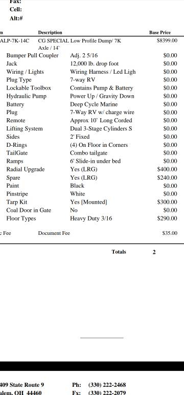

Just talked to the fellow and already got the quote. Missing on the quote is the de-rate the 15,000 gross build to 9,995 and also missing is the rear drop legs for loading equipment. There is also a 3% cash discount, so assume around $300 off for cash. View attachment 696440View attachment 696438View attachment 696439
I never payed attention to the literature of them when I was shopping for a dump.....but I gotta wonder what the point of 3-stage cylinders are on a dual ram setup where everyone else just uses single stage cylinders?
HAve you given suretrac a look. Im happy with mine. But that seems pretty pricy for an "appalachian".
I know upgrades cost $$$. But my 7x12 12k was $6400OTD about 3-4 years ago. I know they make a 7x14 16k with scissor lift. Not sure what they cost though

Okay... this is the Appalachian Special. It's $1,100 more than the top line contactor model.
This Appalachian Special gets 3" drop axles, 3 stage 3" cylinders that are front mounted and yet give greater than 45° dump angle.
The standard Appalachian gets the mid mounted cylinders that reach back towards the pivot point. This is a front mounted that reaches about 1/4 way back from the front. That gives this massive mechanical advantage over the standard setup.
