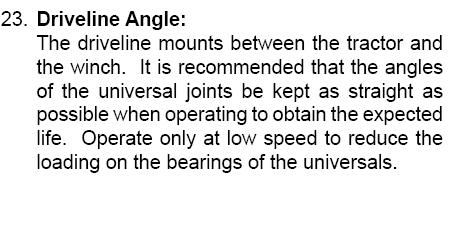

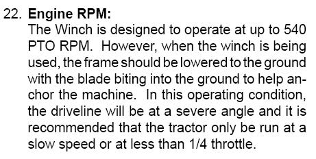

I just bought a new FX65 Wallenstein skidding winch.
I'm waiting for the weather to clear to head to the woods and give it a try ( been raining all weekend here)
My question is...do I need to run the tractor motor at full throttle to have pto 540 rpm, or can I operate the winch at lower motor rpm, and if so, can I still pull the same load ?
Thanks for any advice !

No, don't run it at 540rpm. When winch blade is lowered, the PTO shaft is at a steep angle. I usually run tractor rpm at 1200 (where 2200 rpm engine = 540rpm PTO), or about 300rpm (PTO). For "heavy" loads I'll "crank engine up to 1500 rpm (or about 368 rpm). I keep the universals regularly greased.
The max load is determined by the friction clutch on the winch. Trying to remember my physics (how max torque relates to power and speed), but i think that at a slower speed the clutch would actually "hold" a heavier load moving at a slow speed than at faster speed? (However its most likely to slip when your cable speed = 0 (i.e. the log is hung up on a stump or rock, etc.)).
I run the FX65 on a 64+hp (rpm) tractor and hardly ever hear the tractor "load", even when the winch's clutch is slipping.
From the operators manual:

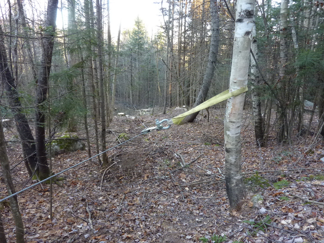

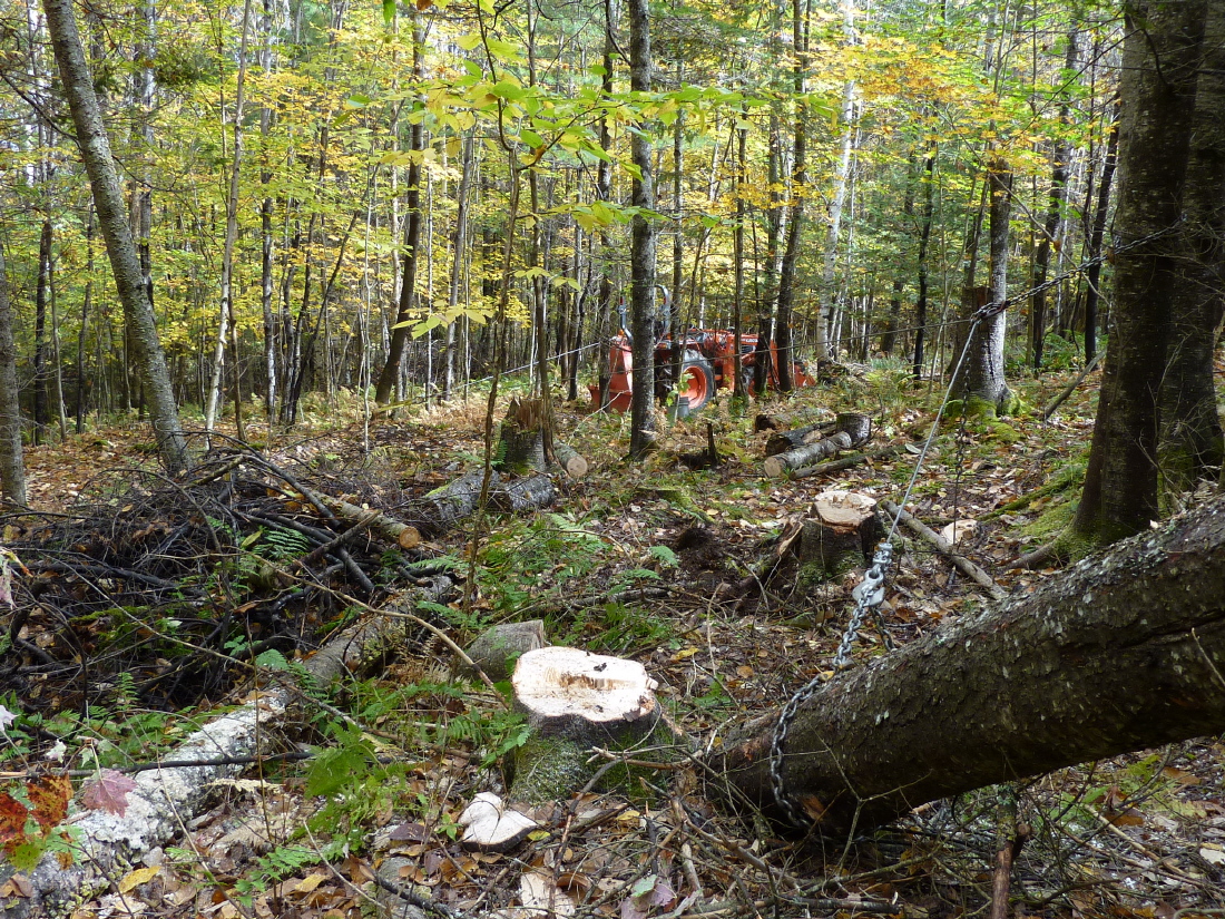

You may find having a snatch block or two will help a lot especially if you have rough, steep, or swampy terrain where you can't just drive anywhere you want. They enable you to keep the cable straight back from the tractor and then change the direction of pull with the snatch block. They help to get around good trees you want to save and not damage by rubbing the bark off. Here are a couple examples. The first two are a winch line I set up down a stteep hill over a ledgey place. The third I have my tractor in a skid road with a snatch block on an ash right behind it. Then I hung the cable high on a tree with a second block (a slider actually) so I could pull that tree that is hung up and behind the stump up and over the stump and then skid it down to the road.

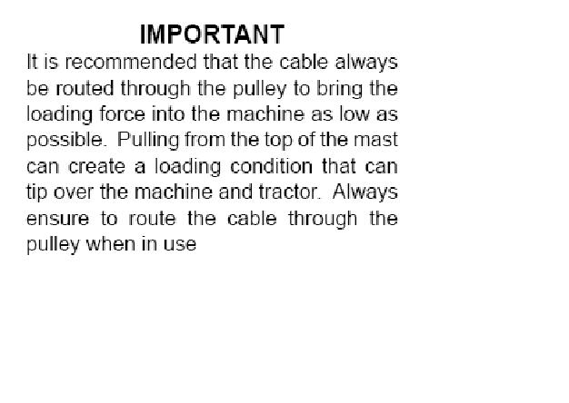

If there's smoke coming off the clutch when you pull, though, you'll need to take the pull more seriously, with safety considerations: more revs will mean more strain on the tractor, so be sure the brakes are set and that you are standing at the end of the rope, because the winch has the torque to spin the tractor around, tow it backwards, or, as my neighbour warned me, break it in half if you have chained the front axle to a tree.
Also: Watch out you don't tip the tractor over if pulling from an angle. Especially if you're not running the cable through the lower pulley on the blade of the winch and pulling directly from the upper pulley like a Farmi does. If pulling at an angle from a point above the tractor's center of gravity, watch the tractor's tire to make sure they stay on the ground. :rolleyes:
Yes, you should always use the lower pulley as it takes the stress off the upper 3pt link, but I sometimes cheat because it helps to pull the end of the log over stumps, or from the log butts dragging 4 wheelbarrows worth of brush and sticks that get all bound up in the choker chains.

I respecfully disagree with your statement that the lower pully should be used while winching. The only way to get down pressure on the winch blade is by using the upper pully. Downward pressure is necessary to propery anchor the winch. With the blade anchored properly the pulling force is on the winch itself and the ground it is buried in with very little force transferred to the lift arms and top link. If you winch from the lower pully there is very little downward force to bury the blade so the tractor has to hold the winch back thru the lift arms and top link. That is hard on the tractor and it is more likely to move.
Many people do not believe this but it is true. If the cable is not angling down there is no downward force on the winch to anchor it. It is that simple.
Reading this may be interesting. It is not Farmi hype it is basic physics. Note the highlighted bold text.
/ Wallenstein winch operation #11
I was quoting the manual (i think). I hear what you're saying, but as long as the 3 pth arms attach below the lower pulley there's a downward force. I know that when it's running off the top pulley I can watch the draft control sensor on the top link flex, but I don't worry about it stressing the top link, then again I don't worry the blade not digging in when it's on the bottom pulley. It's all good.

I'm not crazy, I did read it in the manual:
....although I don't follow their guidlelines. What do they know!:D
/ Wallenstein winch operation #15
I can see what you mean and why you would thing as you did. That is very unclear. But I believe that they are referring to when you are skidding the logs out to the landing and not to the act of winching. The key being they state you are less likely to tip over (backwards if the load catches or up hill, or sideways during a turn) when using the bottom pully. That only makes sense skidding. It would be almost impossible to tip the tractor over with a straight winch pull off the top pully unless the tractor is way to light for the winch. You could winch it over with a side pull however, which is a big no-no, and also twist up your lift arms and top link. Tip over is a definately a higher risk when skidding from the top pully especially if the load is to heavy for the machine set up.
If you read your manual the way I suggested about it agrees exactly to what the Farmi manual says about pully usage.
