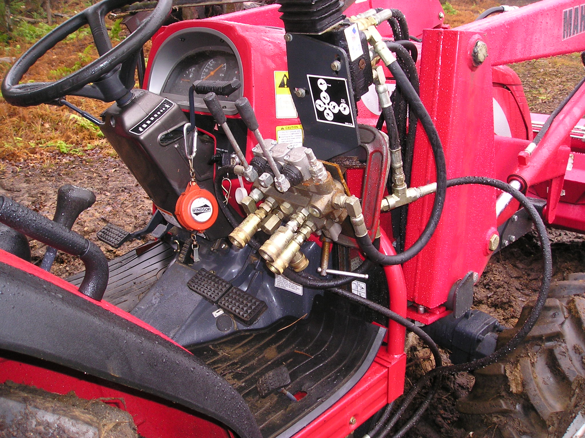

Here are a couple photos of the RBG2-60 just after the install was compledted.

Nice photos. I would be interested in what it looks like with the loader arms completely retracted. With the bottom of the grapple parallel to the ground.

wedge...the last photo you kind of get an idea what it is like, I won't be back to my tractor until New Years so I can get better photos then.
It is not designed to scoop under debris and lift without grasping the objects. I don't think the float option on the loader would work with this grapple because the teeth would dig in. I haven't used it hardly at all other than to get a large stone out of the way and dug a couple of old Christmas trees out to test it.
