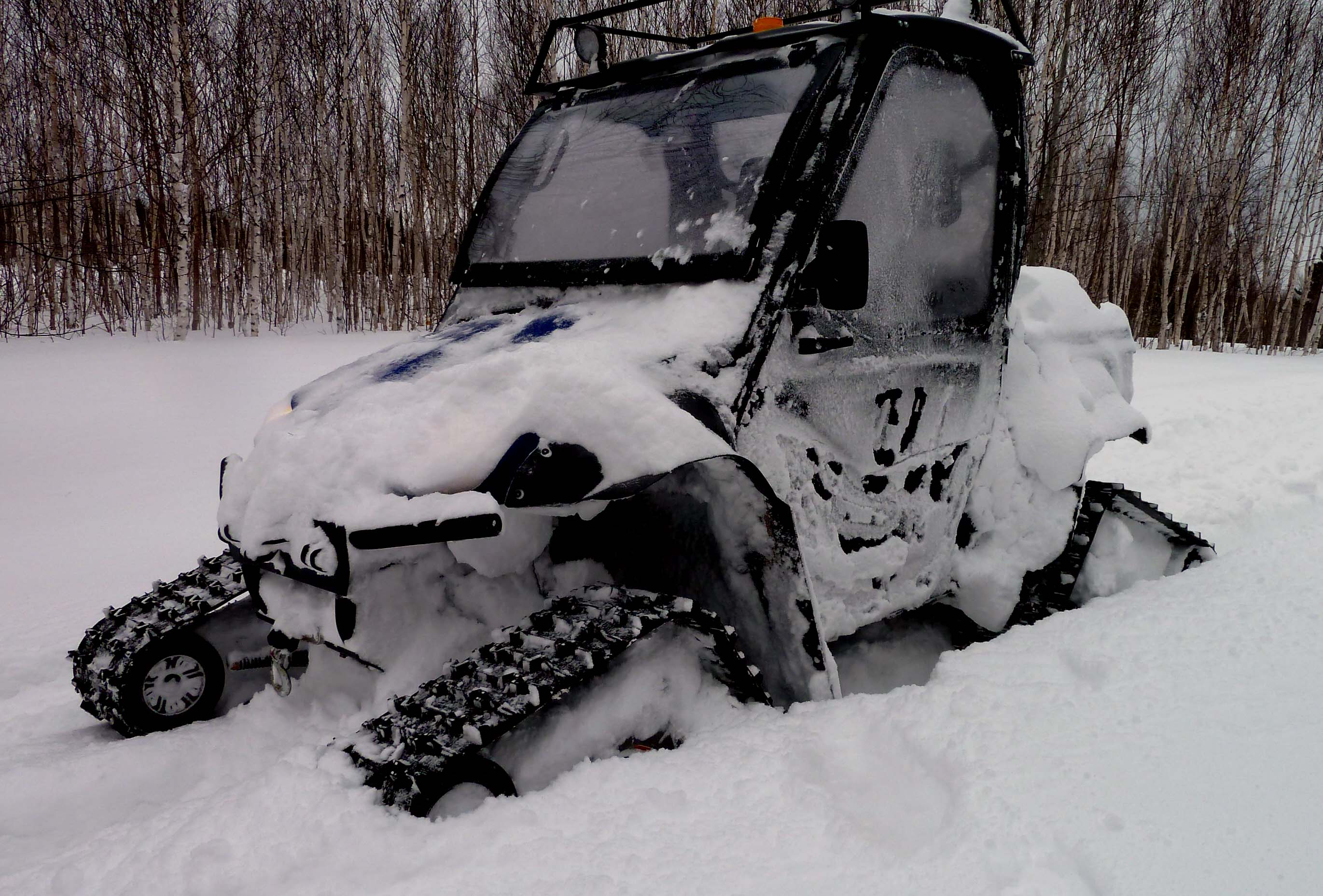

Right now the only 3 with a factory cab I can find in this range are Polaris Ranger 1000 Northstar, Deere 835M, and Kubota X1100C (and diesel offers from Deere/Polaris which I wont entertain). I am leaning towards gas with EFI. Right now the Polaris Northstar is 80+ HP and the Deere is 54. That is a pretty huge difference. For plowing at altitude I might want all I can get.
I have a 12 year old Gator 620i, still on the original drive belt. For several years I did a lot plowing with a V-plow (electric over hydraulic lift, manual angle). This machine is only about 25 hp, so it is way under powered when travelling on a road, but in low range that doesn't make much difference when plowing. The biggest issue with the this machine is the lack of power steering. For plowing it is all about weight and traction. Chains (v-bar preferred) and several hundred pounds of ballast in the bed will make a big difference. So for plowing, I'm not seeing the need for the absolute highest horse power. Nothing wrong with Deere but my next UTV will probably be a Sidekick or a Ranger.

Its always nice to have people with actual experience posting. I'll agree with FatT. If you are running rubber tires to push snow, all that extra HP will only be good for spinning the tires. We operate pods and in snow, which takes lots and lots and lots of HP to spin.
