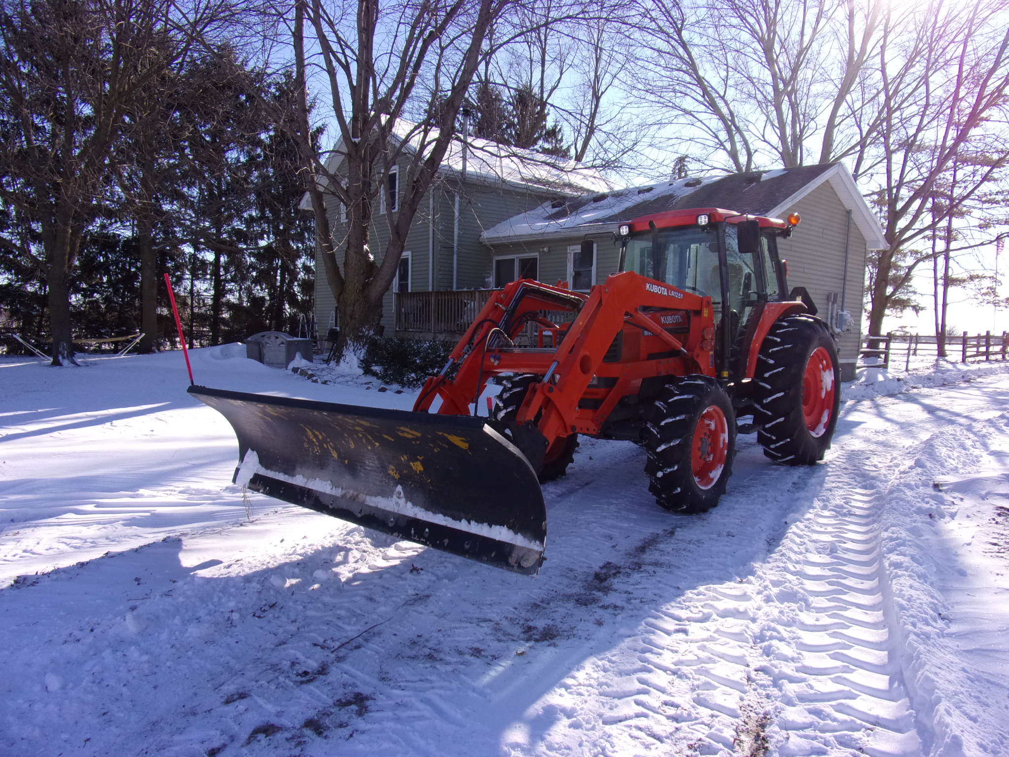

Its always nice to have people with actual experience posting. I'll agree with FatT. If you are running rubber tires to push snow, all that extra HP will only be good for spinning the tires. We operate pods and in snow, which takes lots and lots and lots of HP to spin.

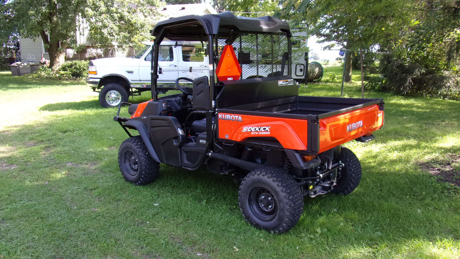

I don't need a plow on it at all, have this...
and you are correct the door kit is absurdly expensive, didn't get that either. Front folding windshield, turn signals, horn and mirrors. Added my own SMV triangle plus the roof. Comes with half doors that I wasn't sure about until we took it down a muddy road. Half doors keep the mud out and your pants clean.
Don't need a heater, the rad is in the front so you get warm feet.
Added a 5000 pound winch myself. What a job that was. Mounting the winch was easy. Routing the cables back to the battery was not. Basically had to take it apart to get the cables to the rear.

The Sidekick don't have a hydraulic dump option, it's actually a linear actuator that powers off 12 volts. Kubota wants an additional 800 bucks for it. Don't see the need, the bed pivots over center so even loaded it's a one hand dump and all the bracketry is already in place for the actuator so one could buy an actuator from say Surplus center and fab up their own for hundreds less. Like the winch. Kubota wanted 600 for the winch. I bought a 5000 pound Badland ATV winch from HF on sale for 139 bucks and spent an additional 100 bucks for welding cable and copper lugs and did it myself. Some accessories (Kubota) are fine but some are way overpriced. The Kubota winch is actually a Superwinch with Kubota's name on it.
All in all, it's a nice vehicle. Wife and I are very happy with it. I've yet to put it in 4 wheel drive. 2 wheel does just fine.
